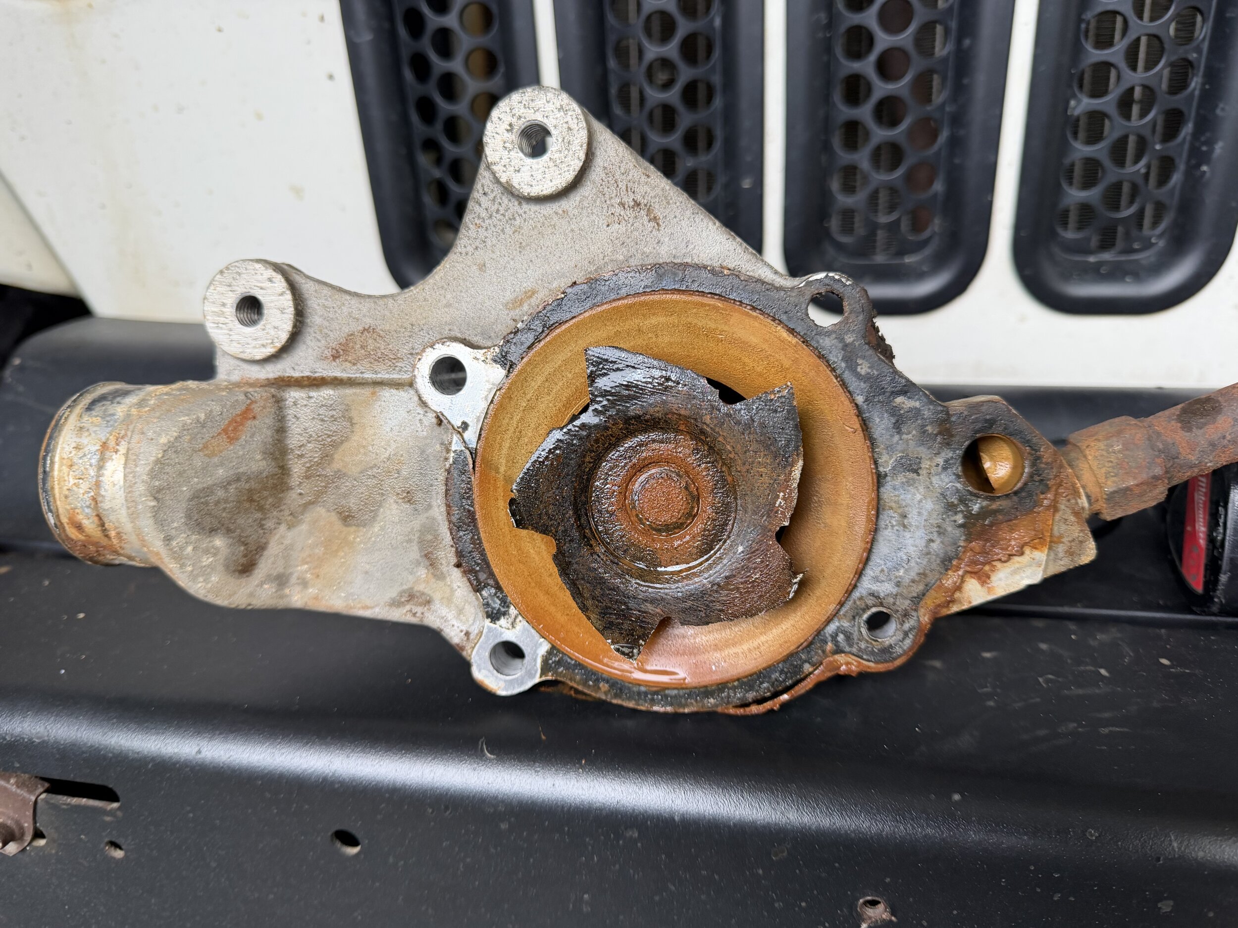

Even though the water pump was replaced recently I’m taking it apart to check and see if it’s clogged or something. Will update.

I know you replaced your water pump recently, but it really sounds like the water pump. I recently changed mine and the replacement had a damaged plastic impeller that failed shortly after installation. I finally ruled everything else out and took the water pump off and voila... plastic pieces everywhere. I was fortunate to be able to fish all the impeller parts out of the engine block.

This is 6 months old… I bought a dura last one only one readily available. The little fins are shaved in some type of way.
