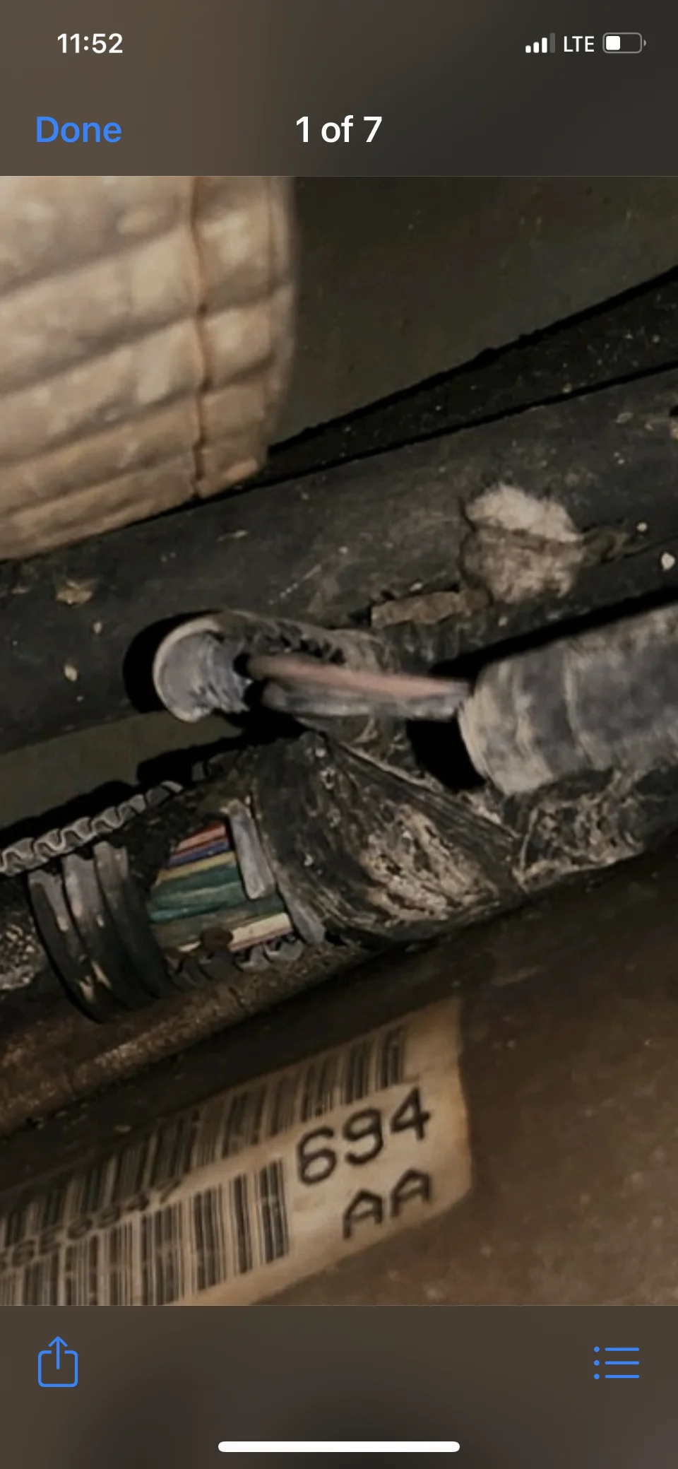

Might make sure the lines aren’t blocked -
You need to go ahead and go down to the driver side of the transmission and really check the connectors and wiring before you get too deep into it-
At this age it is common for these to have a fried loom and wire/heat damage seems to be discussed more and more.
I will double check tomorrow.

This guy had the exact same issue today - he is good now.
