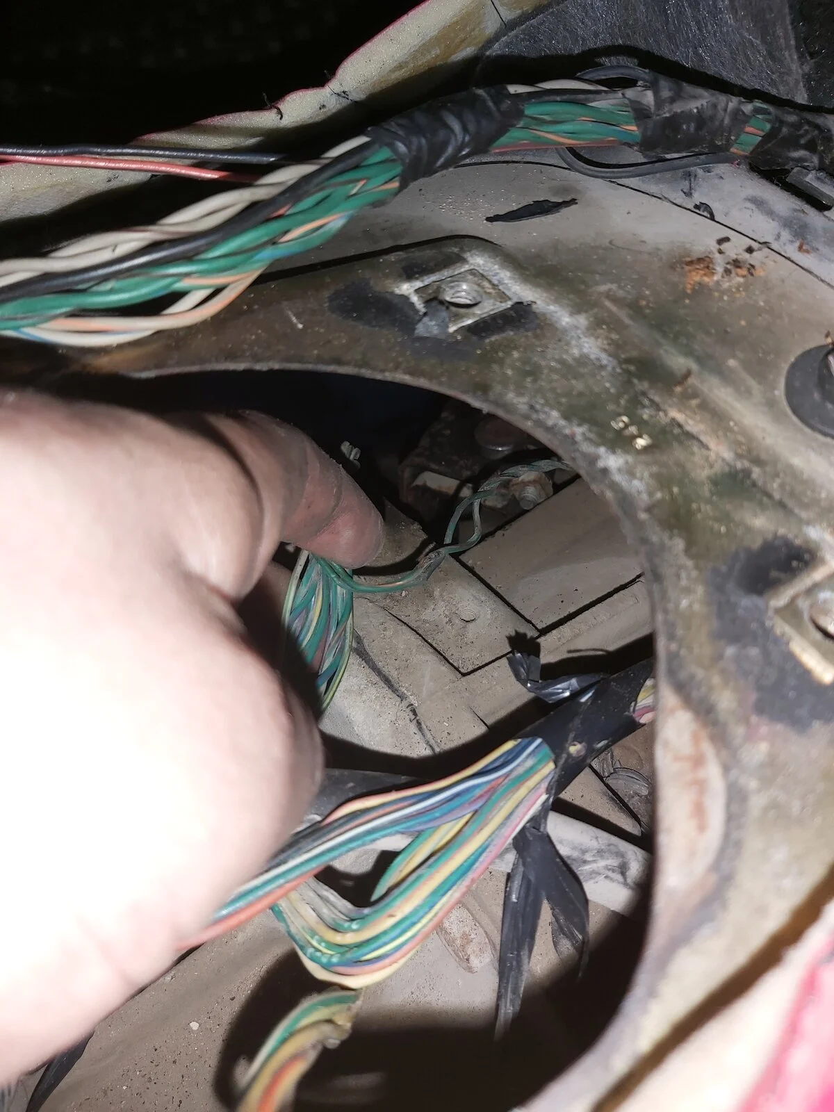

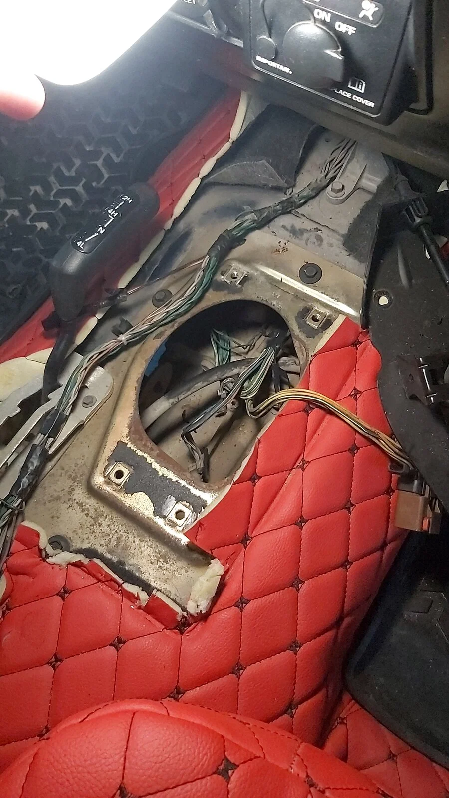

I have spent some time this evening looking over all the cables leading to the transmission plug and most seems ok the cables are in a better condition then expected. Perhaps the heat helps. Is there a way I can test the sockets with a multimeter or anything?

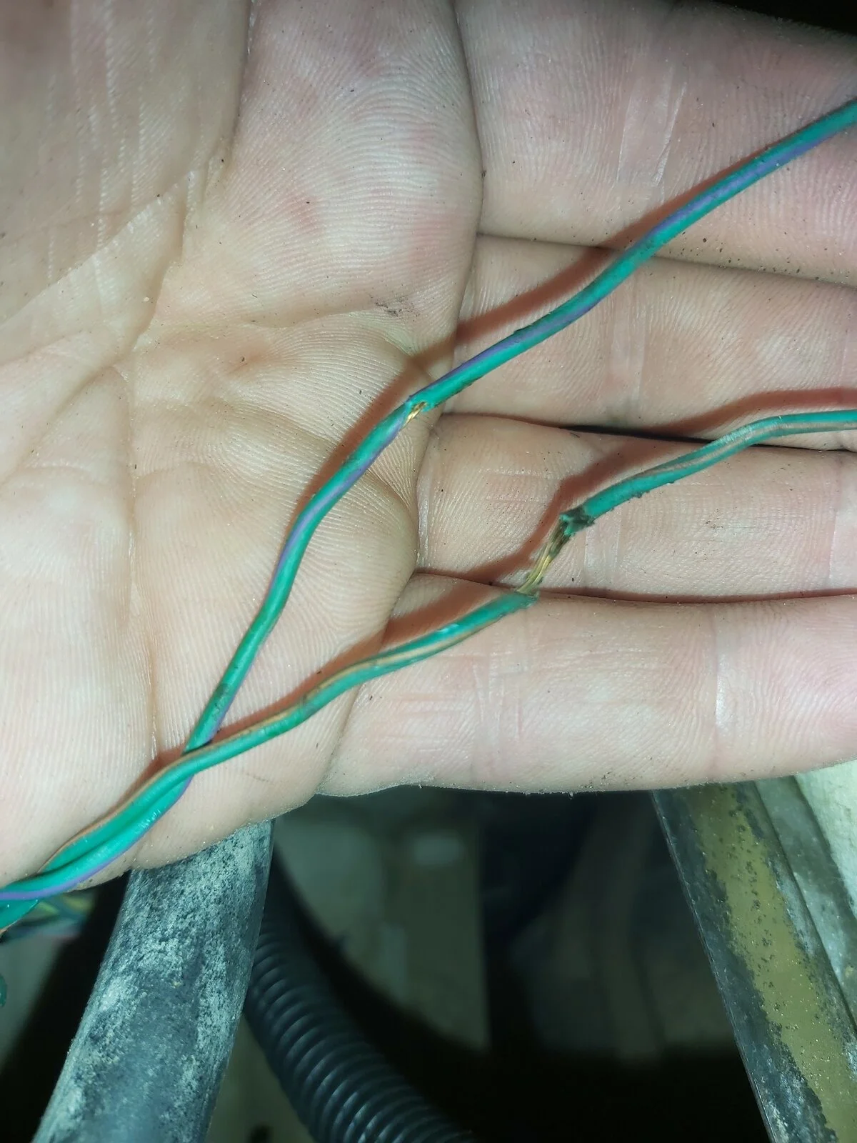

Hi all, so I have been inspecting the loom and I did find two split wires, however these didn't fix the issue, the two wires can from the gear box close to the solinoid plug. Attached photos. The issue has still not been resolved but I found the switching off my overdrive fixes my problem and I can drive the jeep with no issues what so ever. Any further advice to narrow it down further would be great.
Thanks again!
