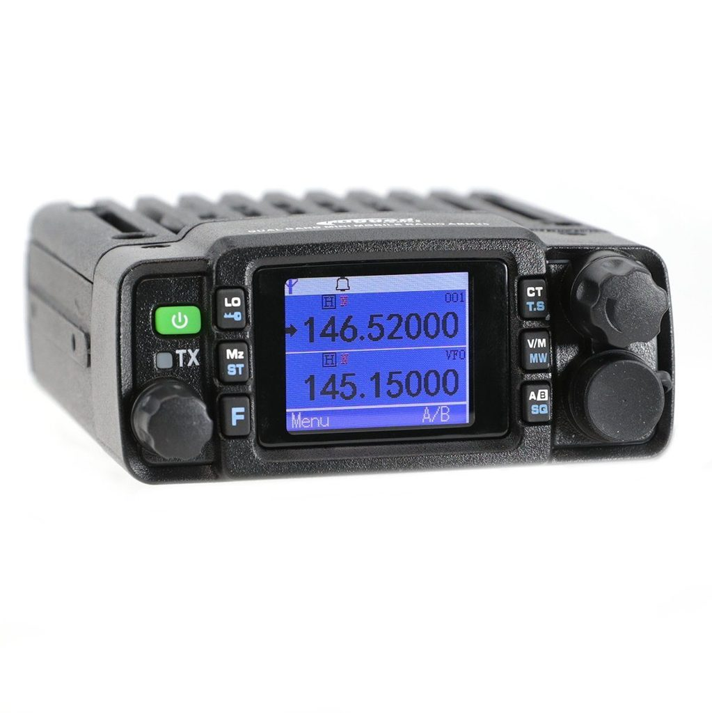

Yep, dual band, well technically, tri-band, shhhh.

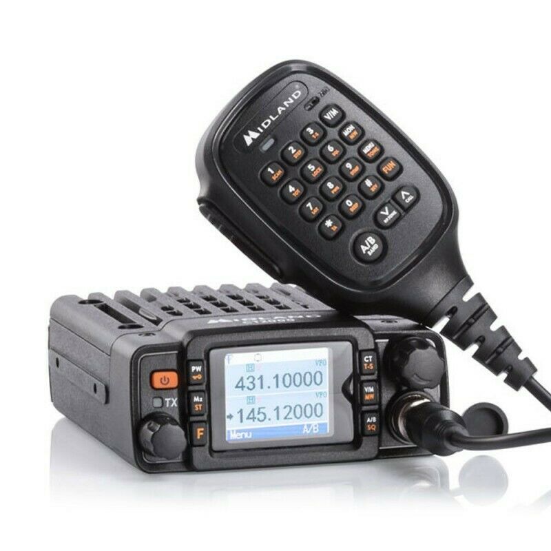

Yeah mine will do a lot more than advertised...once I finally figure it out. I finally got a manual for it, Midland sells the same radio but I need to get a DTMF mic for it though.

Is that the 25? If you can figure out the discrete/privacy whatever they are codes I'd like to understand how they work.

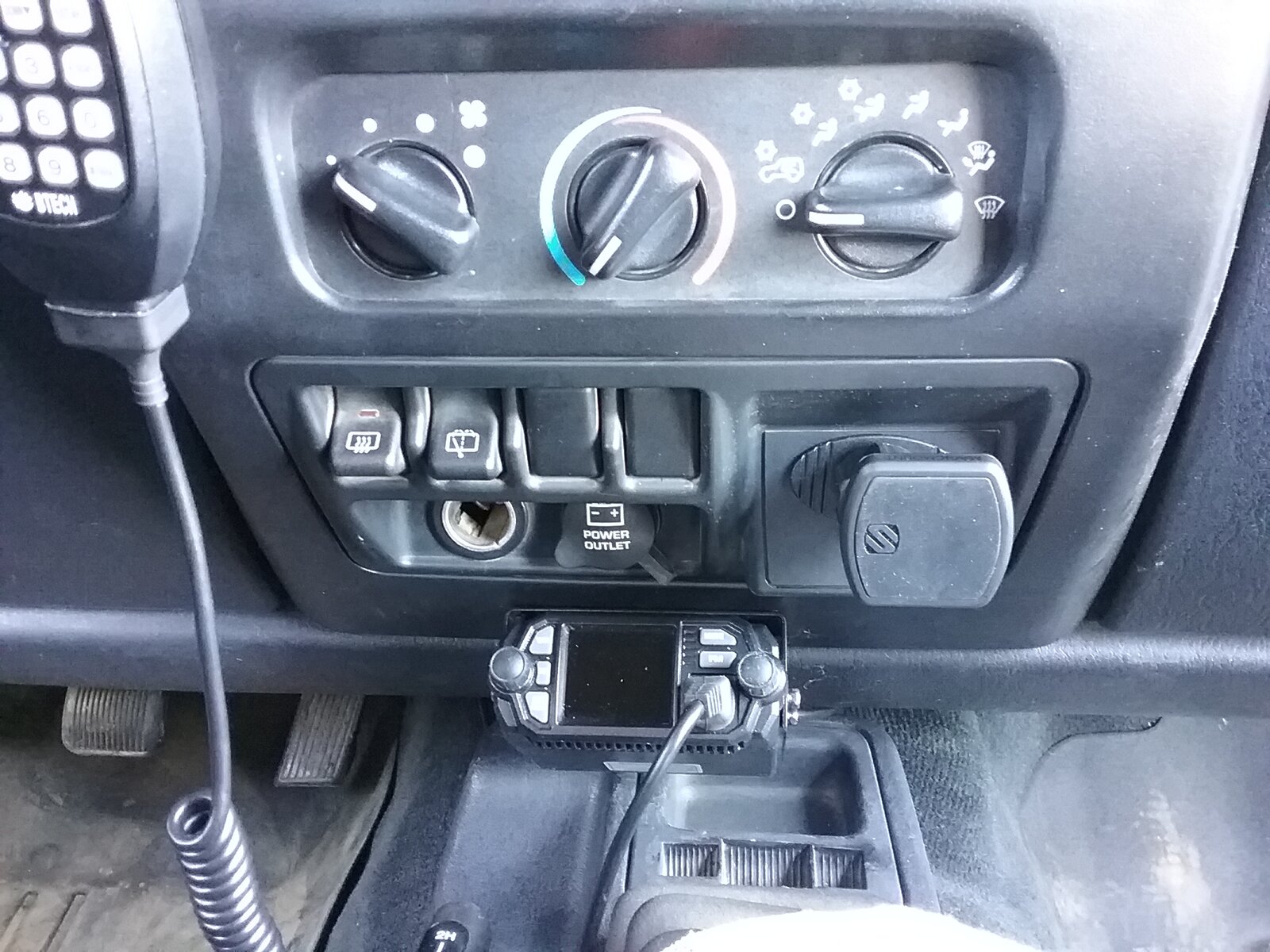

The size of that is really great for a TJ! Looks like the specs are pretty good too for a mobile unit. It'll be interesting to read your impressions on it over the next few weeks.

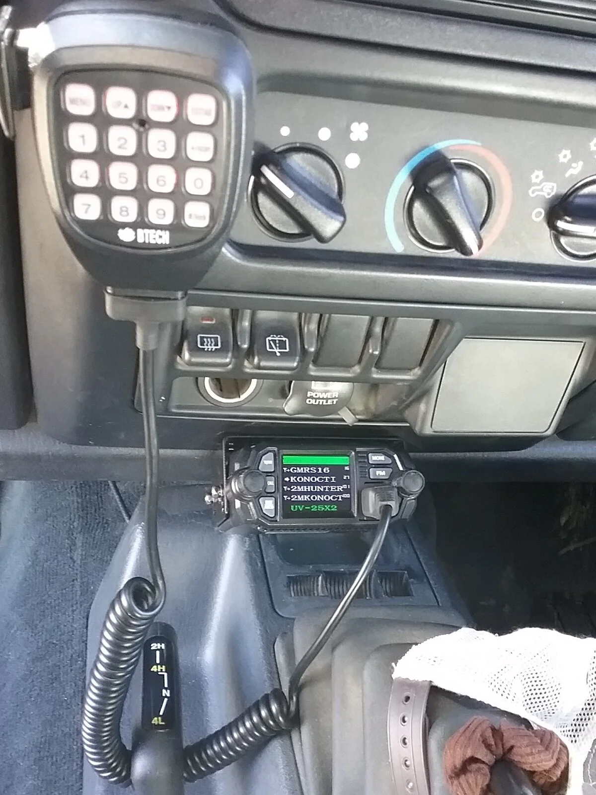

Yep, I wanted to take advantage of the small chassis since our mounting options are limited. So far it's performing well. Got a couple 2M repeater checks locally, as well as GMRS checks, so I know it's working and I've programmed it properly, lol!
You can definitely feel the quality difference though between this unit and my Wouxun I took out of the jeep. The feel of the buttons, the mic, and the shear weight of the unit tells me it's a $120 radio and not a $200 radio. We'll see how long it lasts after I bounce it around on some trails.
