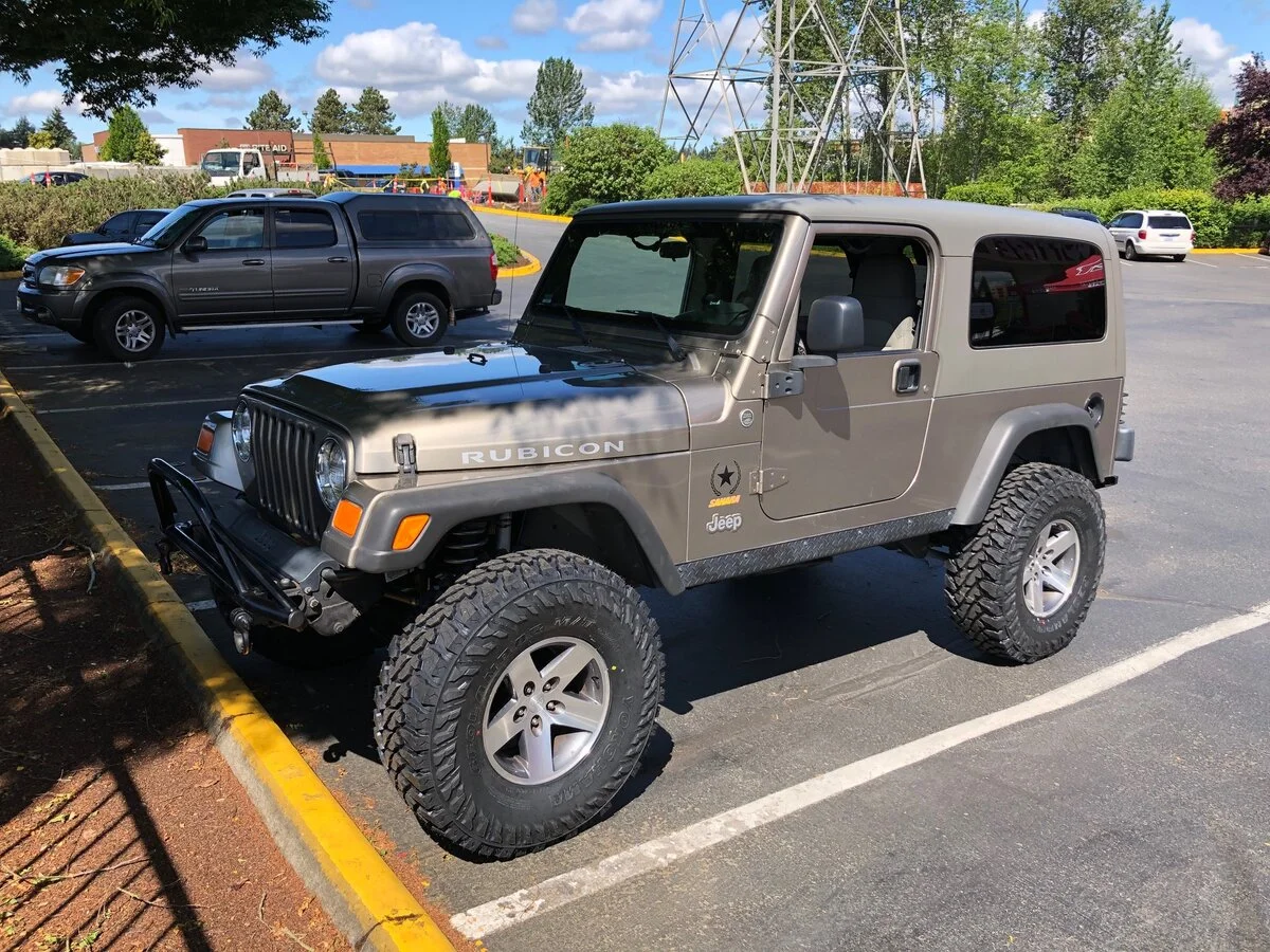

That’s a beauty, welcome to the Forum. If I ever purchased a Rubicon it would look like yours, keeping it very close to the stock appearance but slightly more capable.
Reactions: DuncLJ
@CostcoPizza did you score this from a dealer? Where was it at?
I'm in the biz. It was a trade in that I was able to buy to my used car managers dismay.
Awesome thanks!
Thanks!
That's exactly the plan, I like the stock + look.

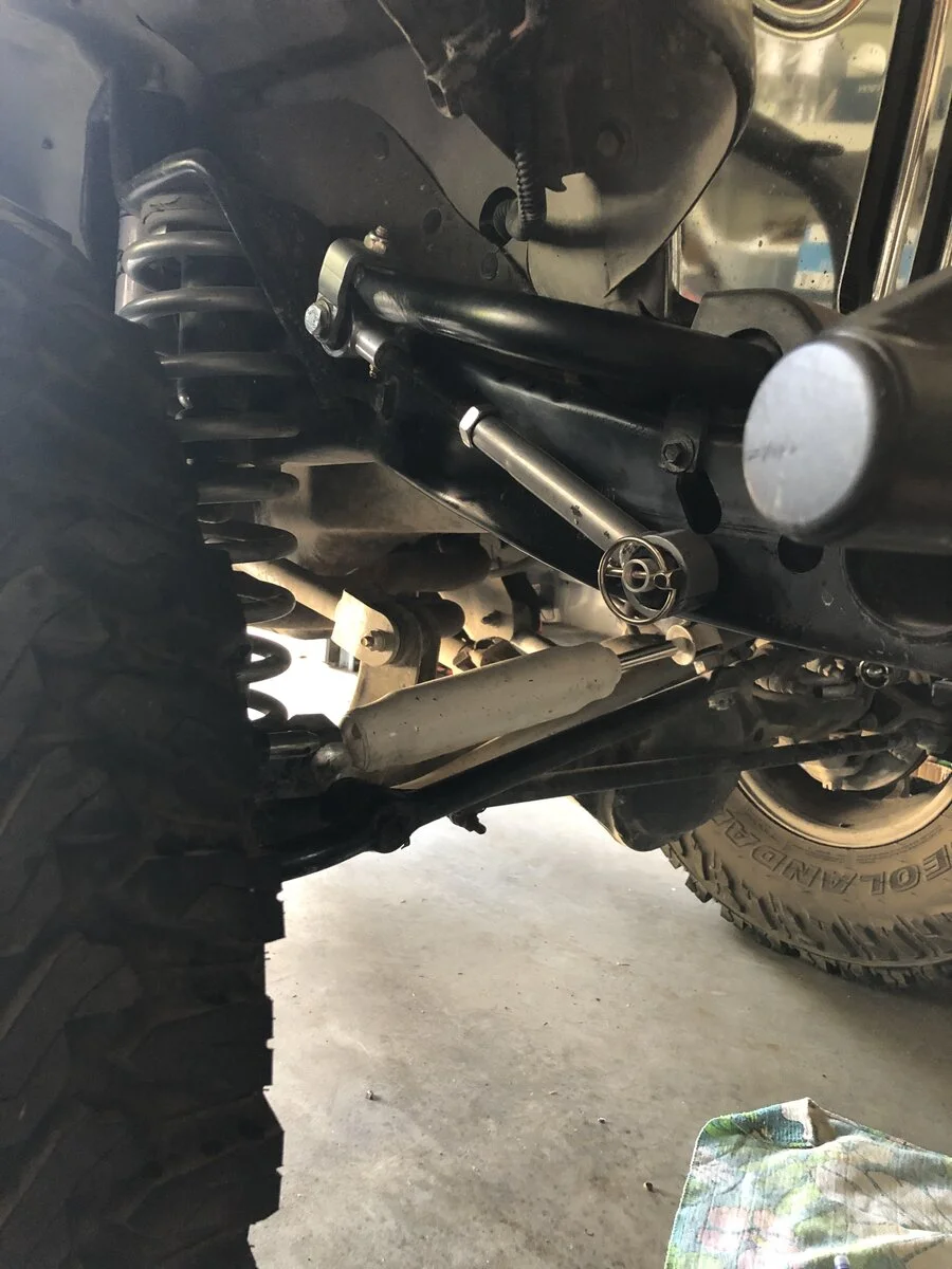

Sometime on my way home after my last trip I noticed the jeep handling funny and realized my passenger side swaybar endlink bolt was MIA. I bolted it back up with longer hardware and a nut on the end and a whole lot of loctite.
I also took the time to mount the sway bar disconnect mounts that I was too lazy to install when I did the lift.

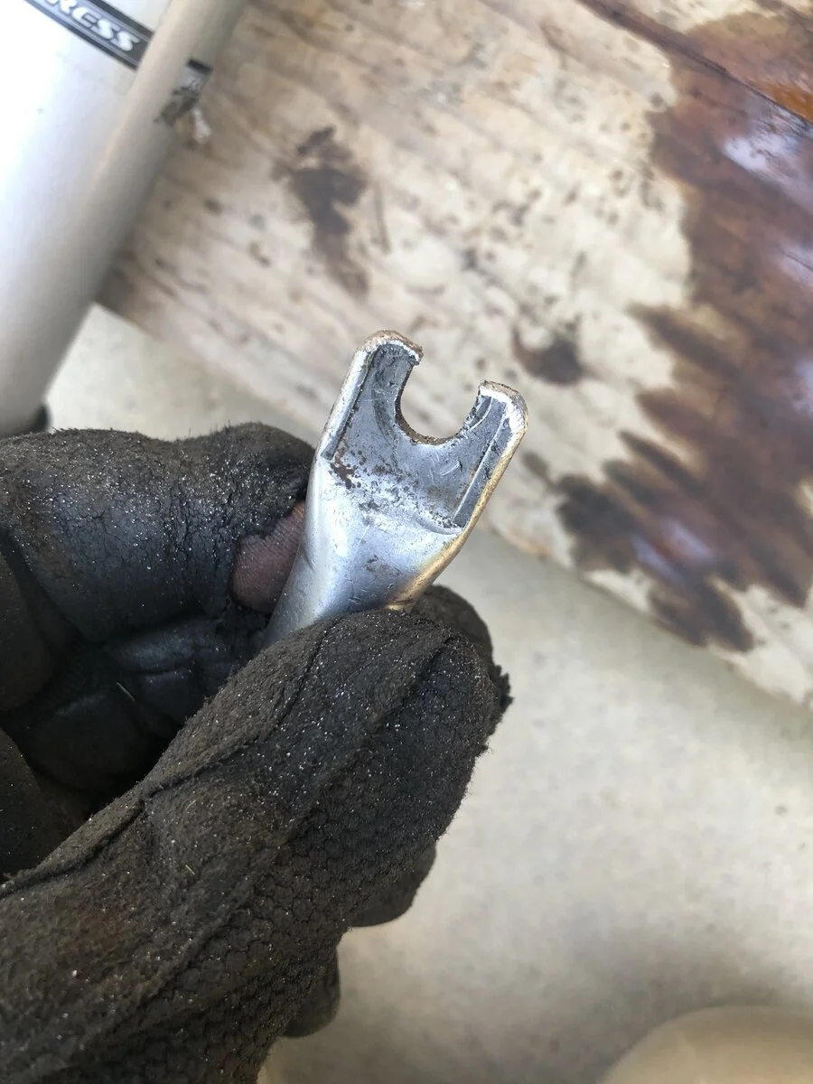

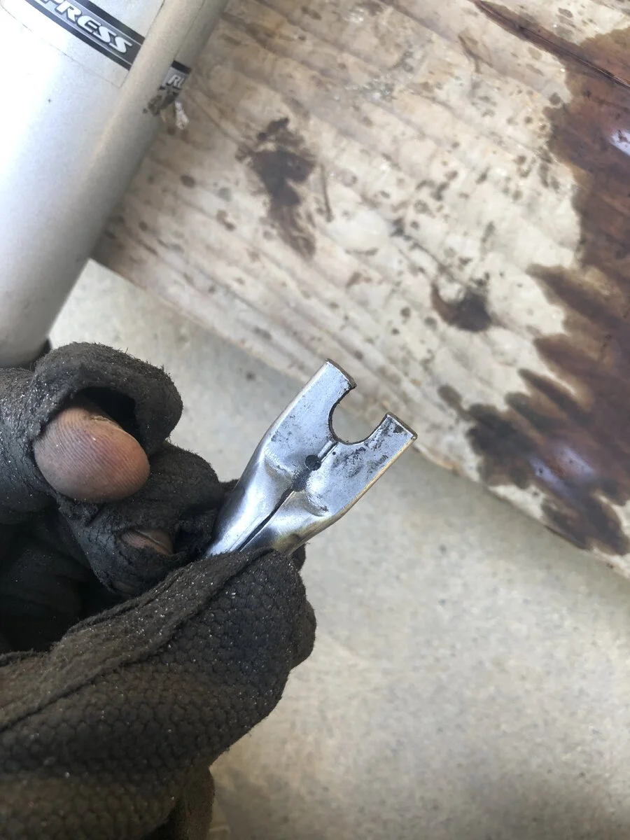

Went on a clunk hunt today. The rear has had a clunk that became more pronounced after my last trip.
I determined that it was the rear passenger shock bushing. When I installed the lift I damaged the bushing with cross pin during install. I was able to install much easier this time with some patience and a little file work.

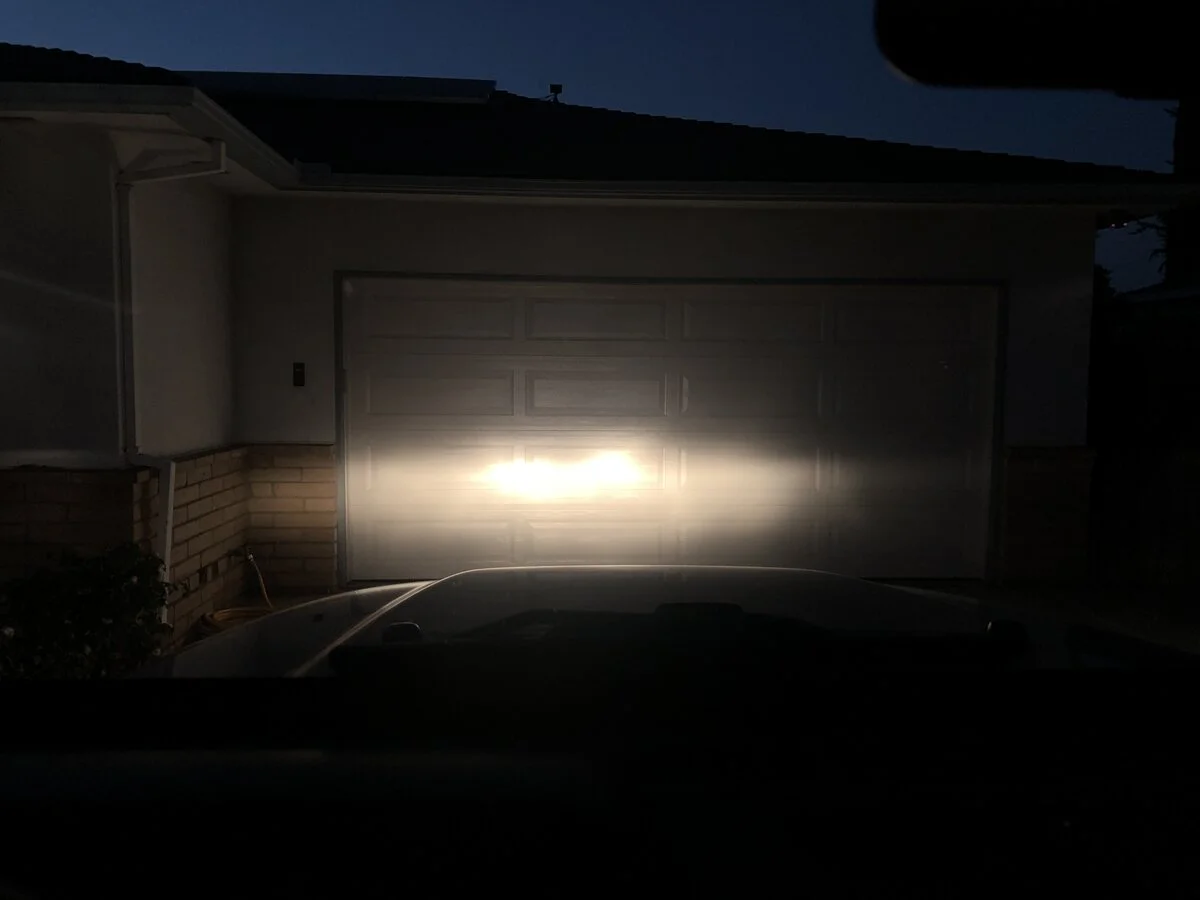

Installed the LED headlights today. One of the adjusters on the drivers side is busted so I’ll have to pull it off and repair or replace to get it perfect but not bad for now. Also relocated the light bar to the bottom, I think it looks cleaner.
