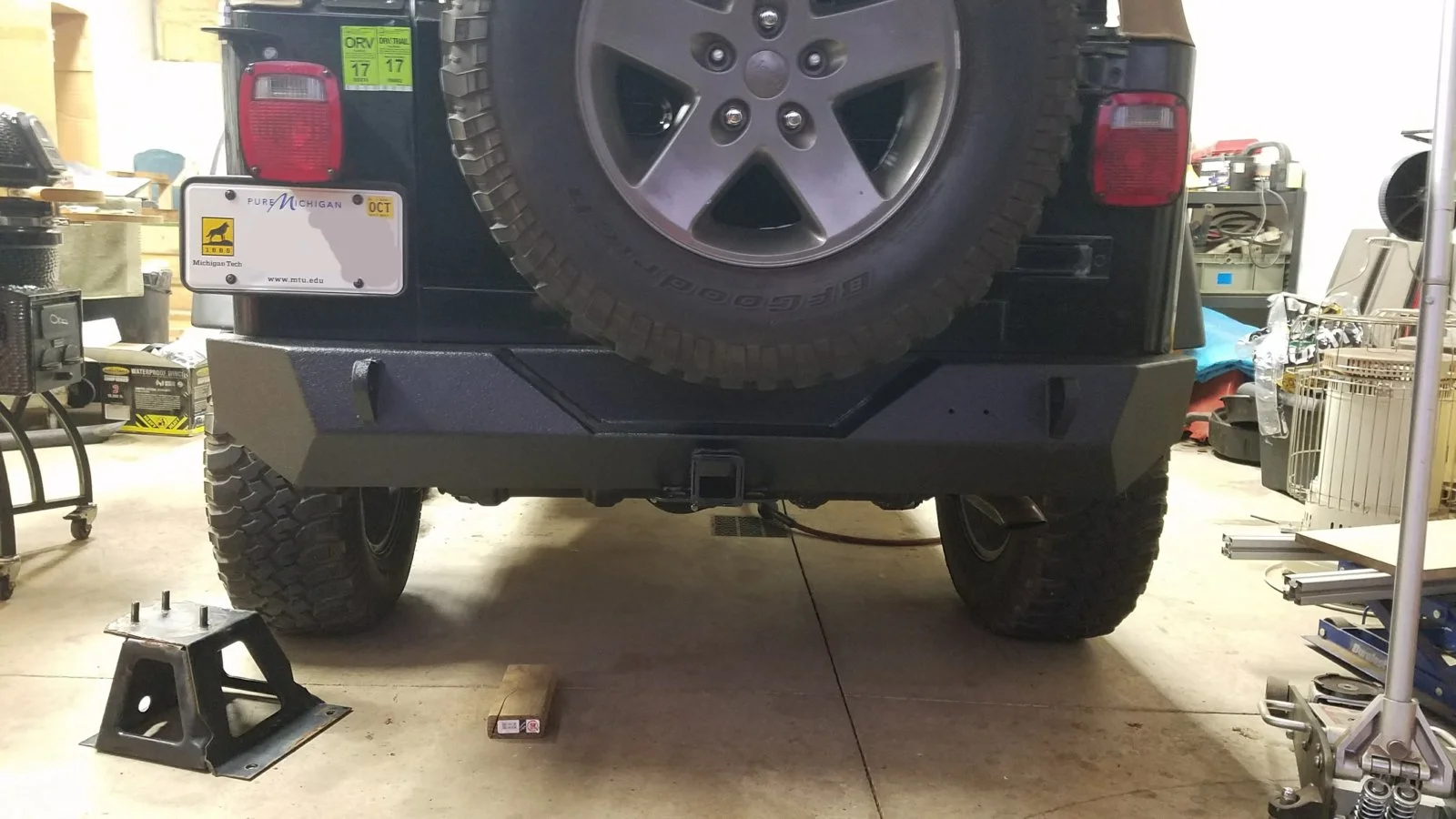

You could add a body lift, and remove almost ALL your bumpstop... :)
No crack here and I have 1.25" BL
