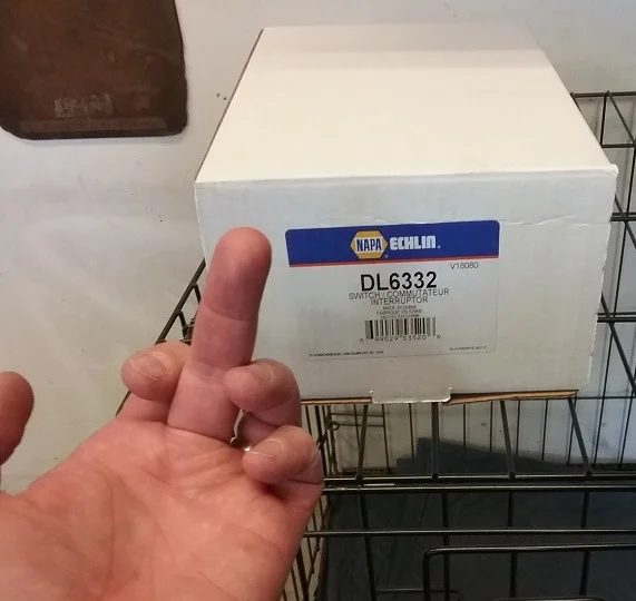

"The continuing saga of the pesky multi-function switch" continues.
Ok, the cliff notes version. Replaced my turn signal switch a while back because the fog lights would stay on for no reason other than to mock me. Couldn't have the jeep down, so I picked up a Napa Echlin switch and installed it. Figured I'd take the Mopar one apart and do the fix that @jjvw did on his. Being all proud of myself for thinking I fixed the old switch, I put the old one on the shelf for when, yes, when the Napa, made in China, garbage flew the coop. Well, it didn't take long for that to happen. Bout 6 months or so me thinks. Hit the hazard button one day and PUUFF! fries the MFS circuit fuse. Ok, time to shine fixed Mopar switch. I install it, and hmmm, headlights stay on no matter what position I have the headlight switch on. Well, this won't work. Didn't have time to take it back apart and see what I screwed up, so off to Napa I went to get a free replacement(lifetime warranty is underrated if you have to constantly replace these pieces of garbage). 2nd. new switch in and 4 months later, turn signals started acting up and wouldn't signal unless I held the lever fully engaged. Am I surprised? NO! Back to Napa for switch #3, which is what happened today. I'm getting pretty efficient at changing out the multi-function switch. At some point I'll take the factory one back apart and see if I can find out what went horribly wrong. In the mean time, gotta get the jeep ready for toad duty later this week.
