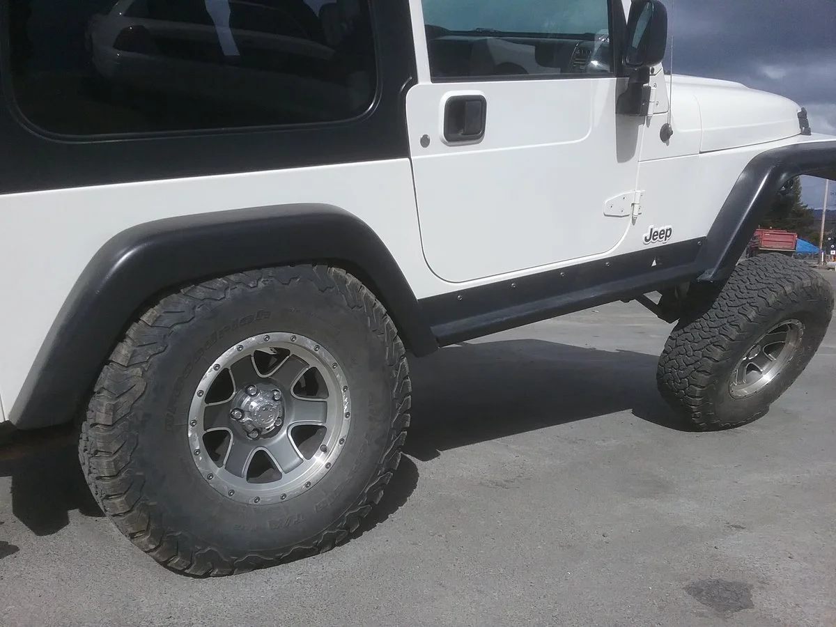

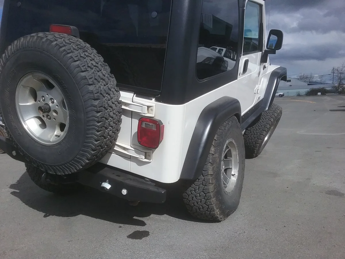

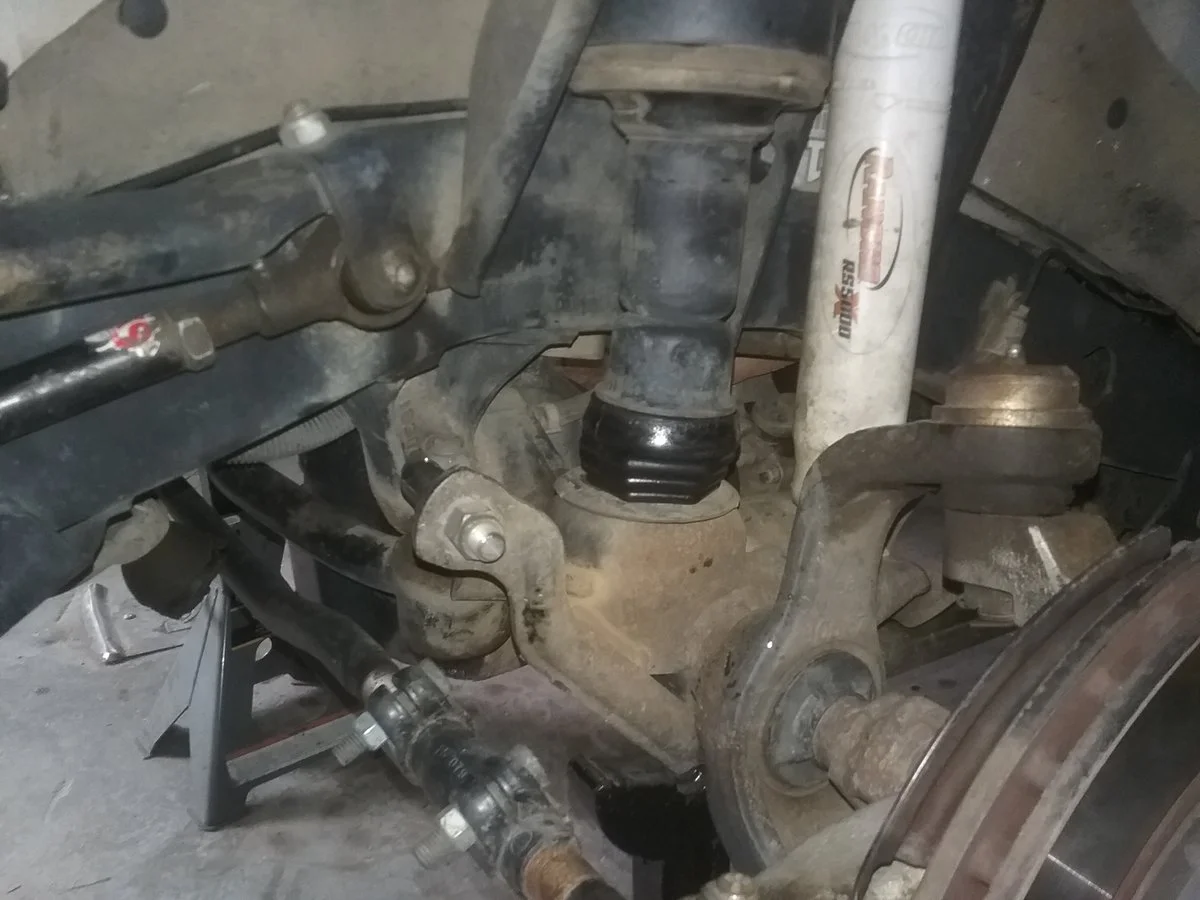

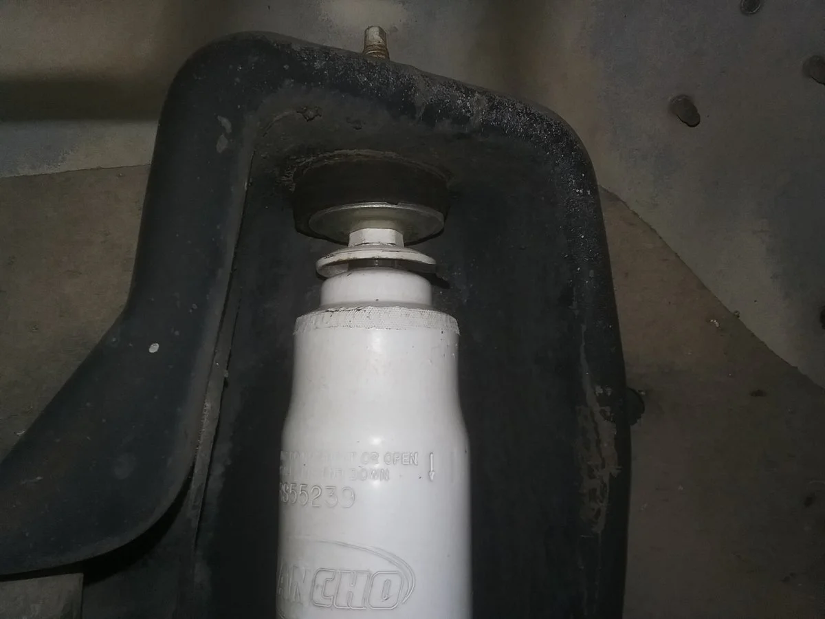

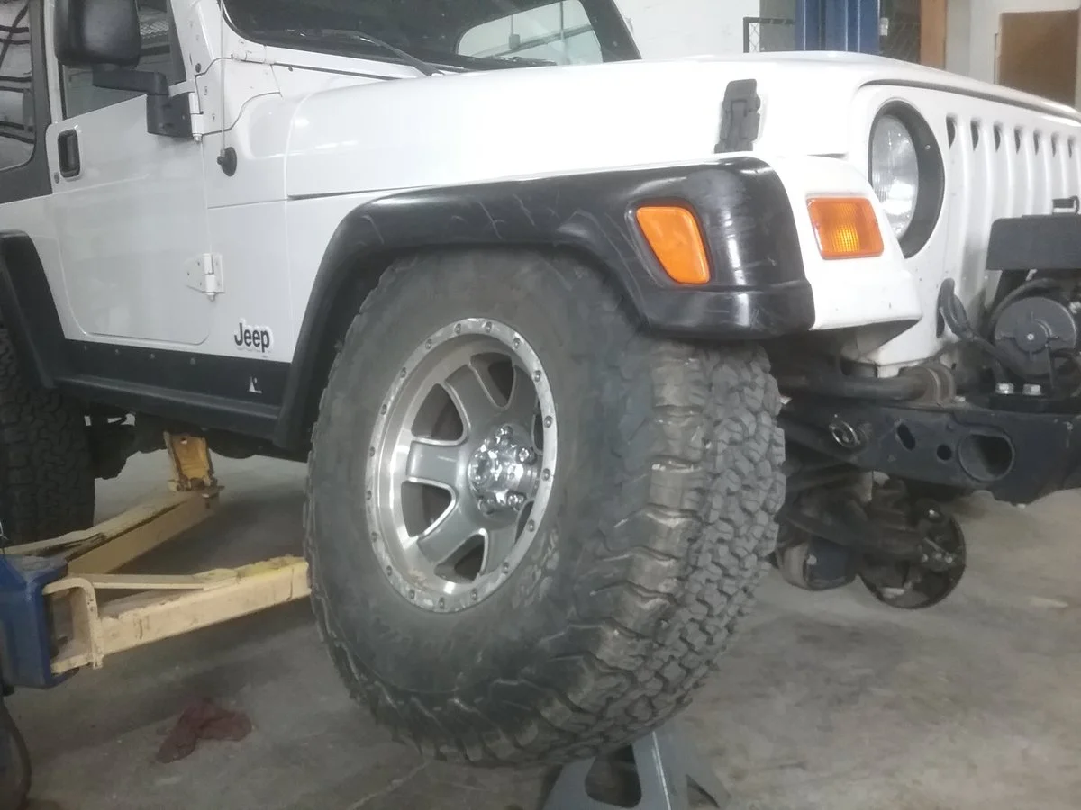

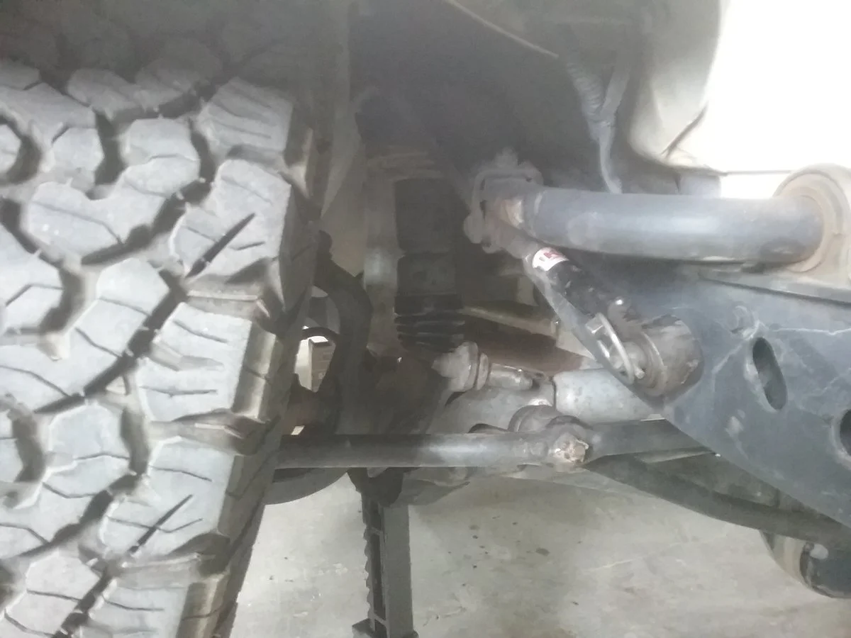

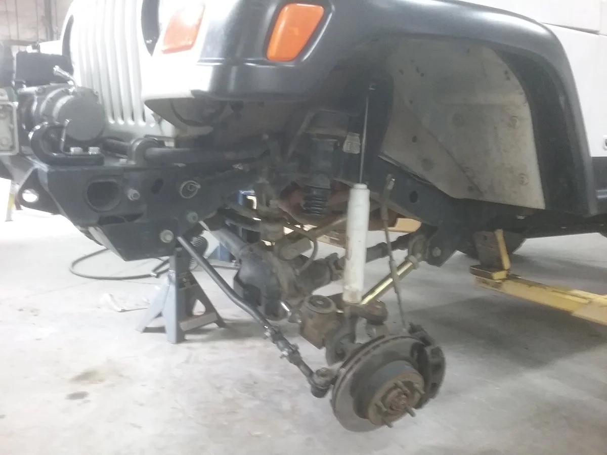

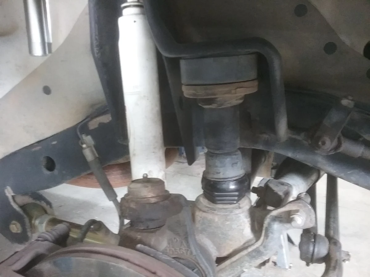

Moved on to installing my MC front bumps. Pulled the springs, set to full bump,
With the full weight of the jeep on them I get 1-5/8" of hard bump. Shocks are really close.

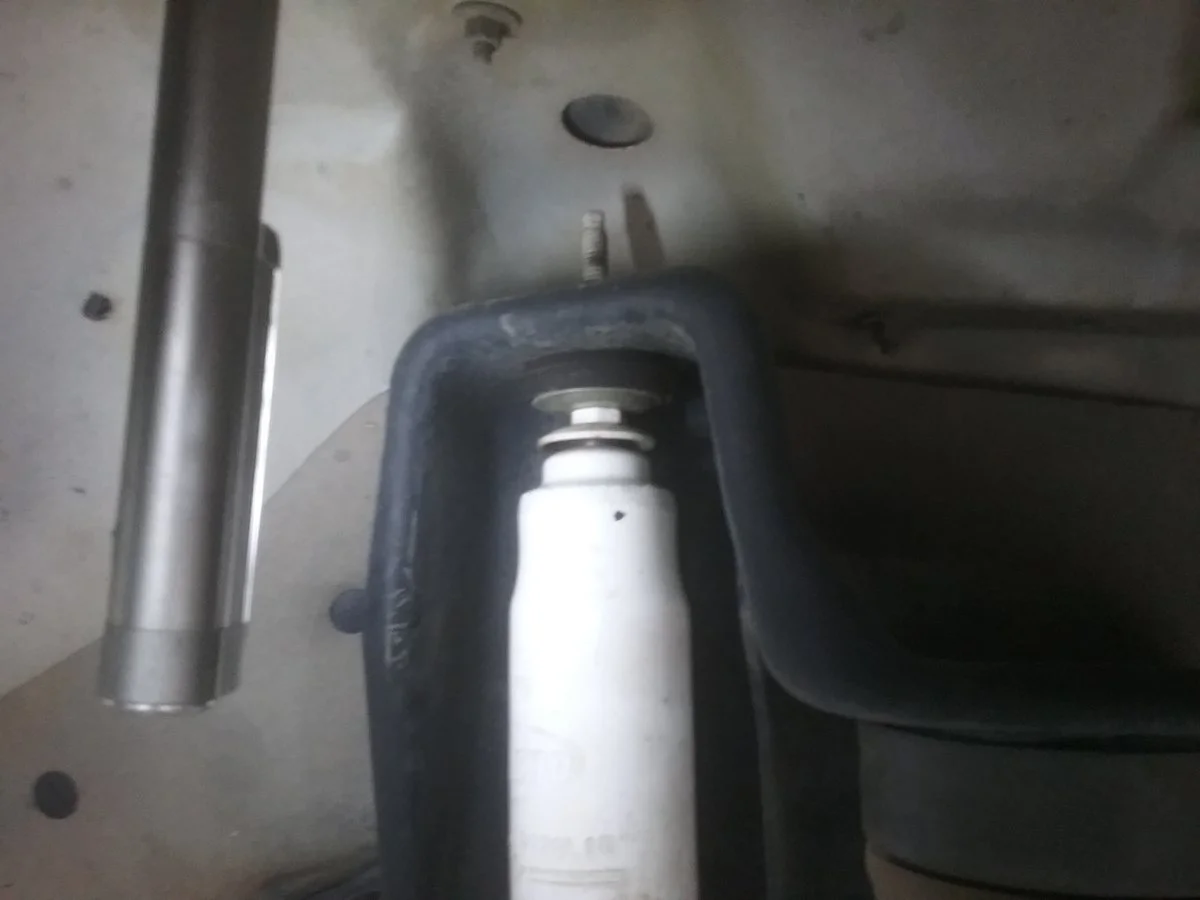

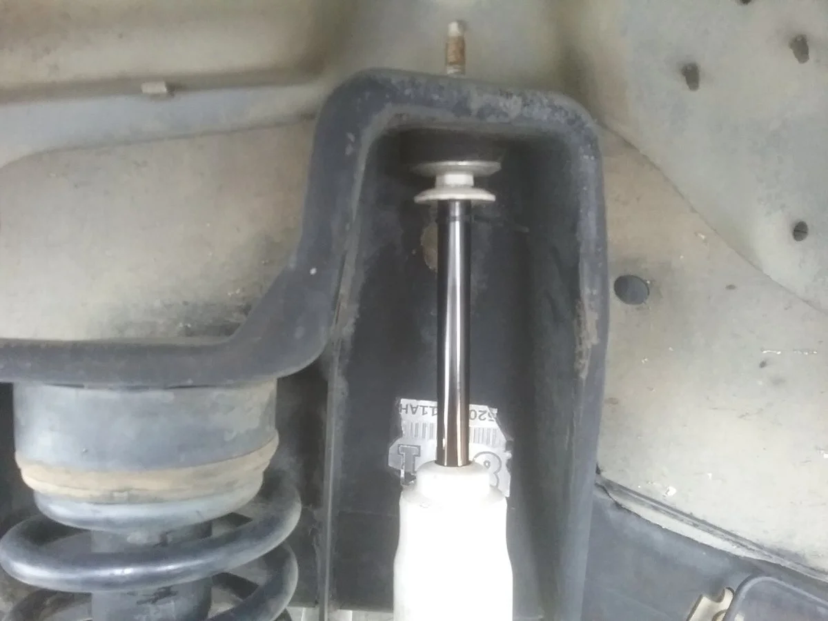

About 1/4" of shaft left. I'm gonna let it go for now, but might add another 1/4" of bump to the bottom later.

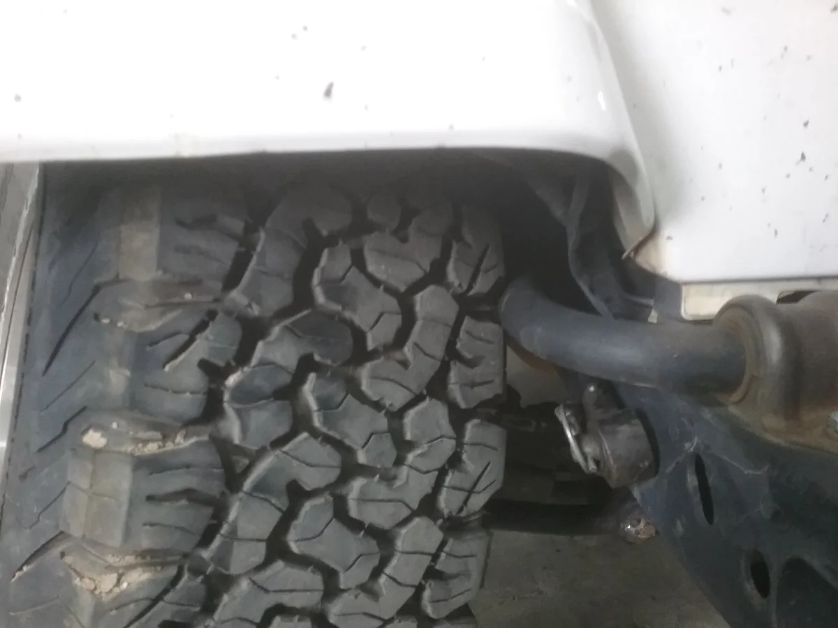

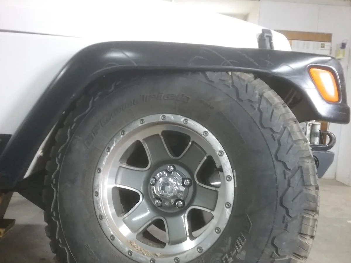

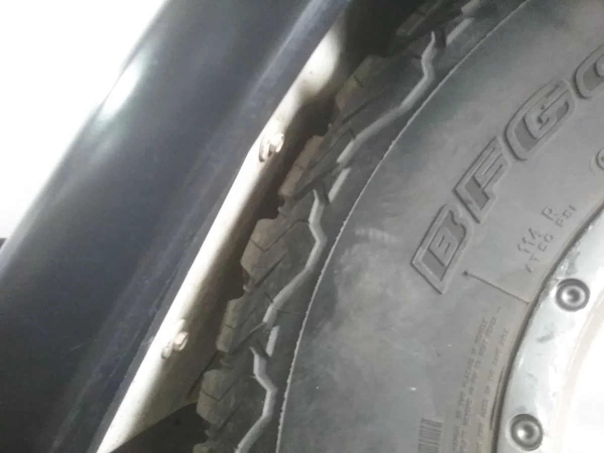

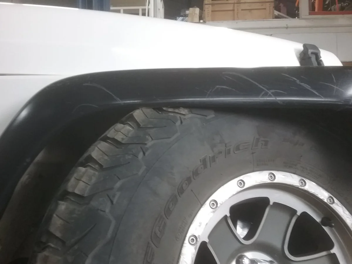

Tires rub pretty good, but I'll call it acceptable for now.

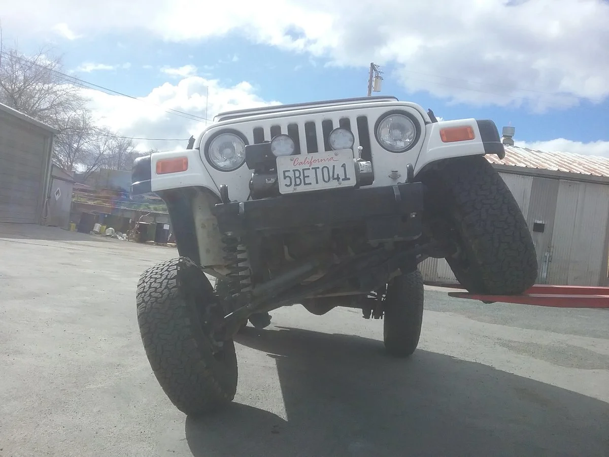

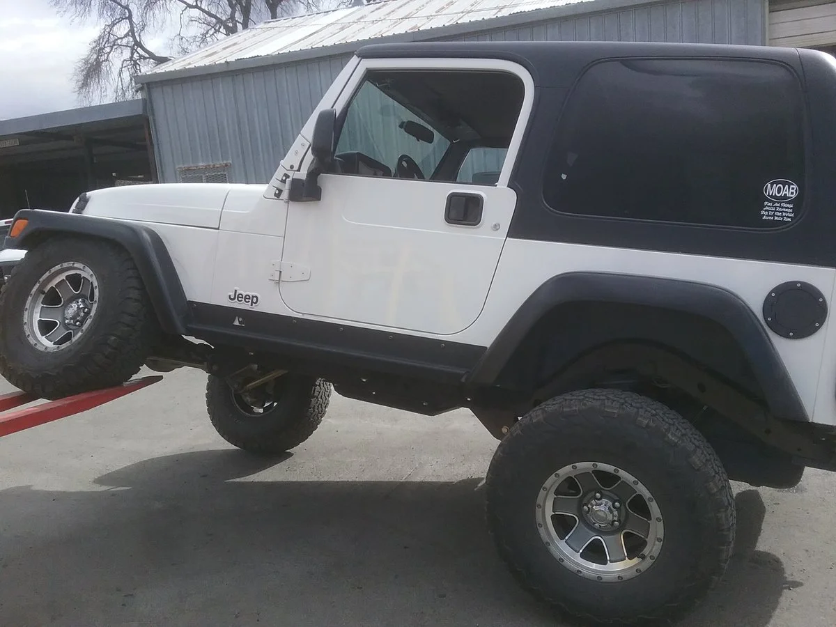

Put it back together and flexed it some more.
I get a bit more cushion with the shocks. Real world trail flexing may vary some, but not by much me thinks.

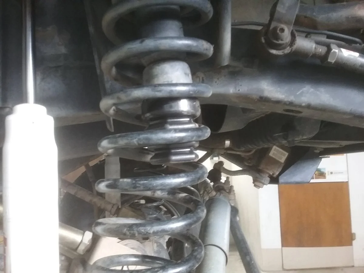

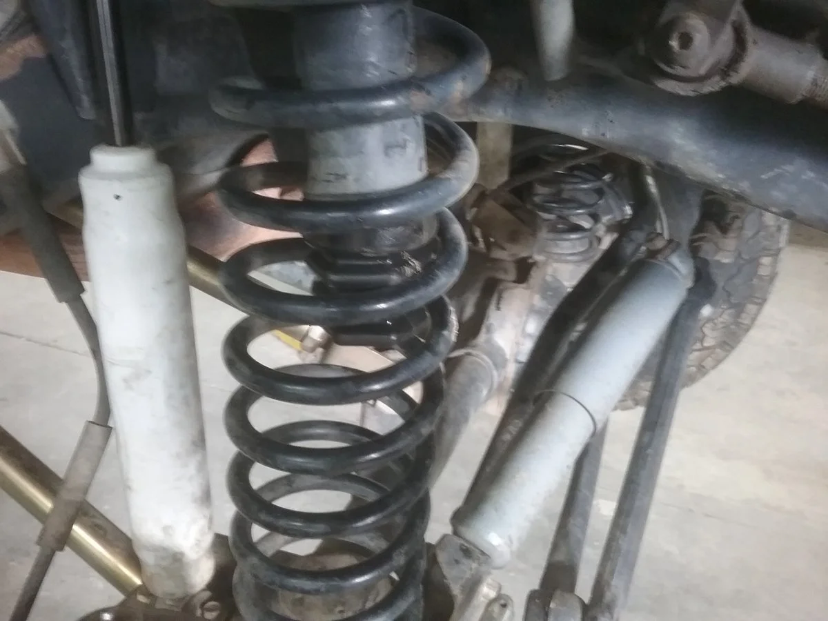

One thing I knew was going to be a concern is the length of the new jounces. At full extension they rub against the spring some. I'll have to keep an eye on that. The factory jounces did a little too.
Reactions: DrDmoney
How much farther can you push the axle forward before your TB hits the diff? I would try to squeeze as much forward to give your tires clearance on the rear, and keep the springs from pulling as far back at droop.
Reactions: bobthetj03
