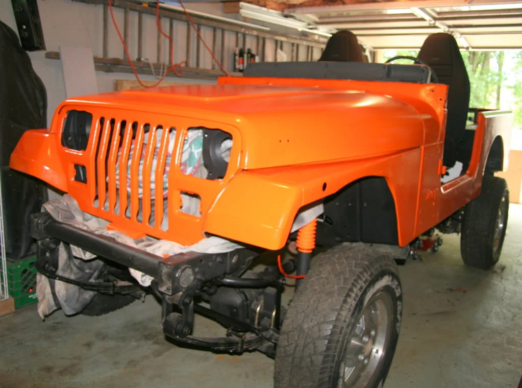

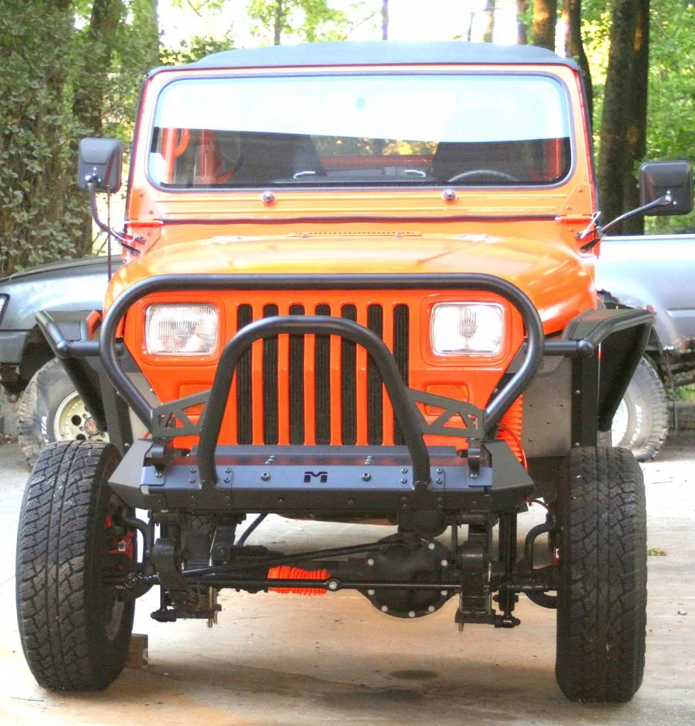

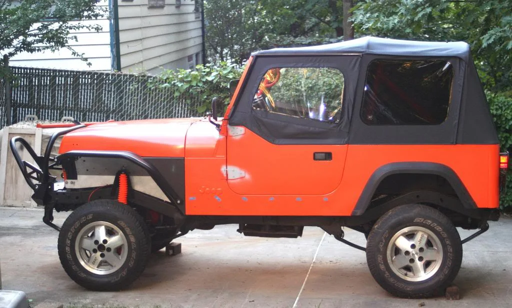

Bullshit. I've painted a couple cars with rattle cans...and after spending more time color sanding and polishing than it would have taken a body shop to paint 30 cars, I can say my finish was as good as theirs....and probably more durable, since i had 9 coats on it. LOL.
Then I got a spray gun and bought a gallon of Western Hi-Glo enamel along with reducer and catalyst out the door for $80 at the local auto body supply...painted 2 trucks and a boat with it and still had half a gallon left that needed little to no additional finishing work to look like a real paint job.

I did a rustoleum enamel over bedliner paint job going on 10 years ago now on my YJ, and it's holding up fine (everywhere except where I removed/replaced the door hinges) which as soon as it gets to it's new home in AZ, is going to simply be touched up
if I were to do it today, I would just do it in one if the cool colors from Monstaliner and call it a day
