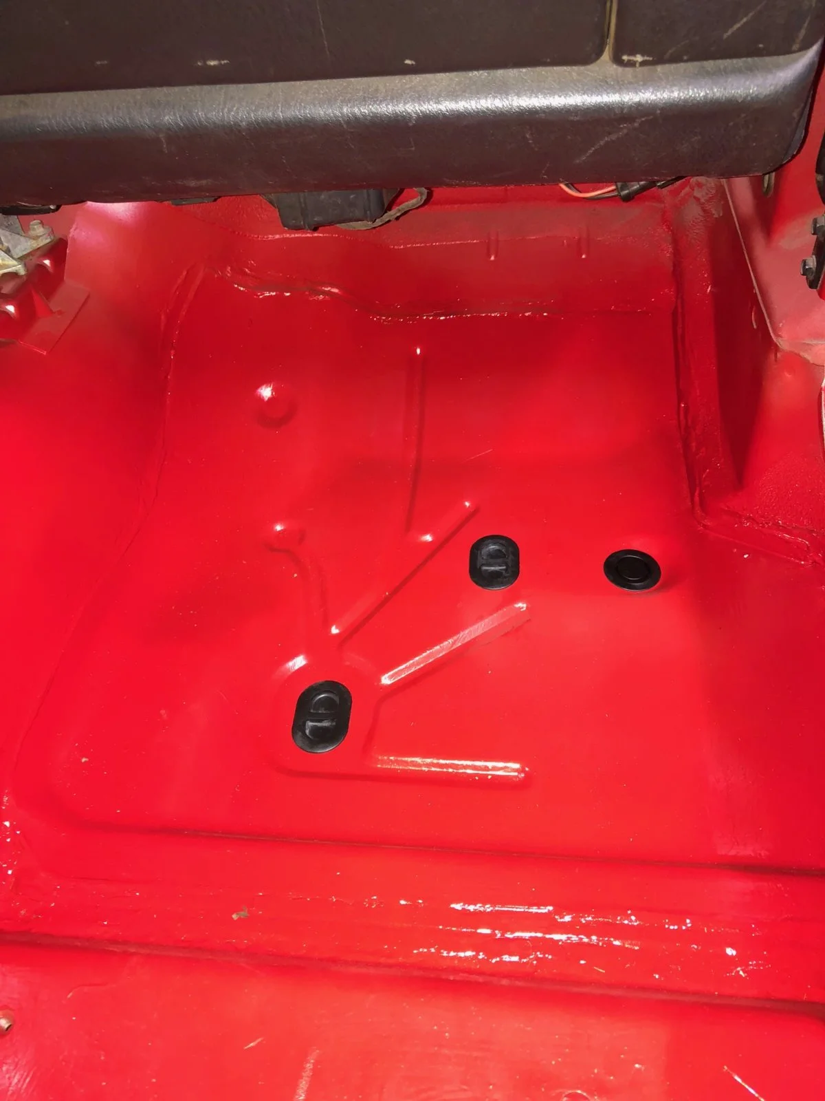

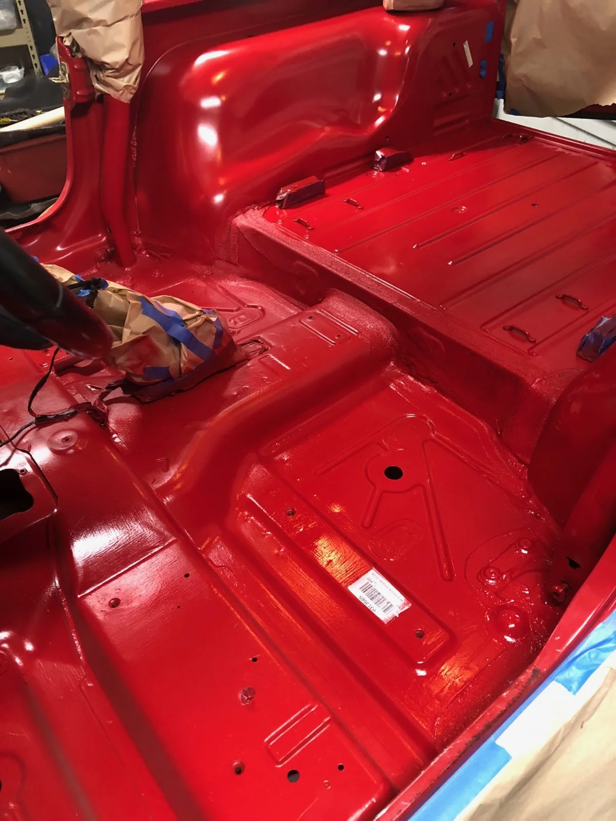

I used the flame red paint code off my VIN number to get color matching red primer, color matching base color, and clear coat. Was very happy with the color match as it blended well with the existing paint on the jeep. Sanding in between coats and buffing the clear coat left a nice finish. When im feeling brave ill tackle the flares... maybe even my hood... Here are some before and afters....

I used the flame red paint code off my VIN number to get color matching red primer, color matching base color, and clear coat. Was very happy with the color match as it blended well with the existing paint on the jeep. Sanding in between coats and buffing the clear coat left a nice finish. When im feeling brave ill tackle the flares... maybe even my hood... Here are some before and afters....View attachment 94433View attachment 94434View attachment 94435View attachment 94436
That is a really good match, but just to be clear, My plan is to use a spray gun. I'm currently shopping for a compressor.

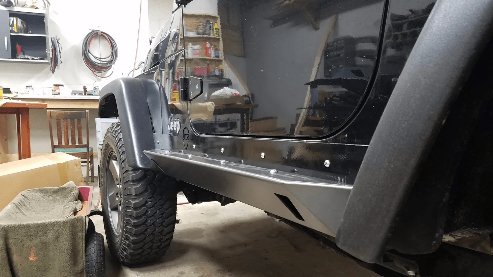

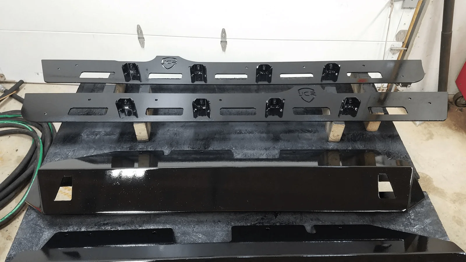

If you're set on using the implement paint (not a bad idea) make sure to get the reducer to spray it. Its WAY too thick to spray otherwise. Also, Mix in some of the hardener. It is a catalyst that increases the gloss level and decreases dry time. I've used it with great success on my sliders. Its holding up pretty well.
I can get a quart of primer and a quart of paint, reducer and hardner for about $50. If it doesn’t work out for the Jeep I’ll have a lot of red cabinets and lawn tractors. Lol
