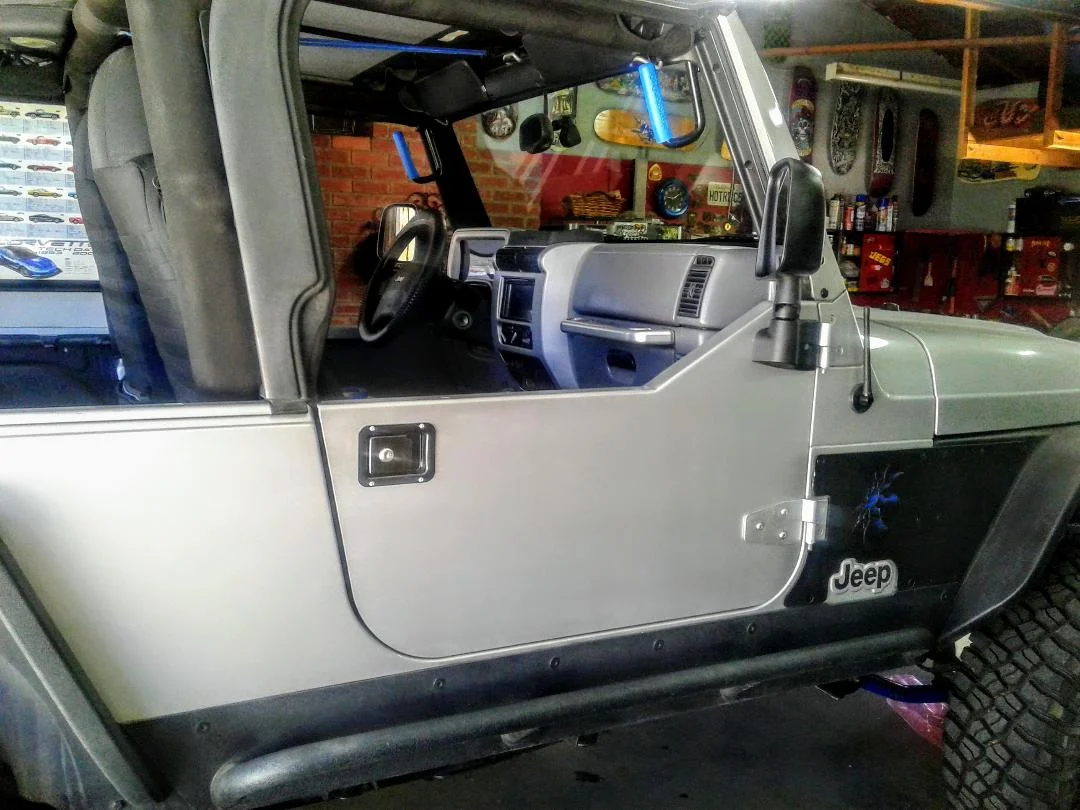

Rattle can paint for half doors

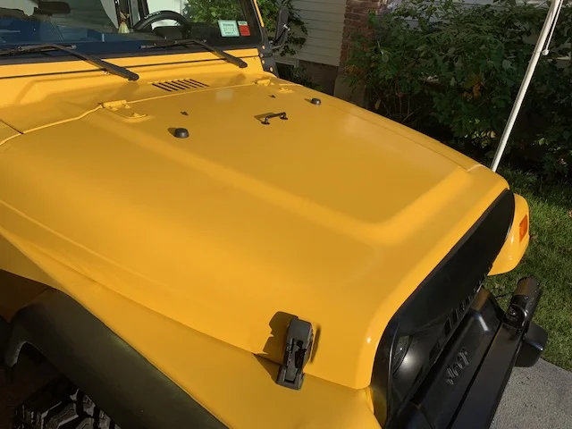

I also did the same with my hood

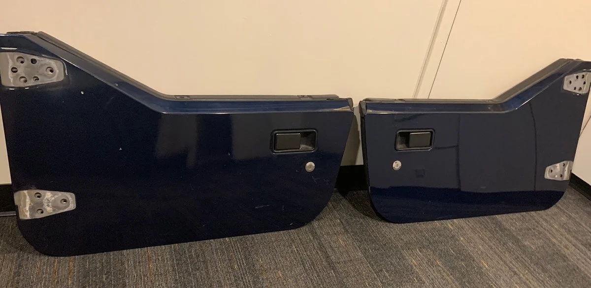

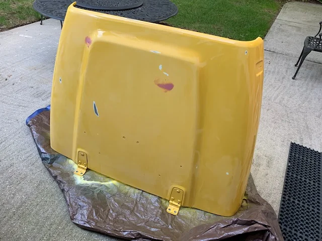

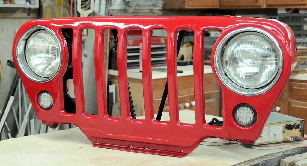

I've had very good results with rattle cans. I did these flares years ago when I was converting my LJ into a pickup and they held up very well:
And recently I did this CJ/JL-style TJ grille with rattle cans.
Color on both is an exact match for the factory color.
One thing I highly recommend is doing a very durable clear coat over the rattle can color. The best way to do that with rattle cans is to use a 2k (2 component) clear like this one from Eastwood: https://www.eastwood.com/eastwood-s...zlXXMFxQuK_Z-Uc95KWsIC7ykQWpnvmYaAhuOEALw_wcB or the SprayMax clear posted by @CodaMan earlier in this thread. These come in a special can which provides for mixing the two components before spraying and as a catalyzed finish it's very durable.

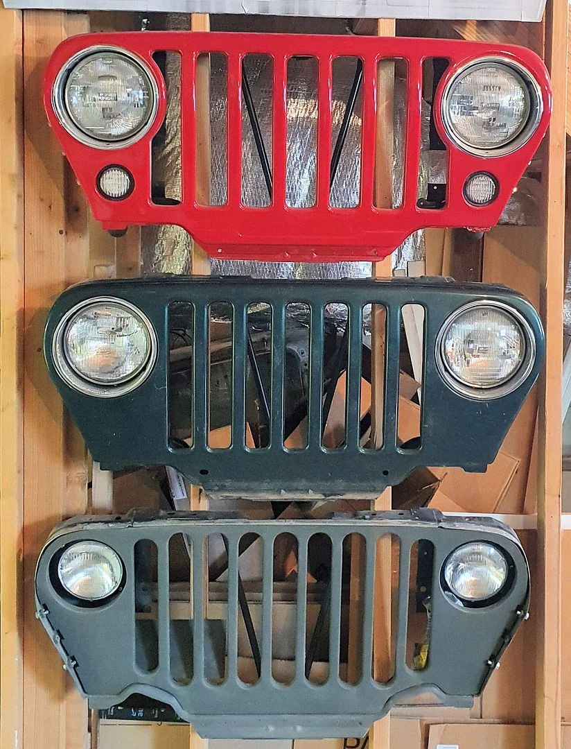

I may have missed it. Did you ever make a decision on production of those grills. I’d love one.
I haven't done anything with that grille since I finished the first one out of the mold. I've got the mold here and it's available if anyone wants to produce these grilles, but I'm not in business and I don't sell anything so if it's going to become available someone's going to have to pick it up.
Also haven't had time to finish the mold for the Willys MB-style grille I've been working on, too many other priorites recently . There's no urgency since these won't be going on any of my Jeeps, I'm just doing them as "art projects" :).
Hanging in my basement... the CJ/JL style grille, a stock TJ grille and the Willys MB-style work-in-progress grille...
