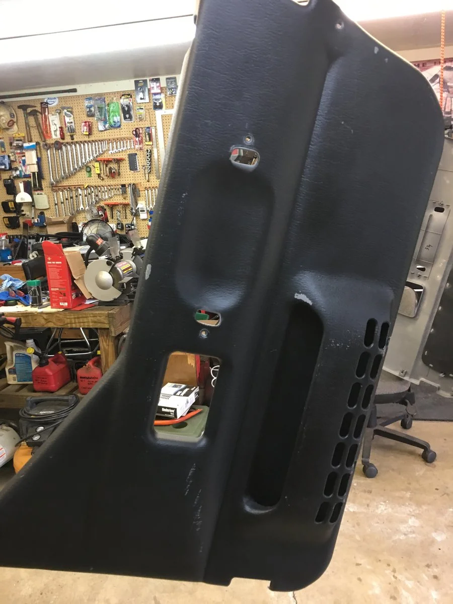

I washed the door panels down with Dawn dish soap and a 3M gray scuff pad. Whatever the black paint is a previous owner installed must have been applied properly. Barely any of the black came off and I scrubbed pretty hard on the areas that had wear and chips in it. When ever I get to paint it, I'll hit it with some type of adhesion promotor before applying the SEM paint. This isn't a priority for me to get done. I had actually planned of doing this over the winter, but I was a little bored this weekend and decided to do a little. Hell, I've had the doors about 1-1/2 years (I think) and just put them up in the shop attic until I was ready to do something.

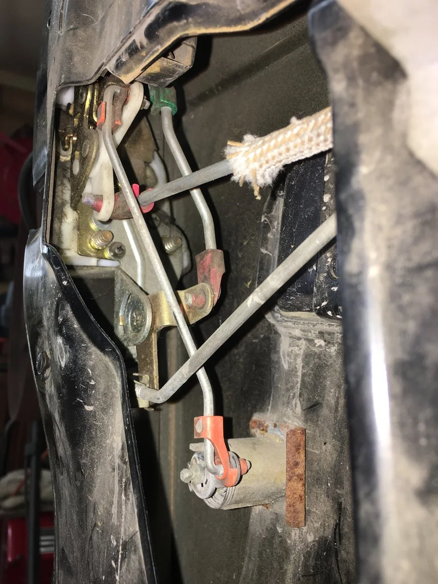

Thought I'd throw a couple more pictures on here for reference.

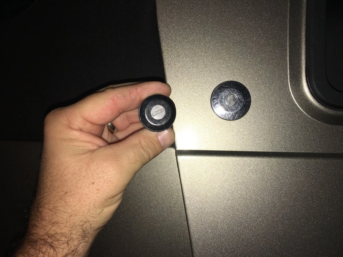

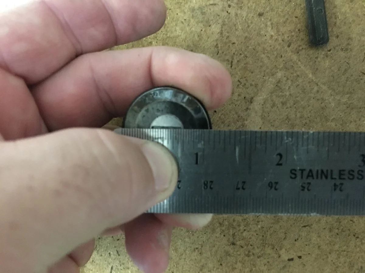

I've heard the lock cylinder caps are different sized on different years. I think the '97 - '02 are smaller than the '03 - '06. Not positive if those years are 100% accurate though. My Jeep is an '06. I know these doors came off of an older TJ because they had the funky door seals that had the plastic track that the seals slid into. It appears that these cap are smaller than my '06 caps. I don't know if the cylinders themselves are different sized though.

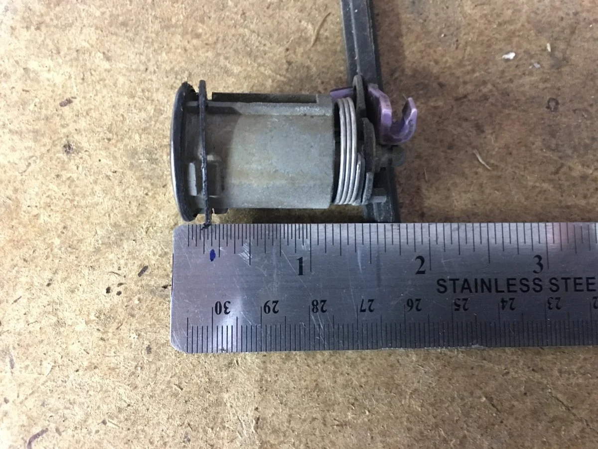

Passengers side half door cylinder.

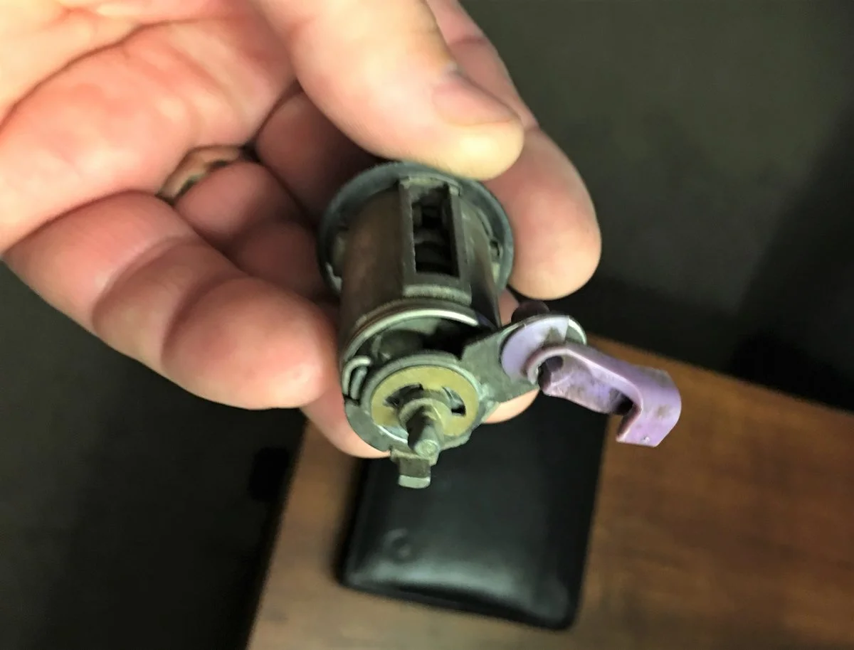

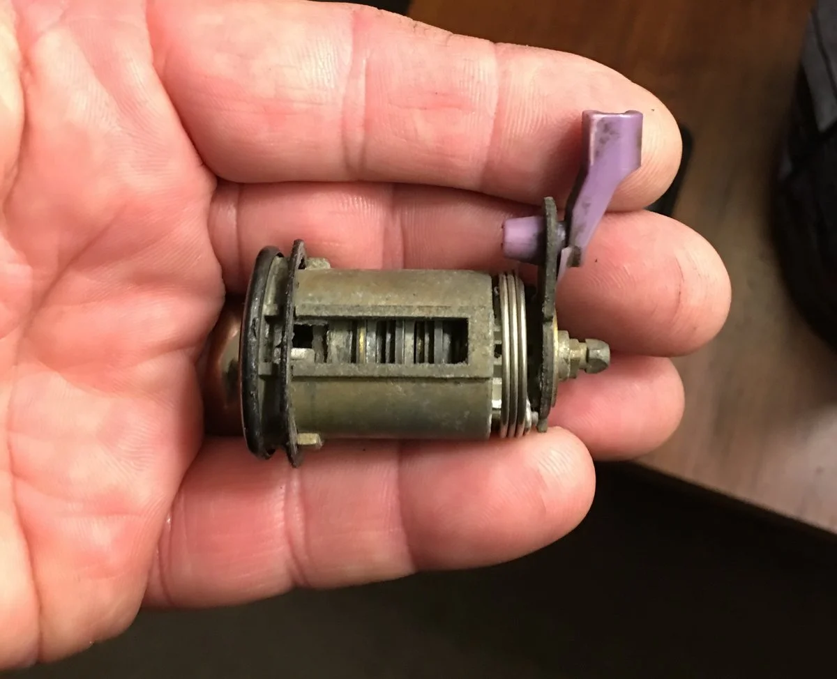

They are different size. My '97 came with half doors. I bought full doors from a later model and planned on swapping the locks so the ignition key would work with the full doors. Realized the issue so I've been using two sets of keys in the colder weather. I'm gonna try to rekey the full doors someday. It's on the list.

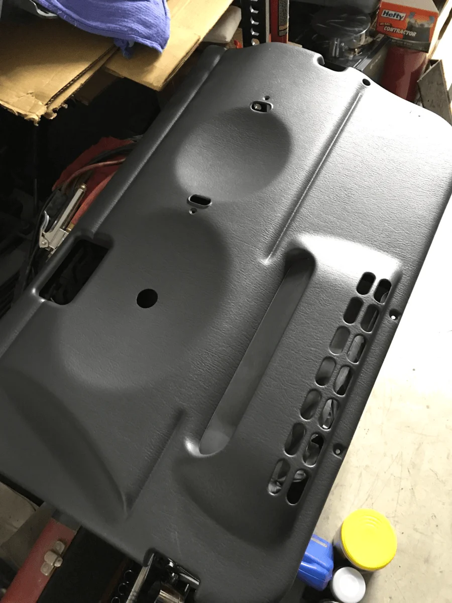

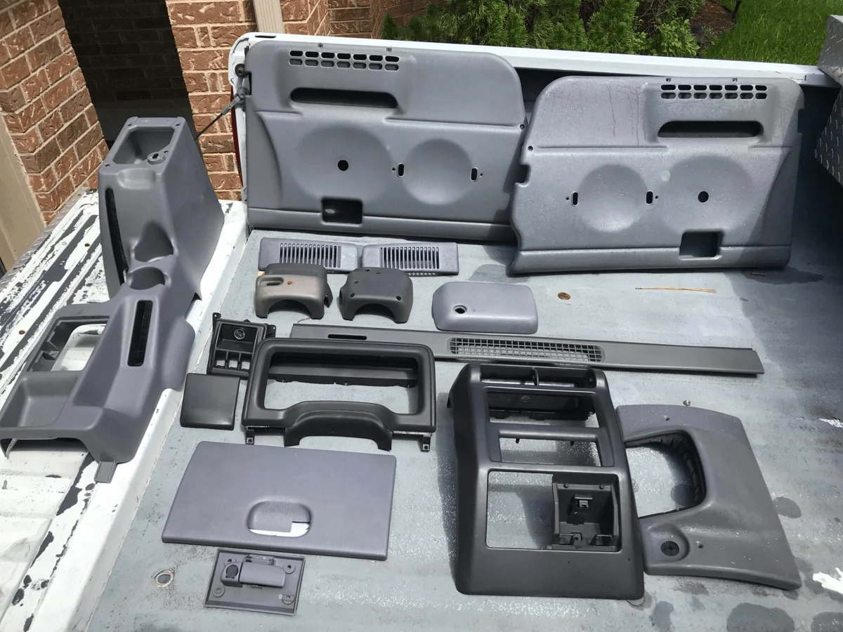

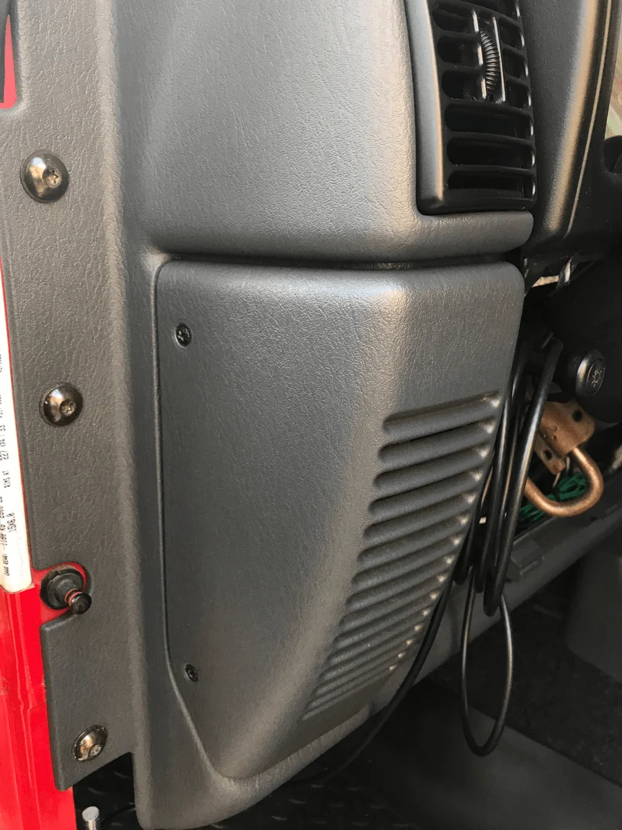

Here's all my old, faded stuff removed, washed and drying in the sun.

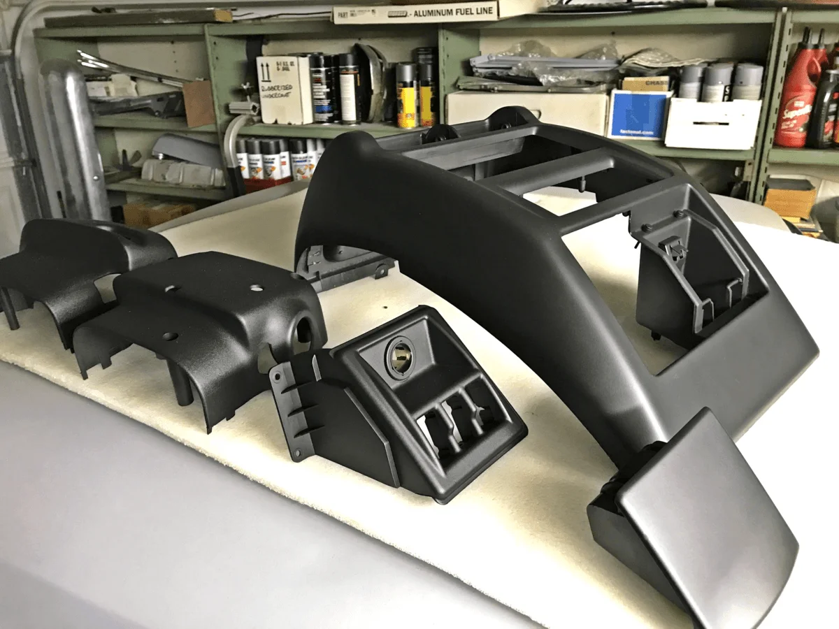

SEM Color Coat 15303 Graphite to replace the original light gray parts.
SEM Color Coat 15243 Satin Black to replace the original dark charcoal parts.
Reinstalling in Jeep. Note: I was not trying to match anything original or factory. I just wanted to revitalize my old faded parts with a new look (but keep it factory-looking if that makes any sense). Also, I did not use any kind of primer nor would I only because I don't think it's necessary for one and second, I don't like the idea of too much paint on top of the plastic. The adhesion promoter is responsible for the paint to adhere to the plastic.
Any kind of fade, marks, etc. is just in the photo. The SEM layed down perfectly and smoothly with no splotching, etc. I put about 3 medium coats on each panel in all. Also, I used either the SEM adhesion promoter OR the bulldog adhesion promoter on a particular panel. Not both together on a single piece. Just clearing that up.
Reactions: MountaineerTom

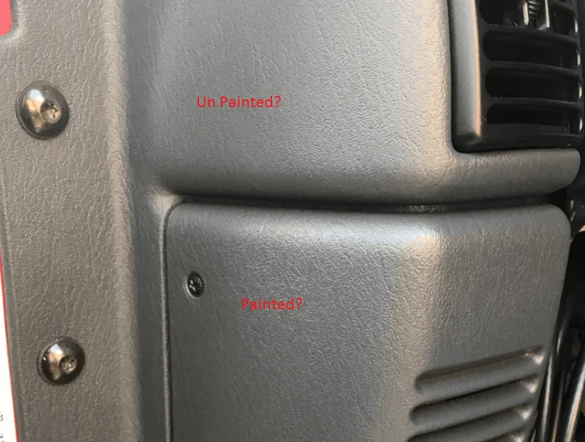

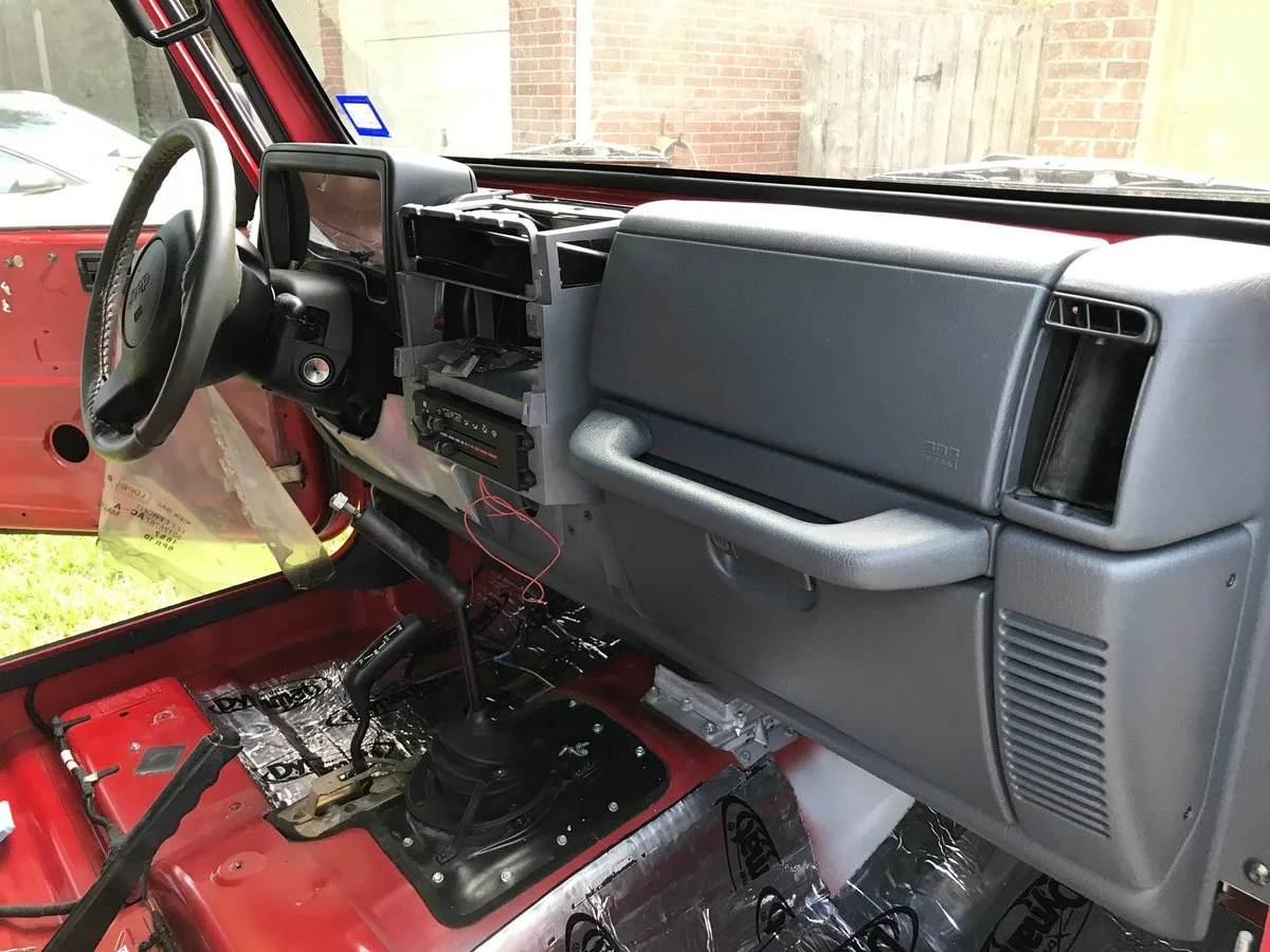

I didn't see the actual dash in the pics of parts that you were prepping for paint, so I have to ask is the pic below a painted part next to an unpainted part? I am wondering how close the SEM 15303 is to the original dash color.
Reactions: RussTJ
Also, what year is your jeep? we have 99 with the lighter grey panels. Looks to be the same as yours, but wondering if there was a panel color change an any point for the light grey?

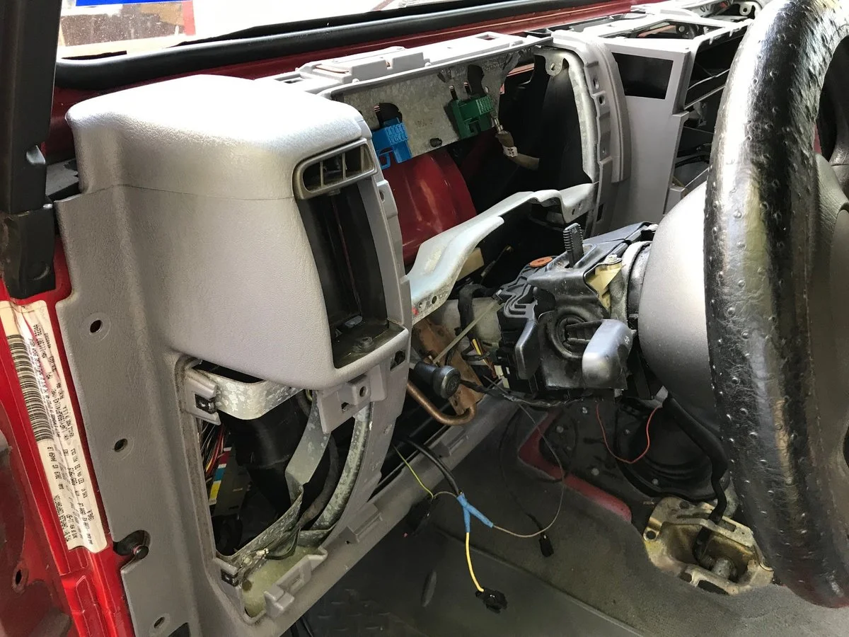

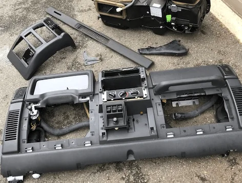

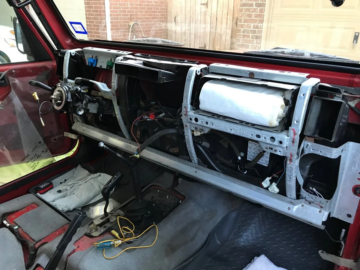

My Jeep is a 98. I removed the entire dash to paint so everything is painted. What was once the light gray is now graphite and the darker gray/black parts are satin black. I looked through my phone but don't think I took one with the main dash being painted while sitting on the tailgate of my pickup. I do have sort of a before, during & after of it attached.
Thanks, Our dash is much darker (close to your final color). Was there a color change for grey or was there always a darker option and that is what we have?
Our dash looks good, was hoping to not paint it, but the door panels need to be painted for sure. I guess I should just start with them and see how close it is to the dash.

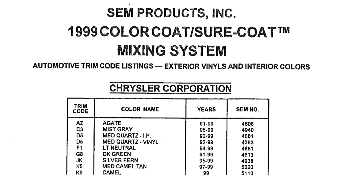

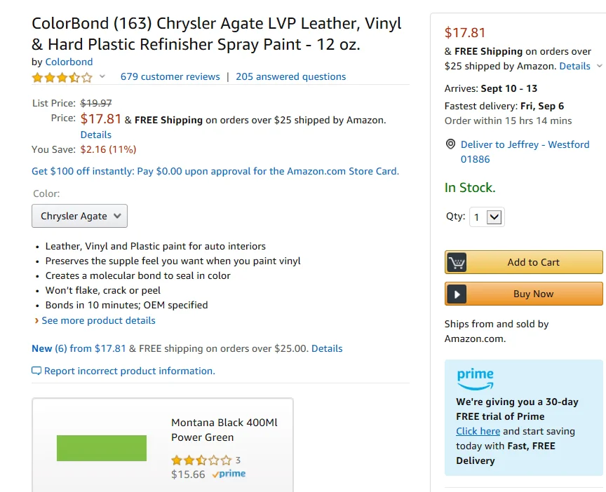

So I just looked at my VIN spec sheet and there is one line that says "Agate" So would this be the correct Colorbond product:
Honestly I can't help with any color matching. Since I was painting everything I didn't care about matching and wanted to go darker anyway. If you're matching then you'll have to order a little and do a test.
Anyone know the correct SEM Color Coat or ColorBond number for 1999 Agate?
SEM shows 4608 that I can't seem to find anywhere:
