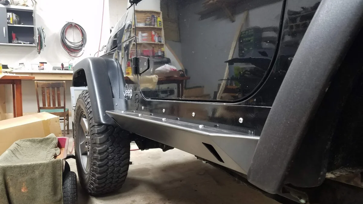

I used Rustoleum bed liner on my flares, and it has held up VERY well. I painted them three years ago, its still holding on and not chipped.

I really like the texture it gave me. Here is kind of a close up of my rear flare. Its a pretty fine grain. Clean up nice, too. Its not something you're going to hit with Armor all and make shiny though. It a matte finish.

When I did my flares, I scuffed em with a green scotch bright to smooth em out and give the paint some "tooth" then I cleaned them real well with dishsoap (an excellent degreaser) and let them dry in the sunlight. Then right before the adhesion promoter (rustoleum) I wiped them down with Rubbing Alcohol and a microfiber. Follow the directions on the can of adhesion promoter and apply your topcoat in the correct time window. I used Rustoleum bed liner on my flares, and it has held up VERY well. I painted them three years ago, its still holding on and not chipped.

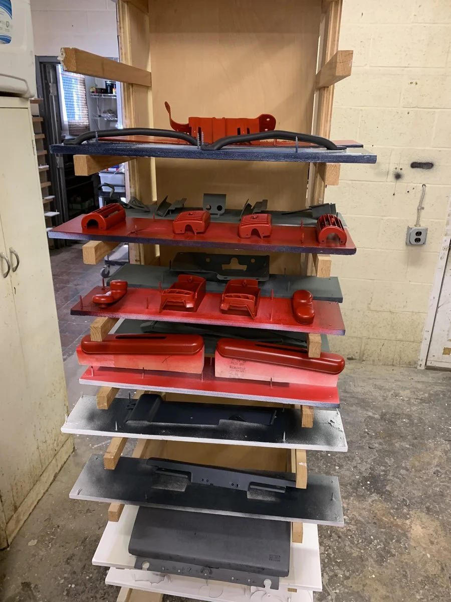

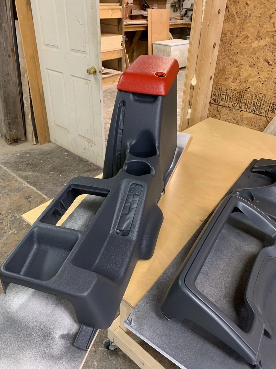

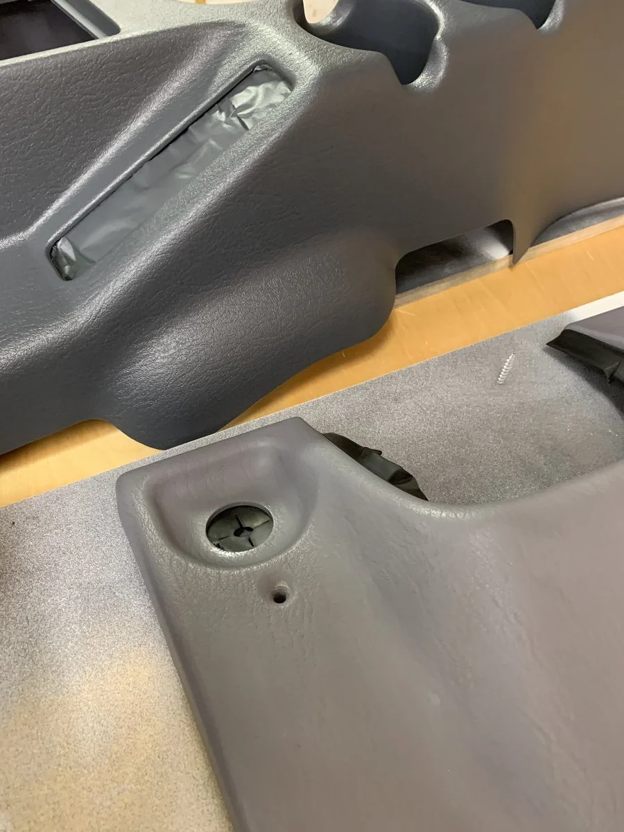

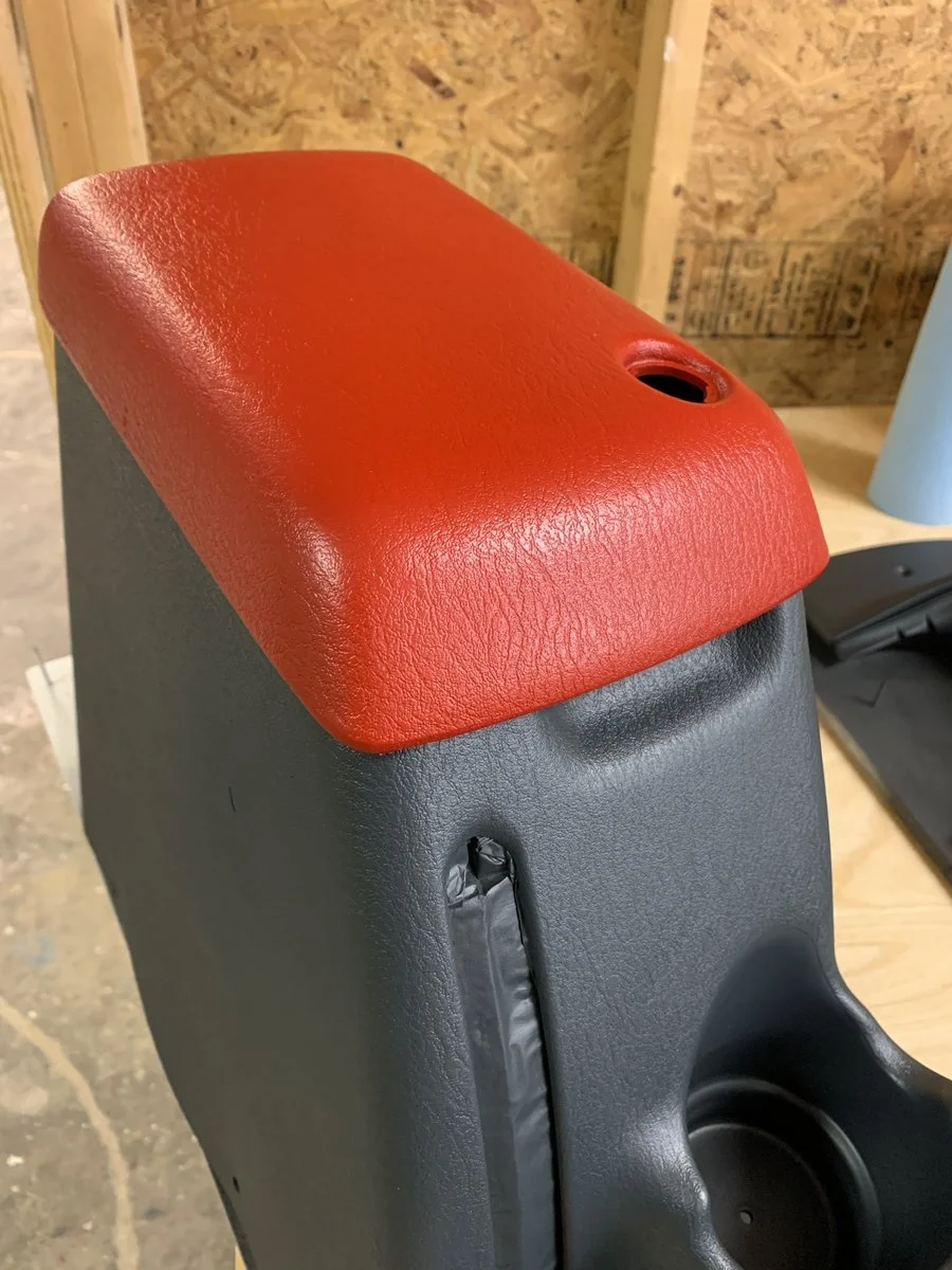

I just did my interior with SEM. I used the sand fever adhesion promotor and it worked really well. I have a 97 with the light grey interior. Wanted to make it darker and add red accents. The sem laid down really well (I did use a spray booth which helped). The grey took 3 coats for perfect coverage. The red took 6-7 for full coverage. I haven’t gotten to the door panels yet, but I used 4 cans on the dash and center console. Make sure you get vinyl prep if you are doing the vinyl wrapped parts too.
The one pic shows the faded light grey against the new dark grey. Drying racks show all the little parts (there are a lot)!

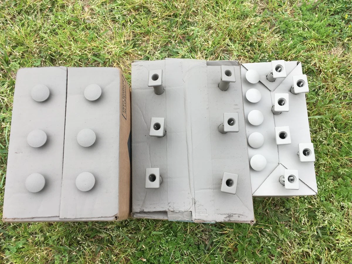

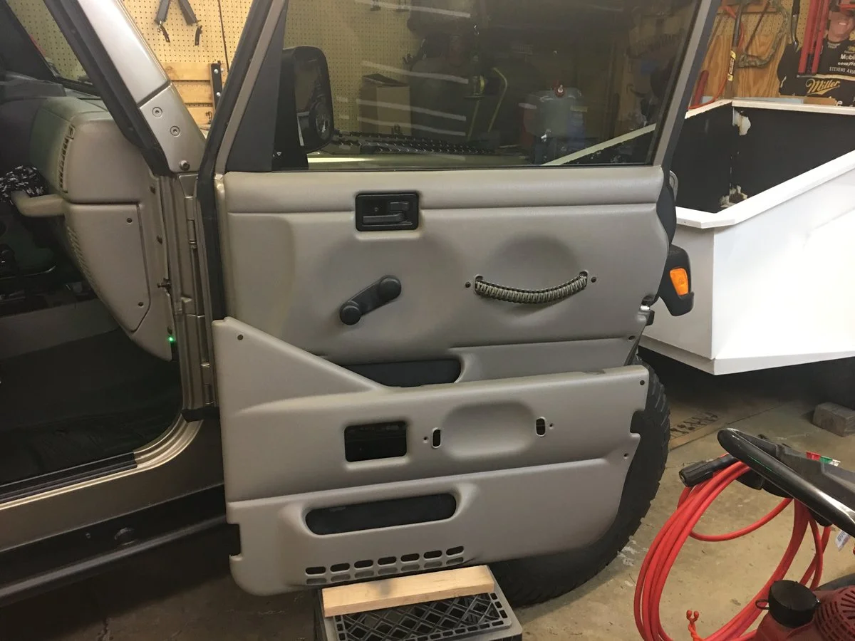

I got some cans custom mixed from Vinyl Pro in the SEM 5545 instead of the SEM 15833 that I bought from Amazon. I thought they were the same, but the 15833 from Amazon was lighter colored. The 5545 is spot on in my opinion.
I just painted these half door panels with SEM 5545 from Vinyl Pro next to my OEM Khaki full doors.

This is a comparison of some small parts with SEM 5545 on the left and middle boxes and the 15833 from Amazon on the right box.
This is a comparison of some small parts with SEM 5545 on the left and the 15833 from Amazon on the right.
SEM 5545 on the left and 15833 from Amazon on the right-- What about the middle??
