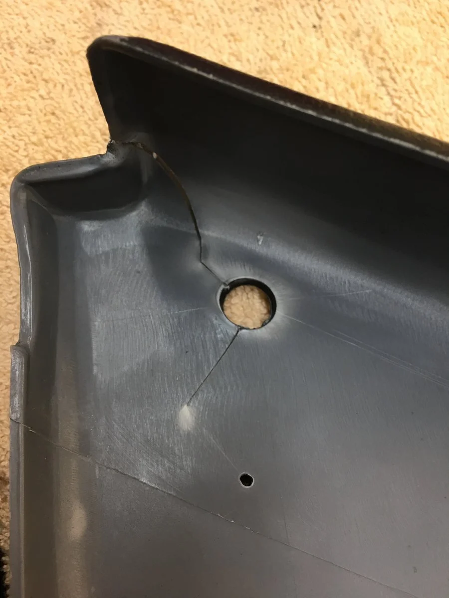

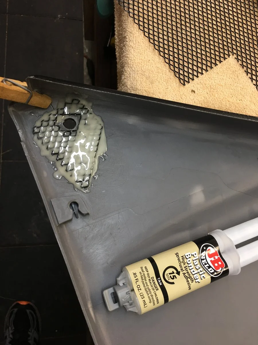

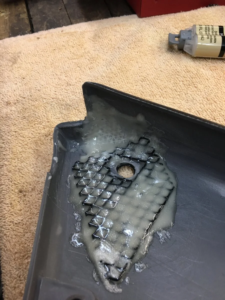

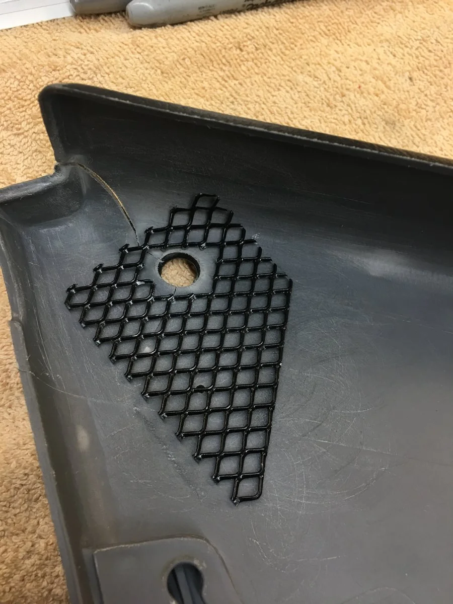

Started on some door panel crack repair since I was off work due to Hurricane Dorian. I drilled a small hole at the end of the crack to keep it from spreading. I was going to use some thin aluminum to make a backing plate, but remembered I had some of this gutter guard so I used it with some JB Weld plastic bonder. I roughed the area up first with some sandpaper first. Going to do it in steps, so we'll see how it works.
I was planning on using epoxy with some dry wall mesh tape behind my door panel cracks. Is the aluminum needed for support/rigidity?
I think I’m going to try the drywall mesh tape on the remaining part of the crack due to the curvature of where it’s at. I figure it will be easier to shape and work with.
Reactions: JMT
Self adhesive drywall mesh with aluminum is definitely the way to go. Much easier to shape and form.
Reactions: JMT and zebra12

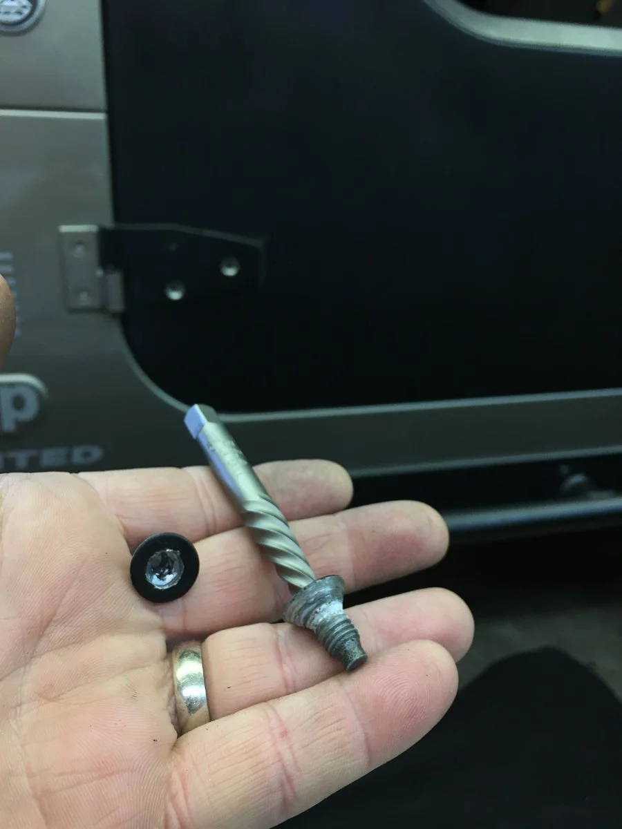

Setting the hinges before getting my buddy to paint the doors. The last two screws wouldn’t budge. Heat, Kroil and eventually an easy out for them out. Now I’m on hold until the new screws come in.
