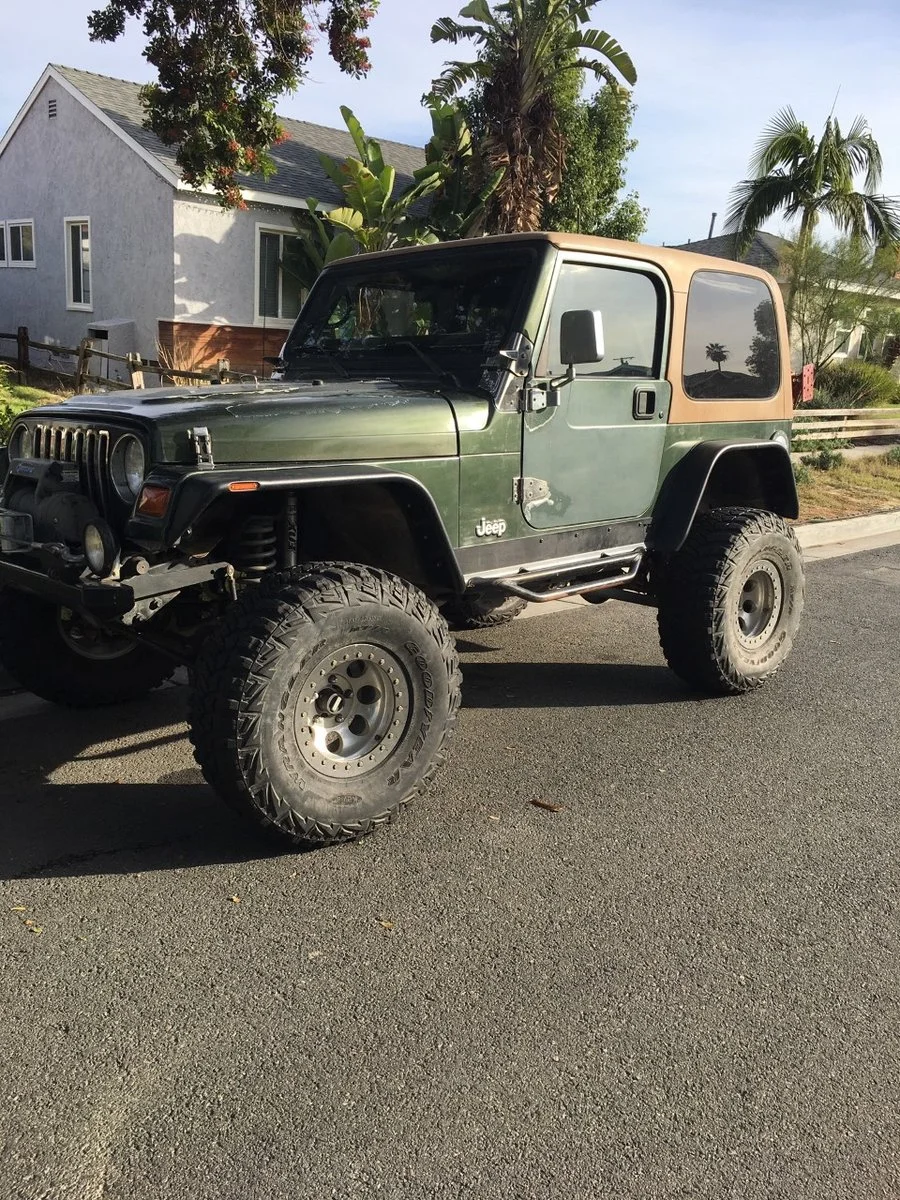

About 3 months ago I decided to get back into it and started looking for a TJ since the toyota stuff as all getting pretty old and harder to find. I ended up buying this thing from a friend of friend...who hadn't built it, but had taken it on trade from someone who owed him money several years earlier. It looked like it had a bunch of good stuff on it, and the price seemed good, so I bought it.
One reason I chose a TJ is because I've known Blaine for a lot of years now and figured he'd have answers to all my questions...which he has. I'm a mechanic by trade, and do lots of machining/fab work on the side, but I wasn't familiar with TJ specific stuff.
So, After I got it home I called Blaine and told him all about my new toy and what parts were on it...some of which he told me was garbage and needed to be changed...
It's a 97 Sahara 5spd w/ hardtop and full doors

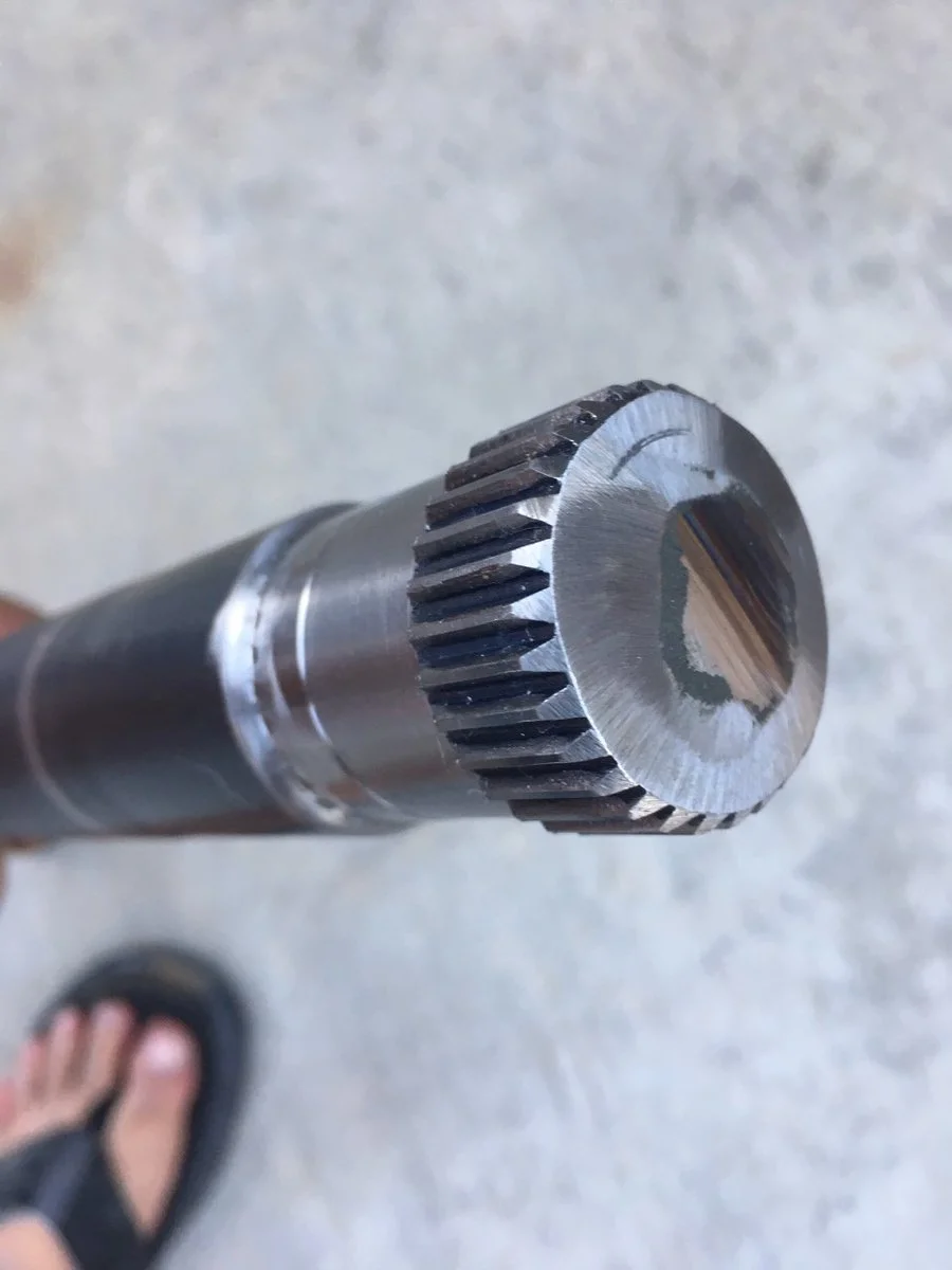

While going back together, I noticed that there wasn't really anything to hold the outers in the spindles, so another call to Blaine was made. Evidently there's supposed to be a splined washer and snap ring on each side....nope, not present...and while fiddle fucking with things I noticed the spindle lock nut could be unscrewed by hand. Someone had torqued the inner nut, that sets bearing preload...to about 100+ lb.ft, and left the outer nut finger tight (kinda backwards), so that got torn down to reveal some very special colors on the bearings.
Ordered up washers, snap rings, bearings, and seals...installed the new shaft and got the front end all put together the next week, along with new O-rings to seal the locking hubs...that were missing. The last thing to go on was the steering damper, who's bracket came with the currie correctlync instructions, which I decided to read, focusing on the part where they talk about overgreasing the joints and pushing the caps into a dome shape resulting in a floppy loose joint. I grabbed the old TRE that I'd just thrown in the trash and sure enough...dome shaped, so I put it on the press and smashed the cap back flat again...nice and snug now...just like that new one I just spent $80 on. Dammit, oh well, throw it in the spares pile.

Trans shifts nicer now, exhaust doesn't rattle now, Jeep goes in a straight line now, turn signals work, flares look good, splines on drivers side inner front shaft won't strip, bearings won't grenade, battery and electrical system works as it should and the tires are mostly round. Its actually pretty nice to drive now.
Hopefully I'll get it on the trail soon.
And one of these days I might repaint the hood and the doors, but I don't care right now.
Too be continued....
