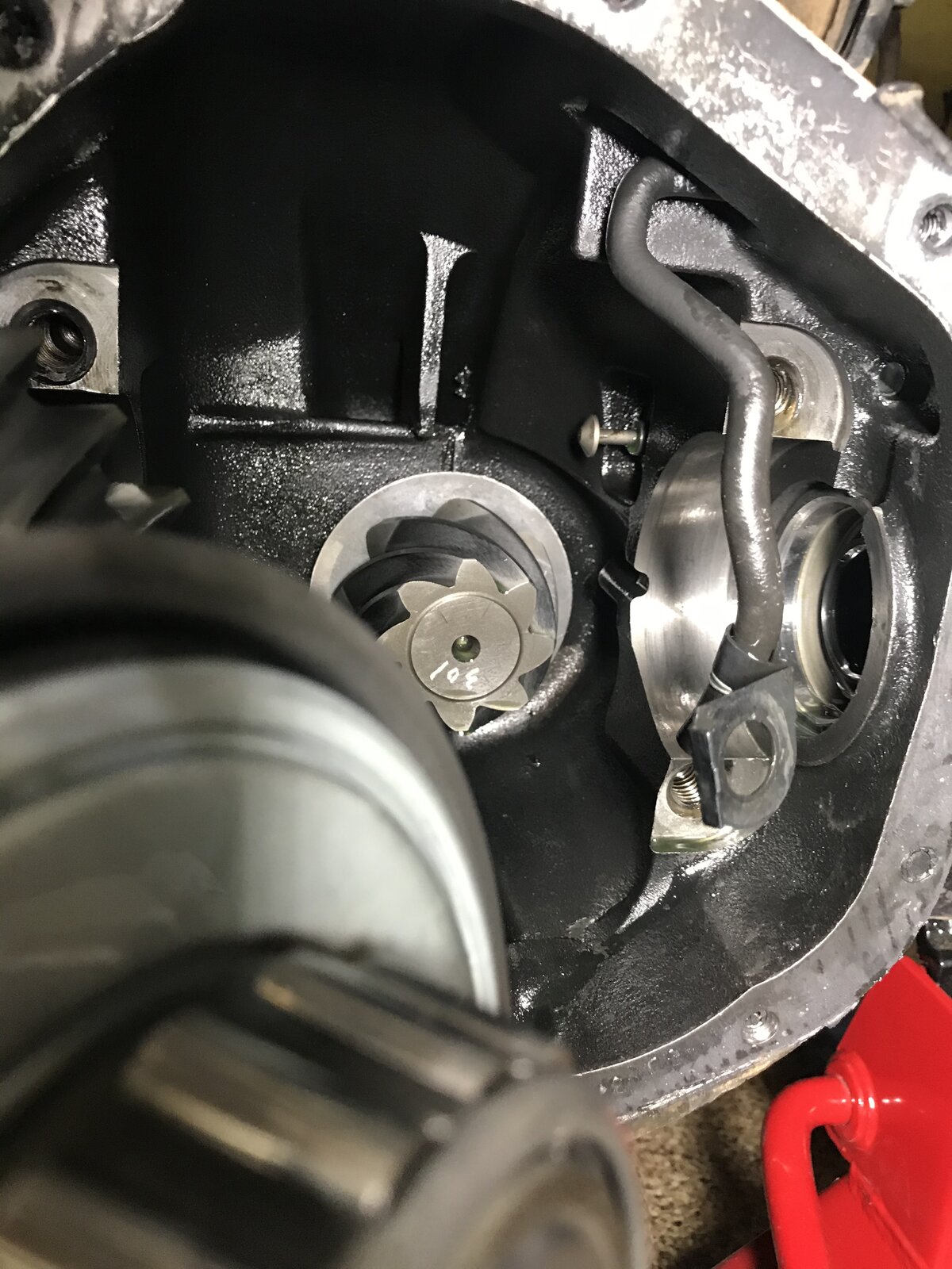

Please help me identify my front locker
AussieNick
Aug 19, 2019
361
San Diego
PO told me he installed e-lockers into front and rear Dana 44’s and regeared to 4.56. This the front diff. Is that a vacuum hose going into the bearing cap? The e-wiring is at the back of the diff. What’s going on here?
Oem rubicon locker. The electrical at the back is just a position sensor to tell if it’s locked.
Reactions: AussieNick
@Jerry Bransford or others, what is the “golf tee” trick with the position sensor? I saw it referenced but cant find the details. I don’t understand how that sensor moves.
