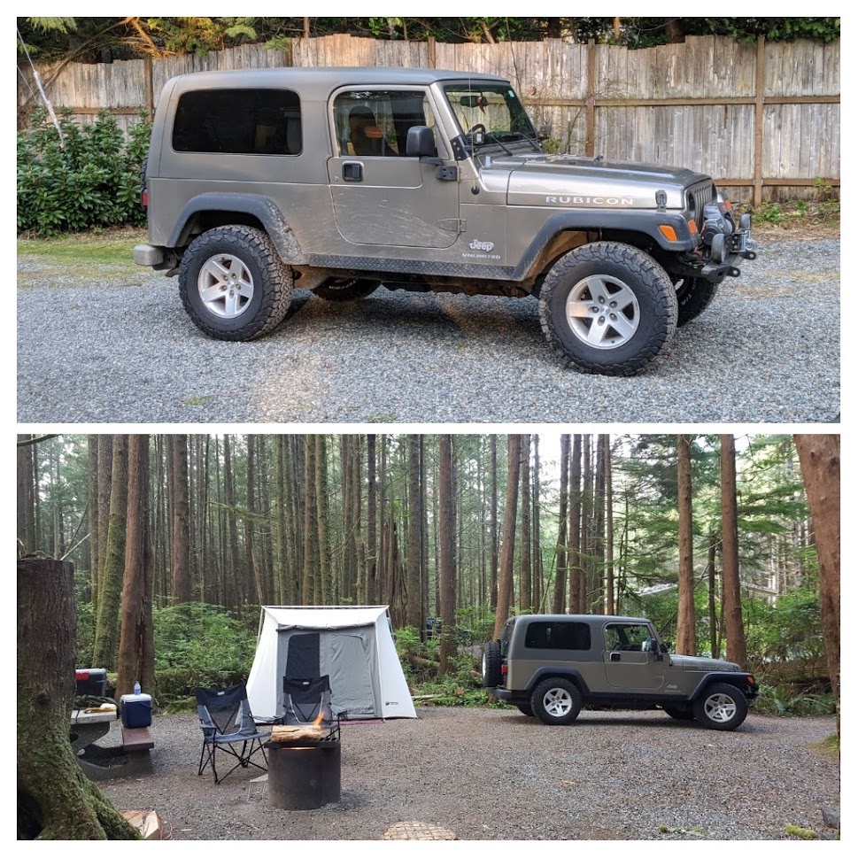

Mostly stock on bottom( has gas tank, front bumper and winch)
Top is current (265/75, RC2.5 lift(wife tried to buy me a nice present, she didn't know))
