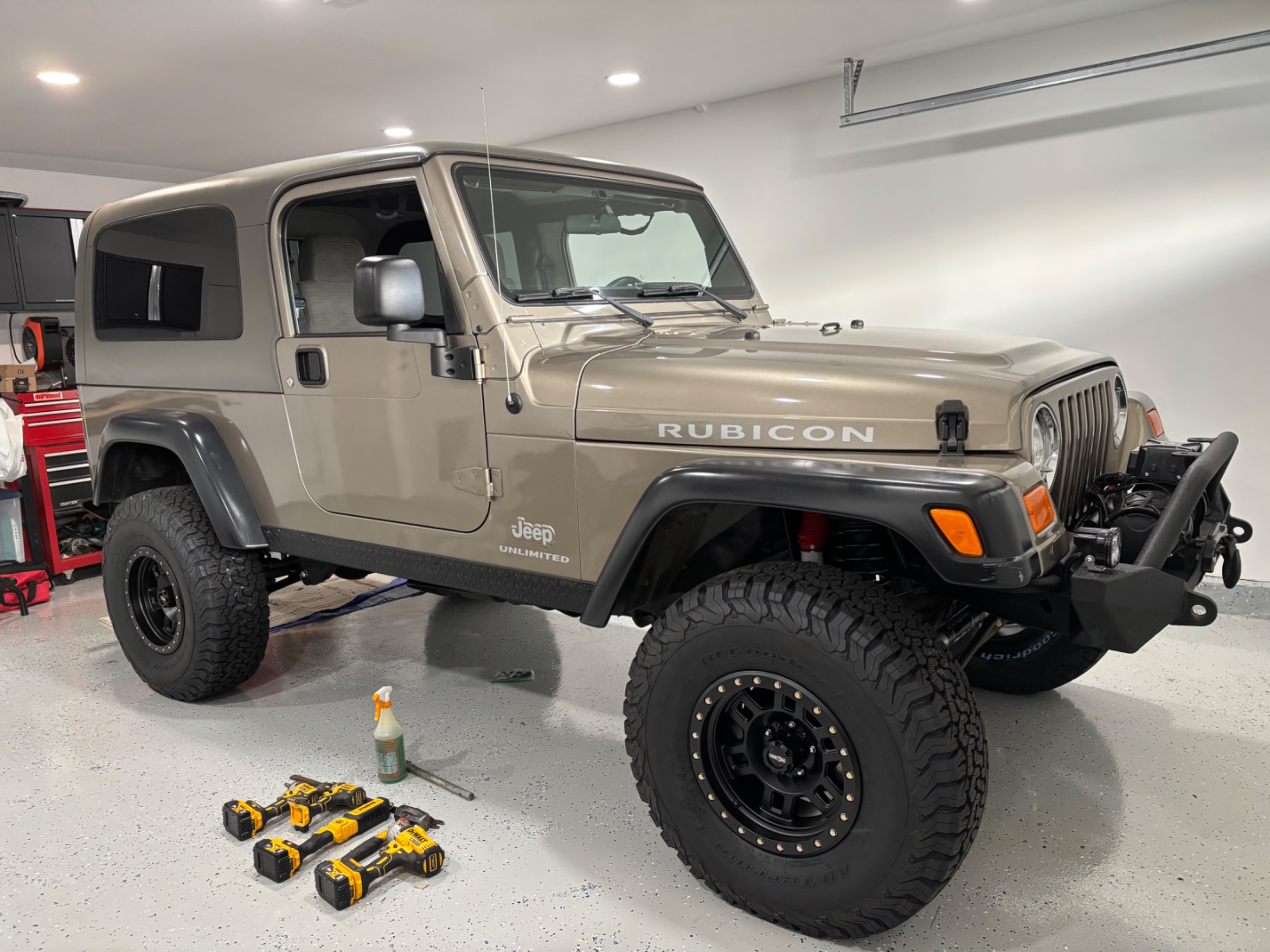

Good morning,
I Just finished installing the RockJock 4in lift on my 05 LJ Rubicon with 33x10.5x r15 wheels. I followed the instructions on their website to a tee, double checked all bolts are tight, greased all bolts, measured the pinion angles, and have a rear Double Cardan driveshaft ordered from Tom Woods.
The rear pinion I have set 1 degree lower than the driveshaft angle. Pinion 10.5 degrees, Driveshaft 11.5 degrees
The front pinion I have in line with the driveshaft. Pinion 8.5 degrees, Driveshaft 8.5 degrees.
Besides getting an alignment, anything else I should check before I drive it? I didn't touch the steering at all but just visually looking at the front tires it seems they are no longer both pointed exactly straight and the steering wheel is all out of alignment which im assuming is because the lift? Let me know your thoughts are and if anything else comes to mind to check before driving it to the alignment shop. I appreciate any advice!
Thank You!

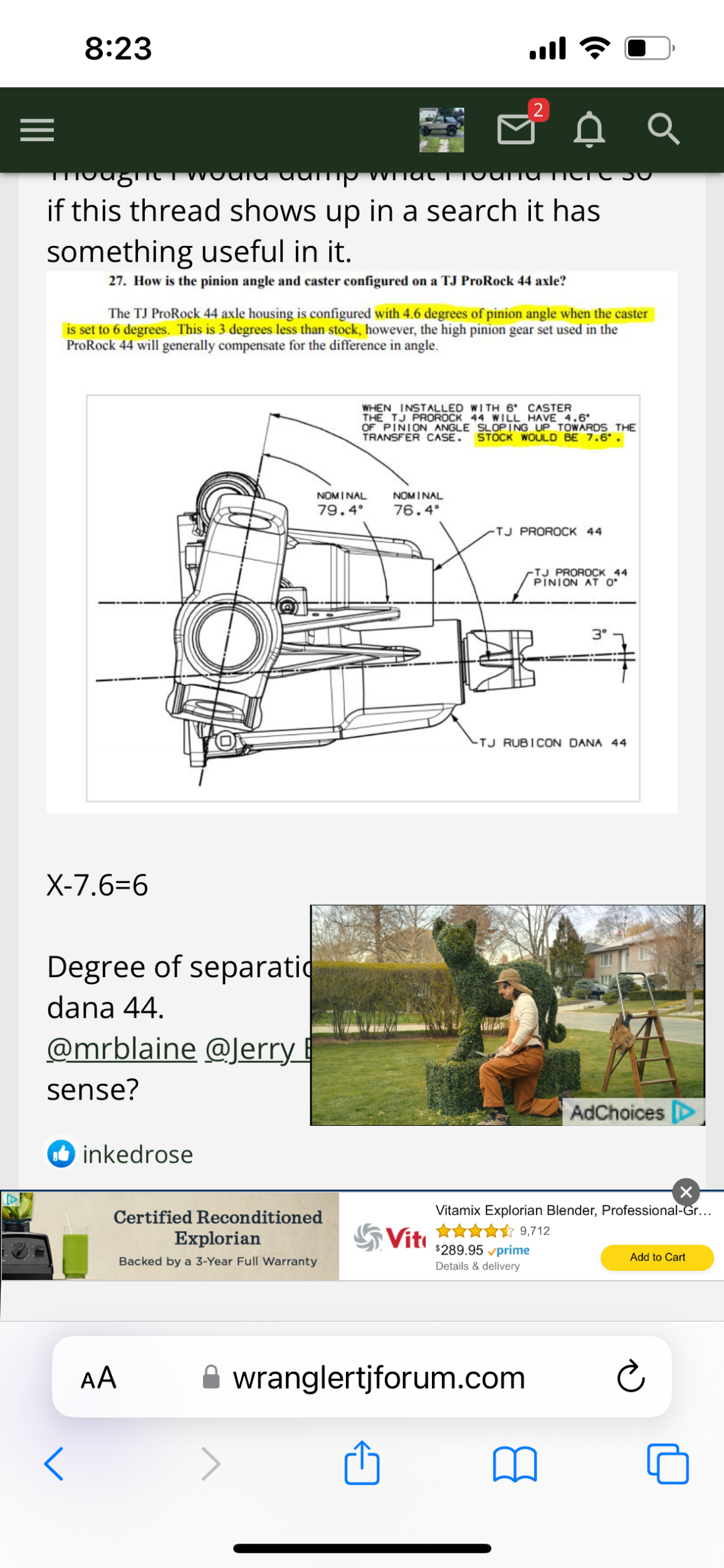

Did the garage DIY alignment after reading the posts. Can you explain in detail the caster? Ive done some extensive research and understand you do 12- pinion angle to get the front caster. If I did that 12-8.5= 3.5. I read that you want it to be near 5-5.5, the thing I don't quite understand is how to achieve this without changing the driveline/ pinion angle? Unless the angle is different for a dana 44?

You sort of compromise between the caster and not having driveline vibrations.
On same setup I ended up being able to get about 5.5 degrees caster. I believe the 44 front is actually 13.6 degrees offset. I found this diagram when doing mine which helped to clarify. In the end I ended up just setting it where it worked right.

While you can set it that way I would actually see what your caster is at, which can be easily checked with an angle finder at the machined spot on the inner c.
Low caster will have a vague return to center with the steering wheel. Proper caster will affect the pinion angle. Adjust one and you adjust the other. With pinion angle you just want to make sure you don’t have any driveline vibrations so there is some wiggle room. There is no perfect pinion angle number other than no vibrations.
