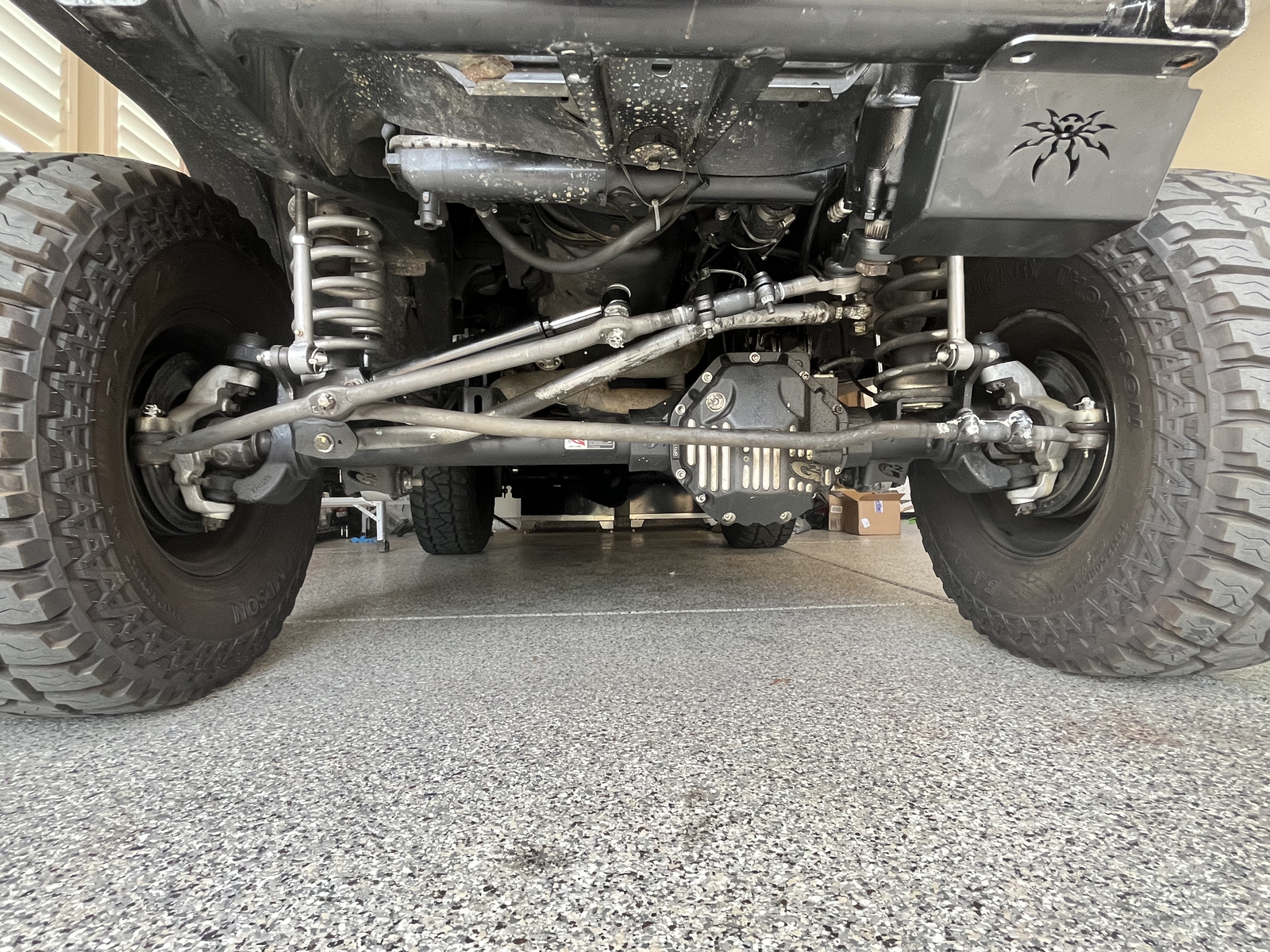

I though I had a sloppy ZF steering box and just swapped to NEW lares. Now the Lares is acting precisely like the ZF I pulled out... My thoughts are ,that since the adjuster makes no difference, that the power steering pump does not give me enough pressure to the box to make my steering not sloppy as it has to push my ZJ linkage and upgraded knuckles. I use to have pin sharp steering with 33's and 3.5 inch lift, but i swapped to dana 44 and Dana 60 rear and ZJ tie rod/linkage that's heavier and my steering has been sloppy since then. Make me miss the old dana 30 and factory linkage. Anyway I might try this PSC Pump.
Steering response won't change due to swapping in a front axle. What does change is how you set up the steering on the new axle. Post up front pics so we can see what you have.

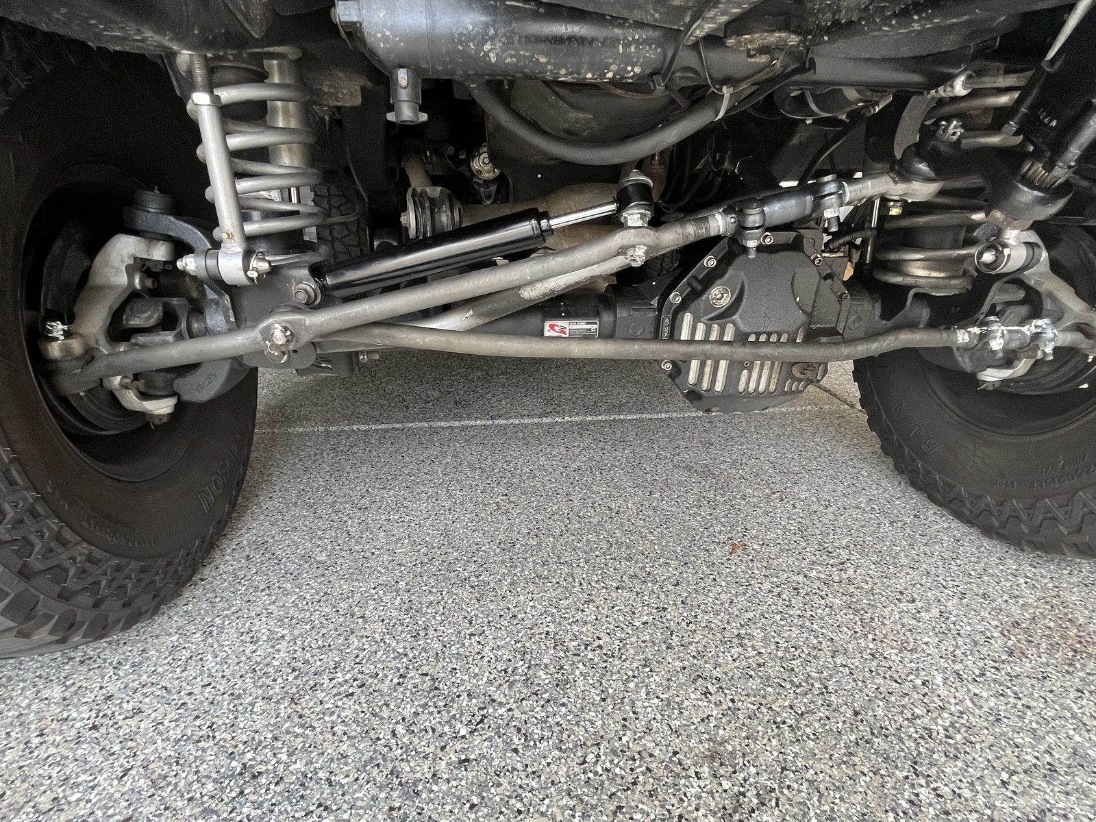

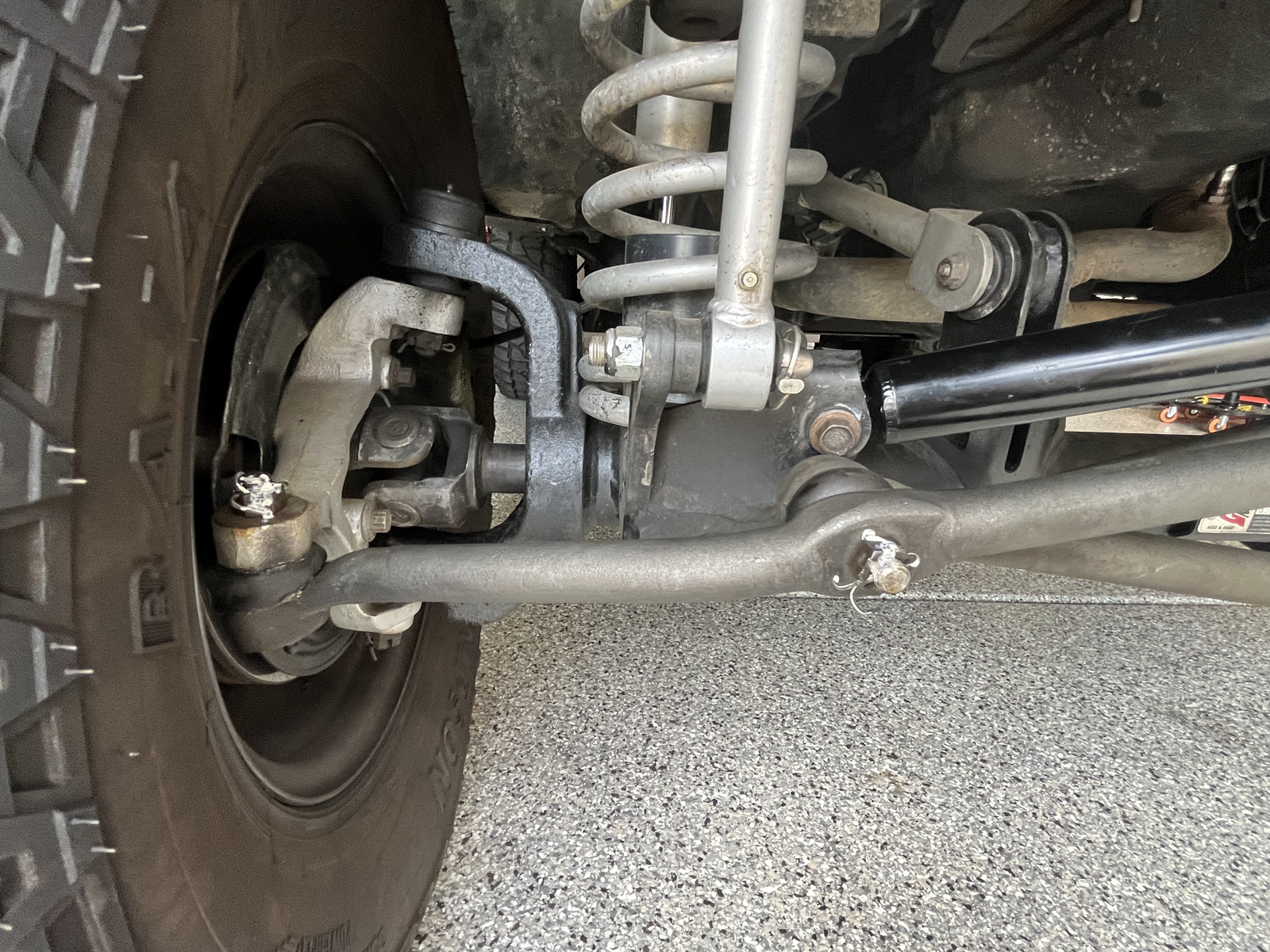

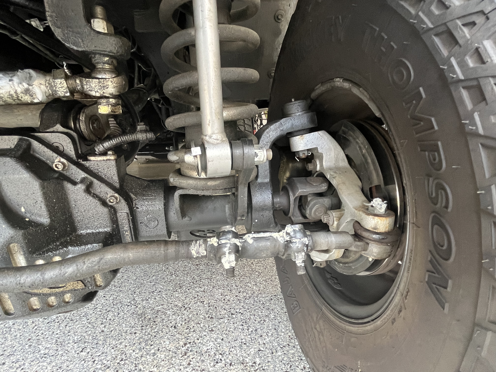

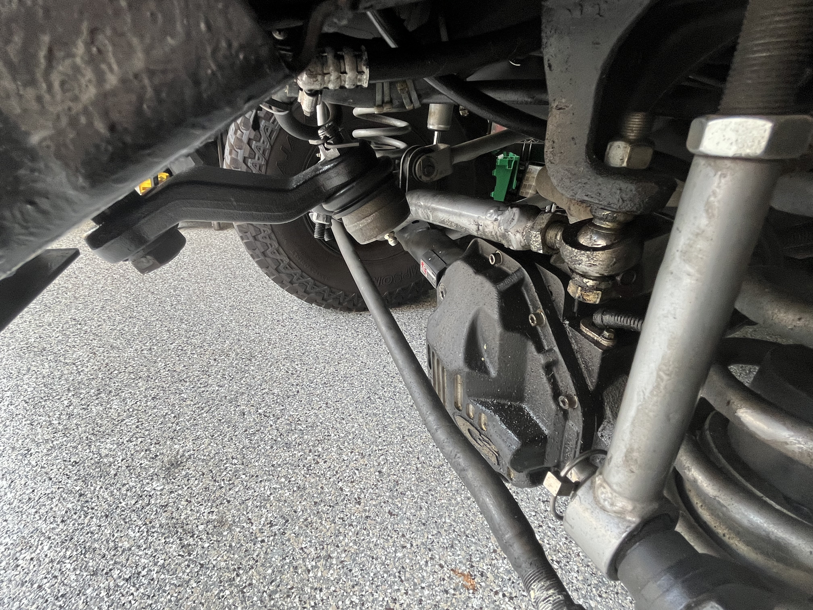

When I swapped axles i also changed from stock tj steering to the ZJ linkage from the guide on here. I had to get a custom rear track bar to fit the Dana 60. All tie rod ends are tight, only thing loose was the steering stabilizer wiggling from bolt/metal sleeve from the axle side mount, I took it out drove it, and put in a new one, drove it. no difference. Tightened the steering box 1/8th turn and it just felt overreactive when it got past the sloppy steering point, not fixing the issue, so I turned it back to the factory. Could it be my caster angle?
