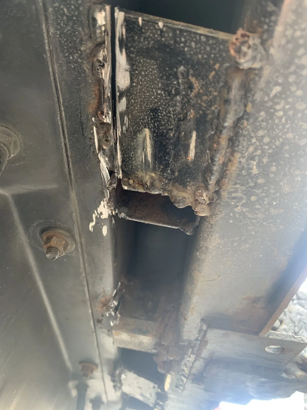

So this past weekend i bought a new rear bumper for my jeep , and i get home only to look under my old bumper and its welded on there? Anyway i’ve been going at it with an angle grinder for a few hours now but i can’t get it to budge. Any tips?
Get a Diablo blade for thick steel, cut the bumper loose from the extensions and then go to work on the pieces that are left. But, just by the fine quality of that boogerwelded shit, I'm surprised you can't just kick it loose.
Yes, yes it is and I promise like every shit welder everywhere, whoever did that uttered the words, "my welds ain't pretty but they never fail" at some point right after he splatted that mess on there.
Damn I get mad at my PO every once in a while and then see something like this and think "alright I'm not as mad now!" X2 on the diablo blades, those things are another level. Grab a couple of them though, I burnt through several a couple years back cutting the LCA bolts off of a 3rd gen Cummins but they're the only thing that did the job.
