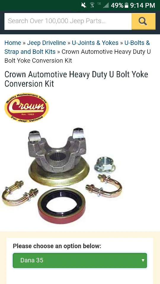

Would this be a good replacement
Sent from my SM-G930V using Tapatalk
So, what exactly happened? Sounds like the straps broke, then the rear end does not roll forward, then you have removed the yoke?? Can you spell it all out so we can help you correctly?
Would this be a good replacement View attachment 31848
U-bolt conversion kits are not recommended as it's WAY too easy to overtighten them and crush the bearing cups which will ruin the u-joint bearings. Not to mention there's really no need and no benefit to converting from straps to u-bolts. The straps are not really holding much, it is the yoke the u-joint sits in that takes all of the stress. The strap's only job is to keep the bearing cap seated fully down into the yoke so the yoke can hang onto it.

Gotcha. It does not roll because the pinion is now loose and hanging up on the carrier, so don't force it. The yoke you posted will work fine. Like Jerry eluded to, do not over tighten the u bolts. Of course you need new u joints and a check of the shaft for damage and balance. Good idea to check the front shaft too.
