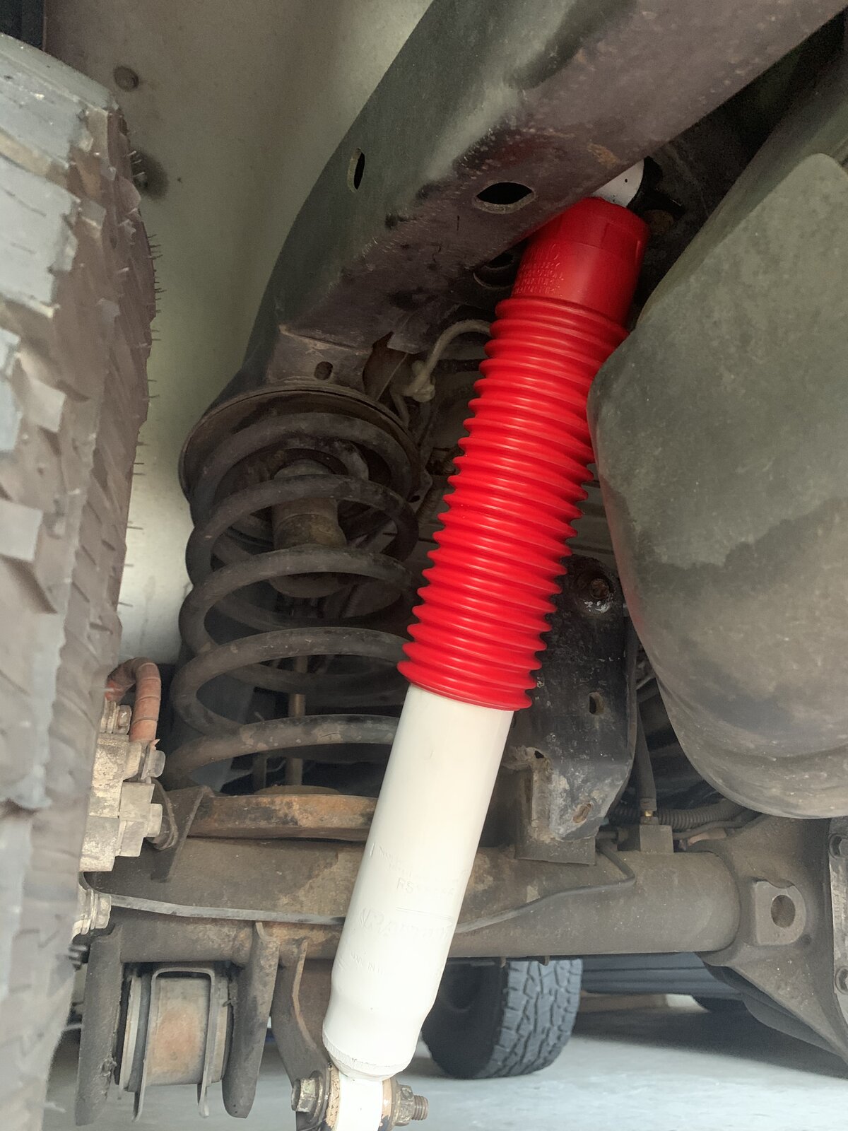

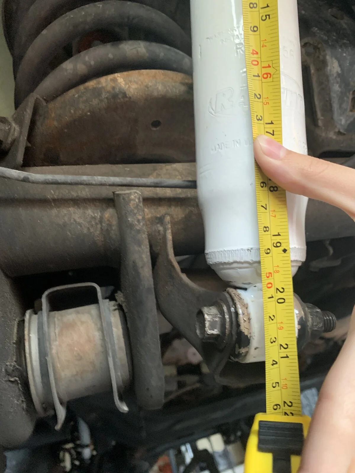

Ok so I wasn’t able to get back on this forum until now. I was unable to get the shaft length because the boots are extremely stiff to move out of the way.
But I was able to measure where it is sitting at right now. From mid-loop to mid-loop, it is sitting at 20.5 inches. According to the rancho website the extended length should be 24.67. And when the shocks are totally compressed are 15.01 or at least should be.
I took it to my mechanic and he was nice enough to help me out with measurements and told me everything looked good and to just add weight to the back of the Jeep however I wanted to know what you guys think. I measured the springs as well and it still gives a 3 inch difference compared to stock
Let me rephrase what my mechanic told me, he told me to add weight and go up and down curves and hopefully that would loosen the shocks up a bit but advised to contact rancho and 4 wheel drive about it and ask either way. The shocks just feel like have a lot of pressure and don’t compress.

Guys I will cut off the boots once I am sure nothing is wrong with the shocks. I came here for a second opinion since y’all are more familiar with the rancho shocks but I had my mechanic help me with the measurements and I was there and he showed me when he did it. I’m just looking for second opinions to try to understand if there is something wrong with my Jeep or the shocks or if anyone has experienced this before

I’m a woman haha! But yeah so when I drive on not very smooth roads going maybe frim 10-45 Mph it bounces. I also had 2 guys get on the rear bumper and they tried to jump up and down to see if it would compress and it just will not. It feels, bumpy/jumps a lot on the road when I know it shouldn’t. At least that’s not how the front shocks felt when they were first installed and they’re the same height and same model.

So then in my case, ride height dimensions is currently at 20.5 in. If the shock is installed (15.01 compressed length), then that would give me 5.49 inches of up travel and down travel.
This shock has a compressed length of 15.01.
this means that this specific shock with my travel height should give me about 5.49 inches to fully bottom out.
isn’t this theoretically speaking the correct shock for this Jeep?
I’m basing it off Rancho’s website

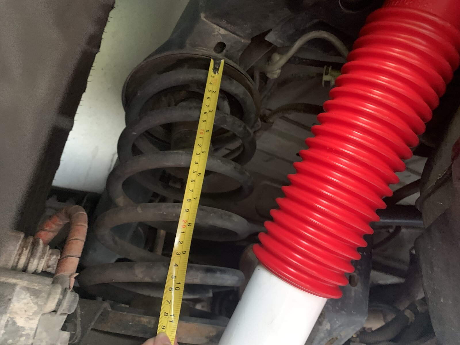

From what I have measured it has a 3 inch lift. If you look at the pics I posted, the Rear springs show 11 inches. The front ones show 15. I had already purchased the front rancho shocks in February and I knew it needed the rear but since Covid, I didn’t really move the Jeep for about 6 months or so (I’m a student so everything got canceled).
anyway the point is, I got the front one for a 3 in Lift, and same with the rear.
I did notice though that the 4wheeldrive website shows these fit a 3 inch lift in the rear but the rancho website says 3.5in for the RS5000x RS55256.
Either way... the measurements are correct if I did my math right. I just didn’t have an issue with the front ones (other than one is going bad already after only a couple of months of non-abusive use). Got to check the lifetime warranty on that. But they never felt like these.... now one thing to note is... the front of the Jeep does have more weight than the rear. I was told to add weight to the back. I added some concrete blocks and it’s a little better.
Something is binding or installed incorrectly. You should easily be able to push down on the rear of a TJ and have the suspension move. The shocks are the correct length or close enough not to cause problems and the chances of both shocks being defective in the same way is very small. You have what looks like a welded raised track bar mount in the rear. I wouldn't be surprised if something is binding or making hard contact where it shouldn't be. Maybe you need another set of eyes on that thing.
