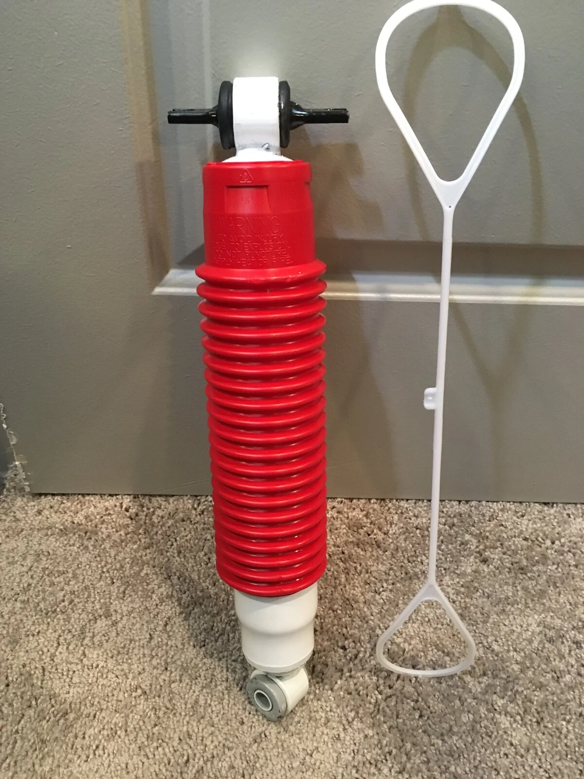

I don’t know if I mentioned this but according to the guys at the shop, when they first removed the zip tie from the shocks, they didn’t extend on its own to reach max extended length.
They had to physically pull the mid-loop on the shaft side to make it extend. In addition to that, when we did the measurements and disconnected the rear shocks, both shocks were stuck in that same ride height position. Once again they had to be pulled to extend them measure the extended length. When they were going to compress it and put them back in, they really struggled a lot to get them compressed. Both of them.

I called 4 wheel parts and they talked to rancho. They said to take off the lower mount and extend and compress the shock as it hangs a from the upper mount and do that a few times to see if it gets rid of any extra air that could be stuck and causing this. They said to make sure the shaft is in the upper side and the cylinder at the bottom (very important).

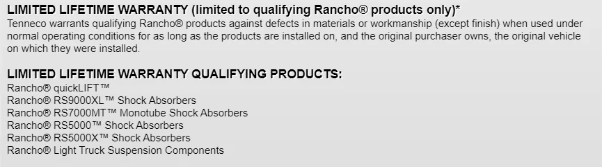

Just be aware, apparently they will not honor the warranty if you purchase from anyone else other than their authorized dealers regardless of proof of purchase and meeting all the criterion in the warranty guidelines. No...I'm not bitter.
Not that you should but you could go buy the same shock from a big seller like 4 Wheel Parts. Take it home, remove the bad one, and then return it for a refund at a later date. But, I'm not a fan of 4WP, so I don't care if you fuck them a tiny bit.

Update: I did what 4 wheel parts told me to do. The day I called them, they called rancho to verify if the shocks would work given that the rancho website showed they were for a 3.5 inch lift and the 4 wheel parts said 3 inches. Apparently, it can work for a 3-4 inch lift so that wasn’t an issue and measurements are correct.
I did what they told me to do, to remove the shock and compress and extend it a few times to release some pressure (important: shaft had to be facing up when doing this).
it was a little hard to do that since they were very stiff at first but after a couple of tries and a lot of force, it was possible to semi “loosen them up” a little bit, and any pressure/air that could’ve been inside. Got them back on the Jeep and now they work! I did notice one side does rub a little bit against the axle but it’s not much. I had an alignment done recently so I’m assuming they moved the axles quite a bit.
the jeep definitely rides a lot better after doing that to the shocks! The shocks were now extending on their own once compressed unlike before, they wouldn’t even compress and if compressed by force, they wouldn’t extend.

Maybe mine came a little too stiff from factory? I don’t know. I’m telling you mine would not extend on their own once the zip tie was cut off. They were VERY stiff and almost impossible to compress.
I went to my friends shop (the mechanic that installed them) and we both had to put all weight and force over the shock shaft and push it down to compress it. The shock shaft was facing up, the white cylinder was on the bottom (vertically) on the concrete. Some of the white paint definitely rubbed of but it doesn’t matter. We also used a ladyfoot pinch rolling pry bar, put it through the bottom hole to step over it when extending the shock back up.
