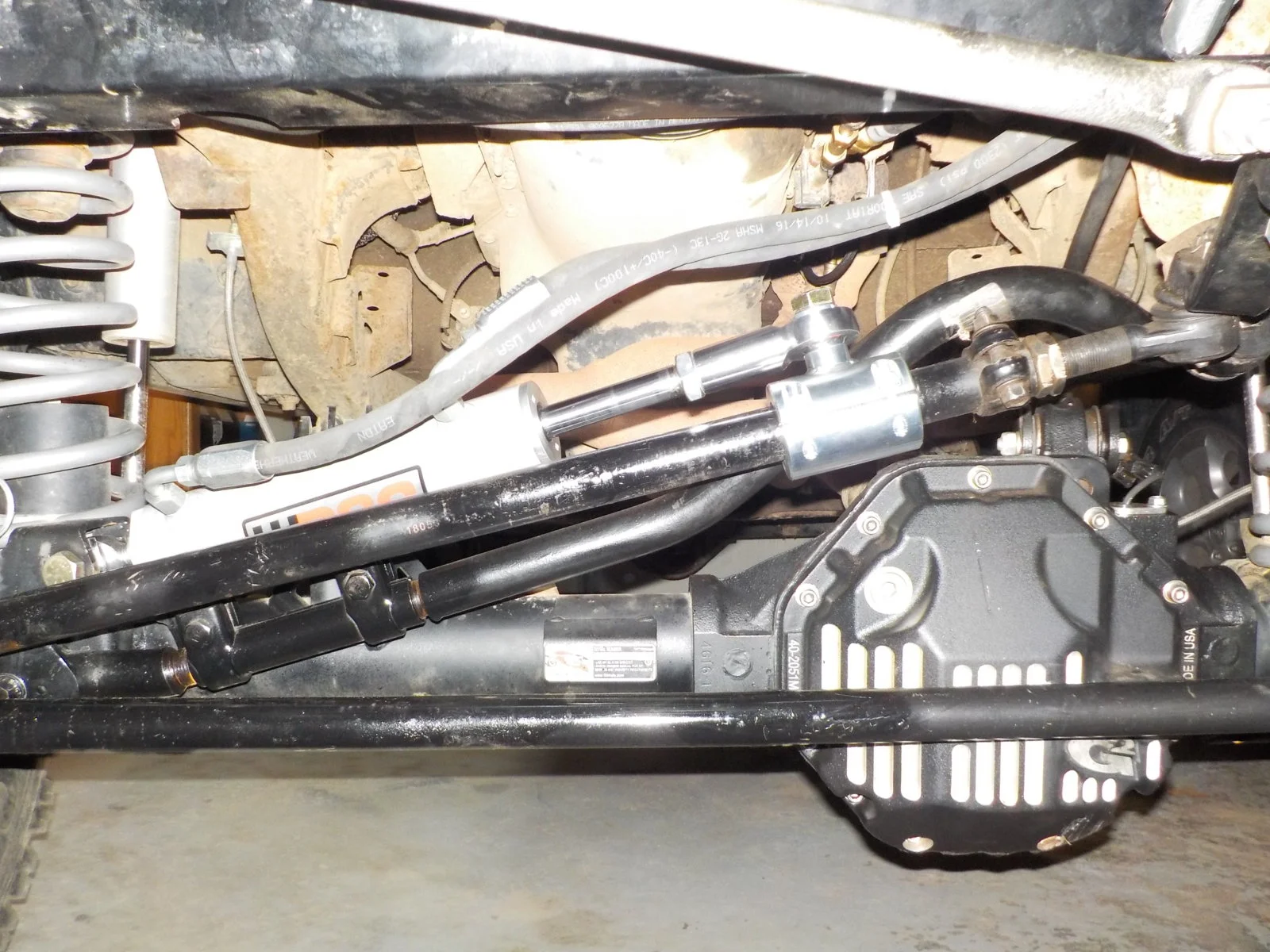

Watching this thread now as I just ordered the same axle. Curious about what the determination will be. What do you guys think about his steering box brace? Do you all think it's needed/good insurance?
I installed a steering box brace from M.O.R.E. onto my TJ and consider it good insurance. And while I don't recall specifically if I have helped with a TJ steering box having been ripped off its mount, I have had to help where a Cherokee's steering box had.
I just wanted to give an update on the steering issue I was having. I was able to verify that indeed the locker was locking the steering up but I have not pulled it to see why. I do know that when it does lock up, backing up a few feet unlocks it. I have installed a stage 4 steering assist kit and that changes the lockup scenario significantly. I can actually steer on a hard surface even when it is locked.
