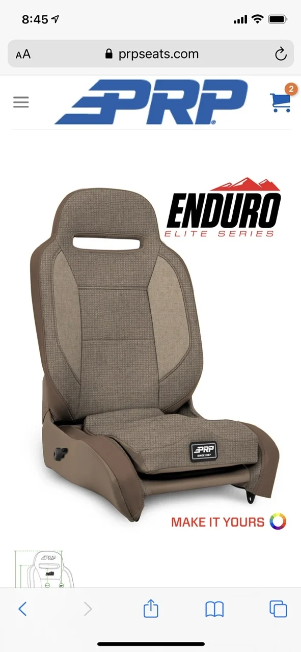

I didn’t order any leather or vinyl, I ordered tweed. 👍
ah same way im thinking of doing mine. Tweed in the center and vinyl on the backing.
I figured the tweed would hold up better and not get too hot when it gets in the triple digits wont get stank ass either lol
Reactions: Alex01
Wise idea! This is how mine will look:
I contacted them yesterday for a color samples, looks like I'll be going the Enduro Elites too. This is an awesome seat.
