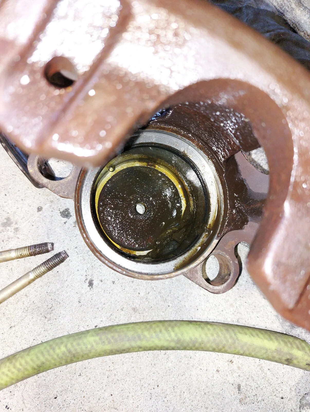

I get lots of calls from shops and a few owners who fully ignore our warnings to flush the brake fluid BEFORE you push the pistons in to install new pads. Across the board it is always the same, we never have to do that on other vehicles. While I do not know why that is the case, I do know that the TJ collects crap in the piston bore at a very prodigious rate. This is 3 year old or so fluid in a TJ that the owner takes reasonably good care of, it has reasonably low miles. Along with what you can see, there were also ridges of built up hardened crap at the end of the piston stuck to the side walls that would have trapped the piston hard and at least tried to ruin a set of new pads.

Sorry I wasn't clear. We warn folks to flush before they push the pistons in and get lots of disagreement as to why that is a caution. Last I looked it up, the service interval was every 2 years.
What I didn't know about was existence of the ridges of hardened material on the walls of the bore at the end of the piston. We had to chisel those out with a screwdriver and then wire brush them. Those being there would have locked the piston up and prevented the piston seal from doing its job of slightly retracting the piston when you let off the brake pedal.

Worse than I expected and both sides were the same.
That does pose a dilemma for us now that we see what is likely to be in the bores. Probably not a bad idea to start telling folks to take them apart and clean them out. I've got access to some good rebuild kits for them, that may be a good option.

I have a power bleeder and I use it to flush the brake systems on all of my vehicles. On vehicles with ABS, pushing the pistons in when changing pads can result in crap getting into the ABS pump which will really cause headaches, hence the practice of opening the bleeders first. European cars have always recommended brake flushing every 2 years and I think that is now what the domestic manufacturers are recommending as well.
