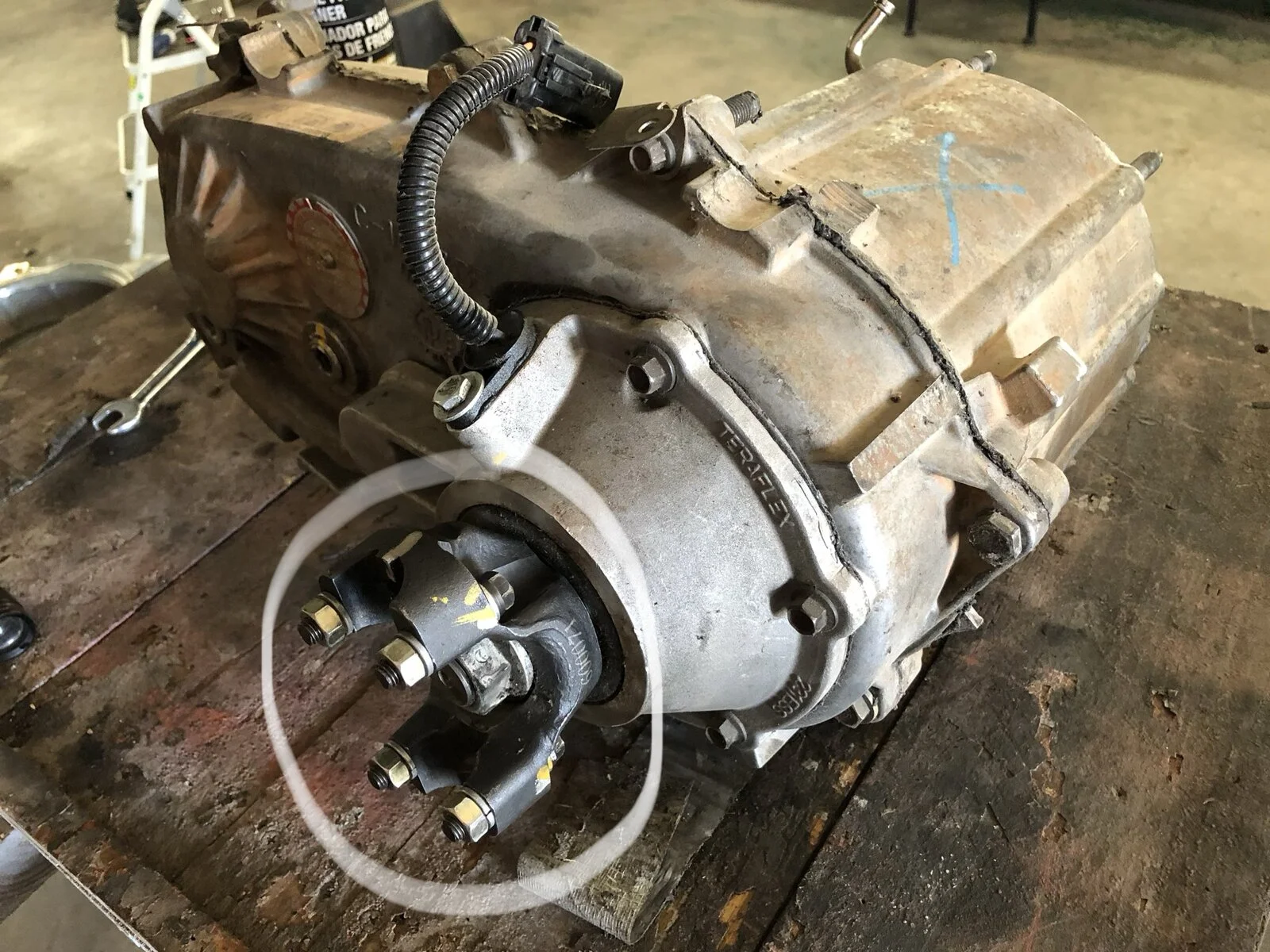

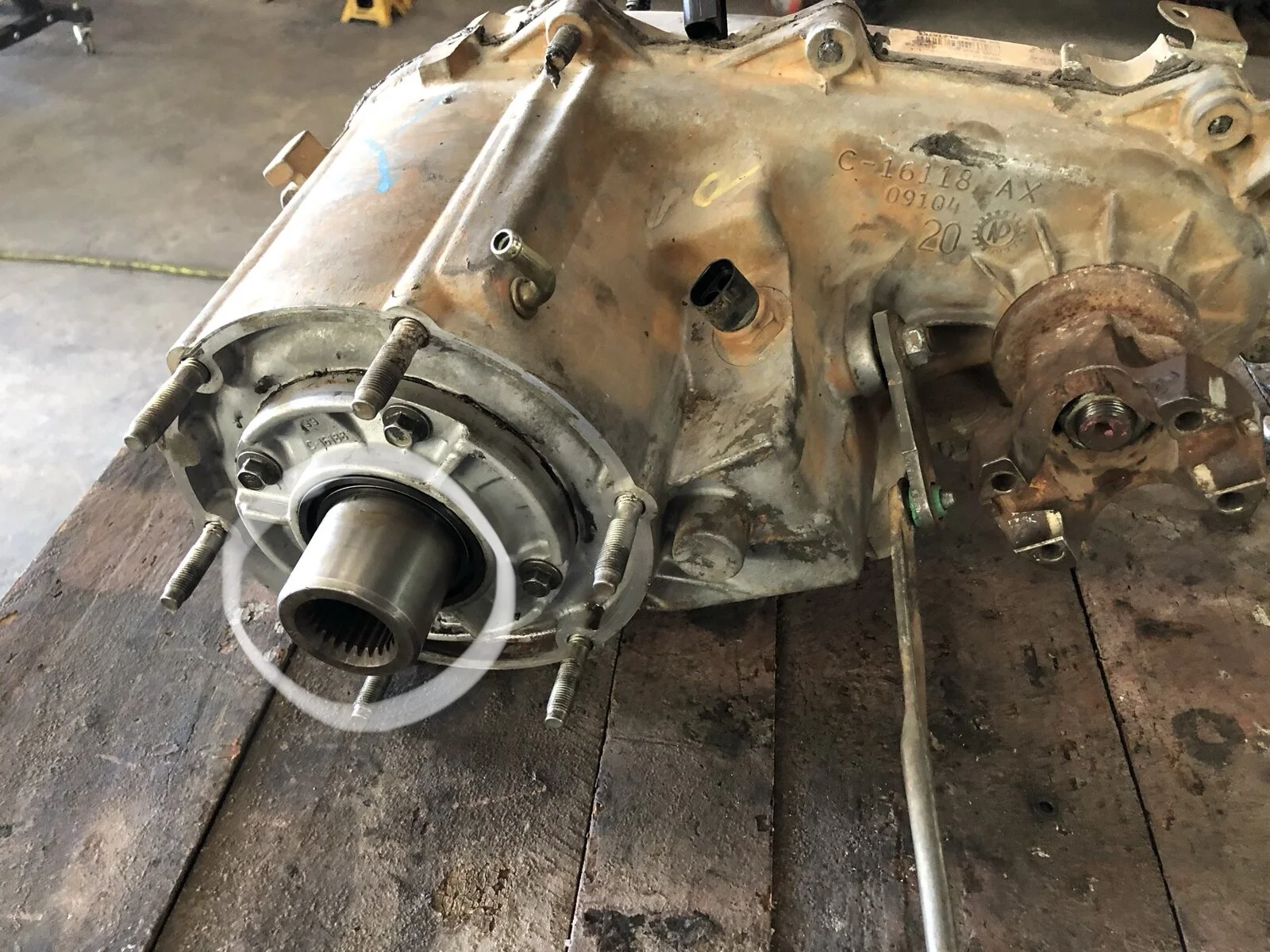

I have a 2003 Jeep Wrangler Sport that I purchased a couple of months ago. The Jeep has a pulsing vibration at 70+ mph. A little back story on the jeep, the previous owner had the lift installed and did not know about pinion angle. The Jeep had a transfer case drop and a slip yoke eliminator installed along with a double cardon rear driveshaft. When I purchased, it had a horrible vibration at early speed and so on, which was fixed when I added rear adjustable control arms and corrected the pinion angle. I'd say 90% of the vibration was fixed, but have noticed that I have a pulsing vibration at highway speeds. I removed the rear driveshaft and ran it on 4Hi. All the vibrations disappeared, so I assumed that the rear driveshaft was bad, so I replaced it with a brand new Tom Woods Double Cardon drive shaft. After installing it, I had the same issue. Today I noticed that my rear sway bar links are bad, but I doubt that will cause the problem. As of now I have eliminated the possibility of the shafts being the problem and the pinion angle. Does anybody have any idea what could be the issue? Any help would be appreciated.
