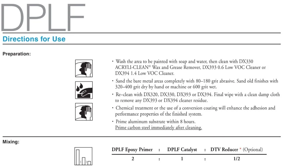

What da??? Painting just needs a dish soap and warm water to clean the surface. Whoever advised you to use a tar - wax remover needs a paddle in the butt.
Actually using wax and grease remover is a common practice, in fact the product data sheet indicates it’s usage. My problem was I went cheap and didn’t use the stuff recommended by the manufacture.[emoji849]
I kid you not, I never use anything but a dish soap and rinse washed it with warm water. I used a denatured alcohol at one time for the hood. It is a big waste of money. But good luck, lot's of elbow grease ahead of you. Better yet, "grease free" elbow :)
I used dawn dish washing soap, but unfortunately chased it with the wax and grease remover. I may go with your plan next time! I did see the eastwood guy used an aerosol window cleaner followed by 70% alcohol, it worked for him. I just hate to pay $20-30 a quart for the stuff that PPG recommends!
