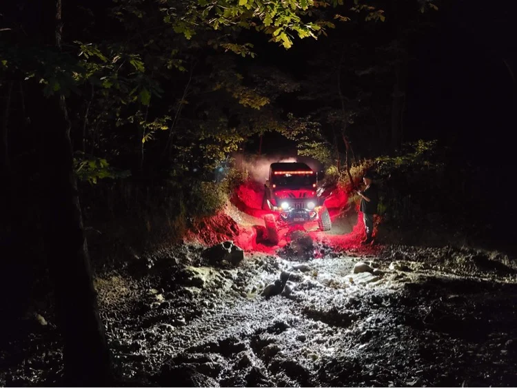

All my lighting is Rigid and came from the PO. Radiance series, expensive shit. Super bright and still working. Installed in 2016. I have a 50" bar, 2 cubes, and 6 rock lights. Trucklite headlights. I would recommend it, but I wouldn't spend my own money on it. The light bar has helped in recovery during night runs. Lights up the woods like daytime.

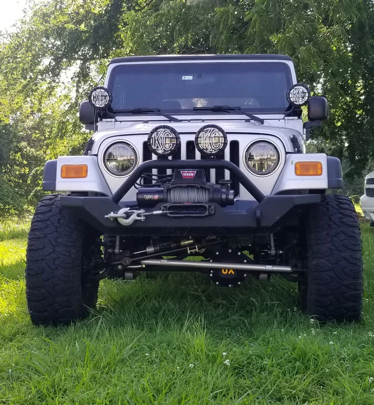

I'll check out Rigid. I'm mostly interested in a light bar for night time wheeling in the desert. My KC LED headlights and fog lights are bright, but adding a light bar will be a game changer.

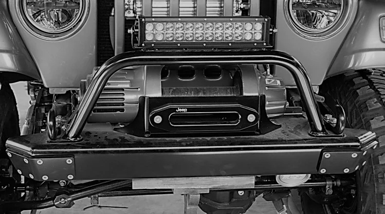

Put a light bar on top of your winch guard. Everyone I know that has had a windshield mounted light has HATED it. Wind noise if terrible and it shines off your hood. If you want a light a little higher then do the windshield hinge mounts.

Then make some nice clamp on brackets that you can mount a 20" light bar to.

If you are moving slow and want to light up a large area, they are great. Huge pool of light, but they will show you all the dust in the air. I have used mine several times with great results, but like I said, if it wasn't already on the Jeep when I got it I never would have bought it myself.
