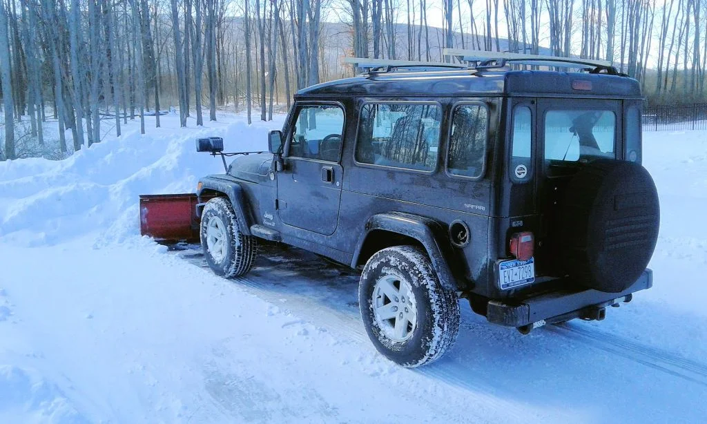

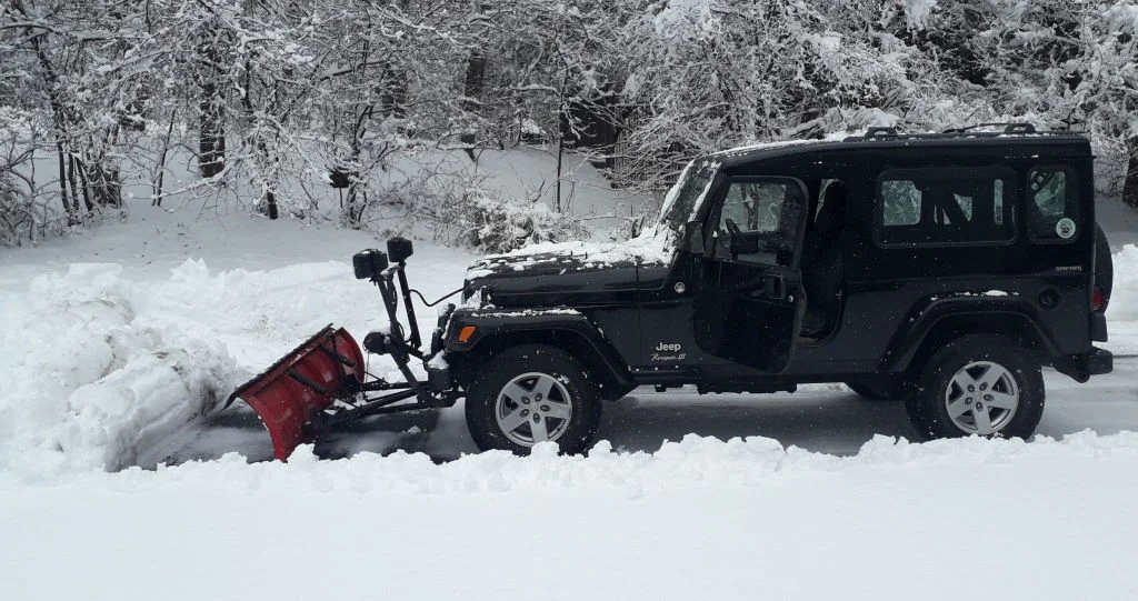

I've got a 1999 TJ Sahara the the original owner put a snow plow on and left it at their cabin in the garage most of it's life.
I bought it a couple years ago and was thrilled to have found a Jeep in the Black Hills of South Dakota that hasn't been off road!
A TJ isn't' exactly an ideal snow plow vehicle but it's been really useful that's for sure. When I drive it from my house to my cabin even running 55 MPH the plow blade blocks enough air that the Jeep will over heat. So I just added a Derale fan kit.
