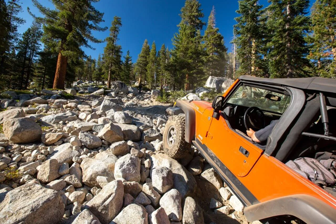

The Jeep I an driving is a stock 2006 TJ Rubicon with Auto Trans. I am going to eventually get it on 35" tires with a lift. I am currently running the stock 4:11 gears from the factory. I plan on very mild trails and rocks, nothing to crazy.

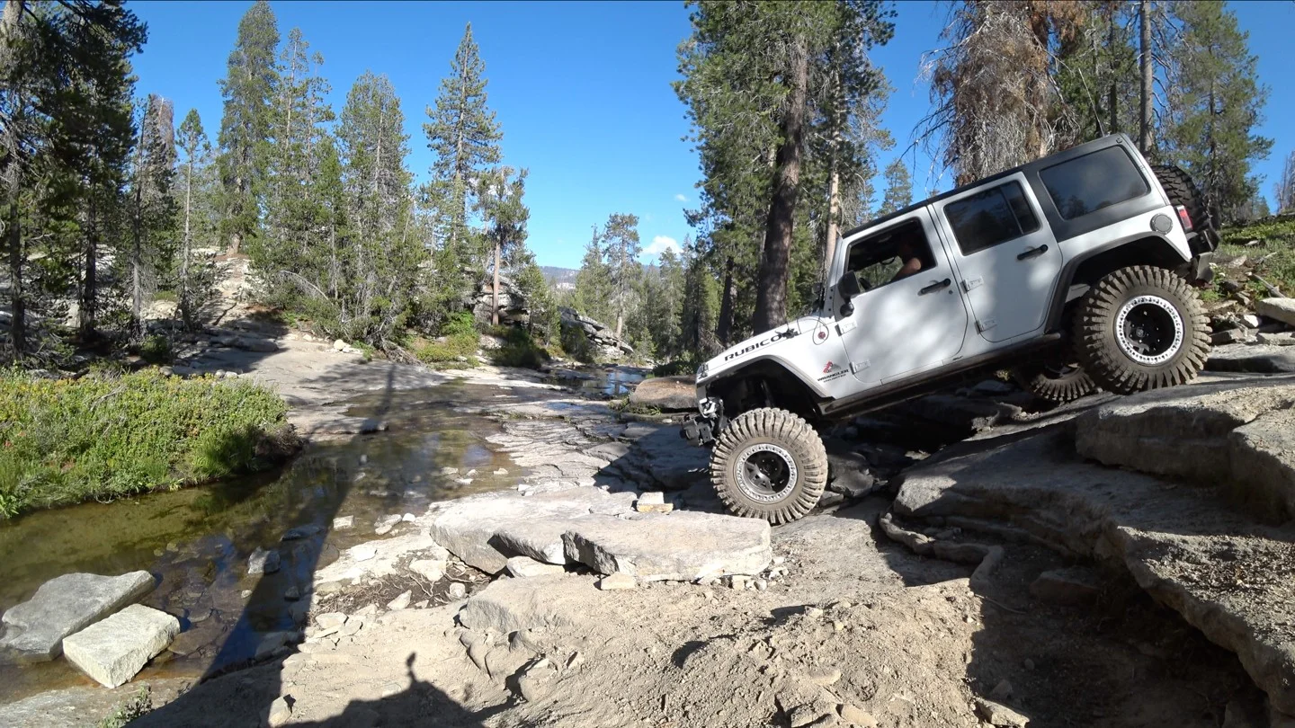

For 35's and your 42RLE you need to regear to 5.38, not 5.13 which is not quite enough for 35's with the 42RLE. Gear your axles for the highway, not for your rocky trails, where 5.38 is ideal for 35's. I regeared this TJ from 4.88 to 5.38 and everything including its mpg improved significantly. Mpg went from 11 mpg to 14.6 after installing the 5.38 and the highway driving was a LOT more enjoyable too. And on the highway I consider 5.38 just adequate, I would not like the slightly lower highway rpms of 5.13 at all.
And with the Rubicon's 4:1 tcase and your automatic my strongest possible personal opinion says you don't need a Rubicrawler for your mild rock crawling like in your photo. My TJ Rubicon did lots of rock crawling on some pretty darned big rocks/extremely tough trails and it crawled beautifully with its 4:1 tcase and 42RLE automatic without a Rubicrawler. I could crawl at .01 mph if needed with that combination. :)
