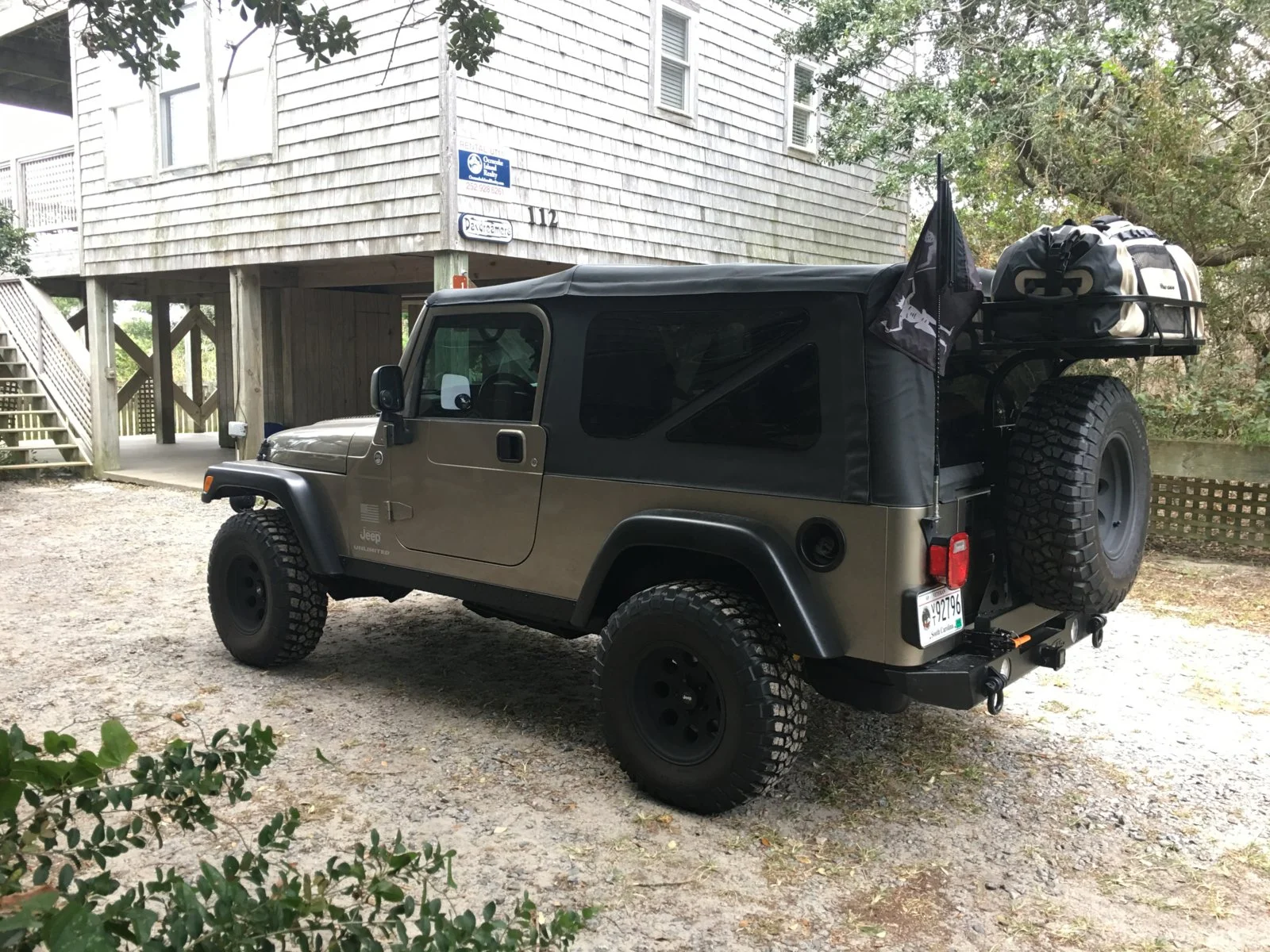

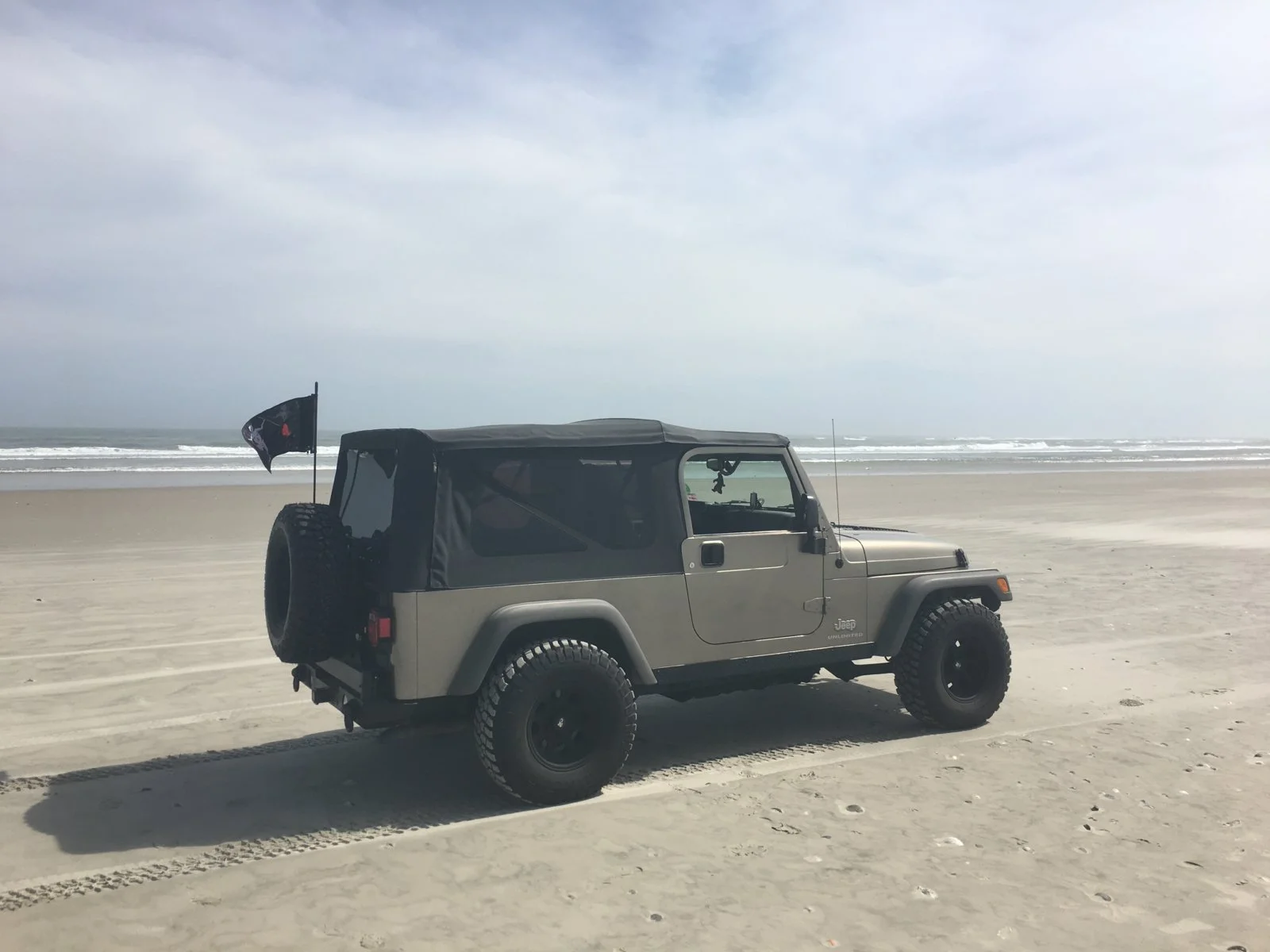

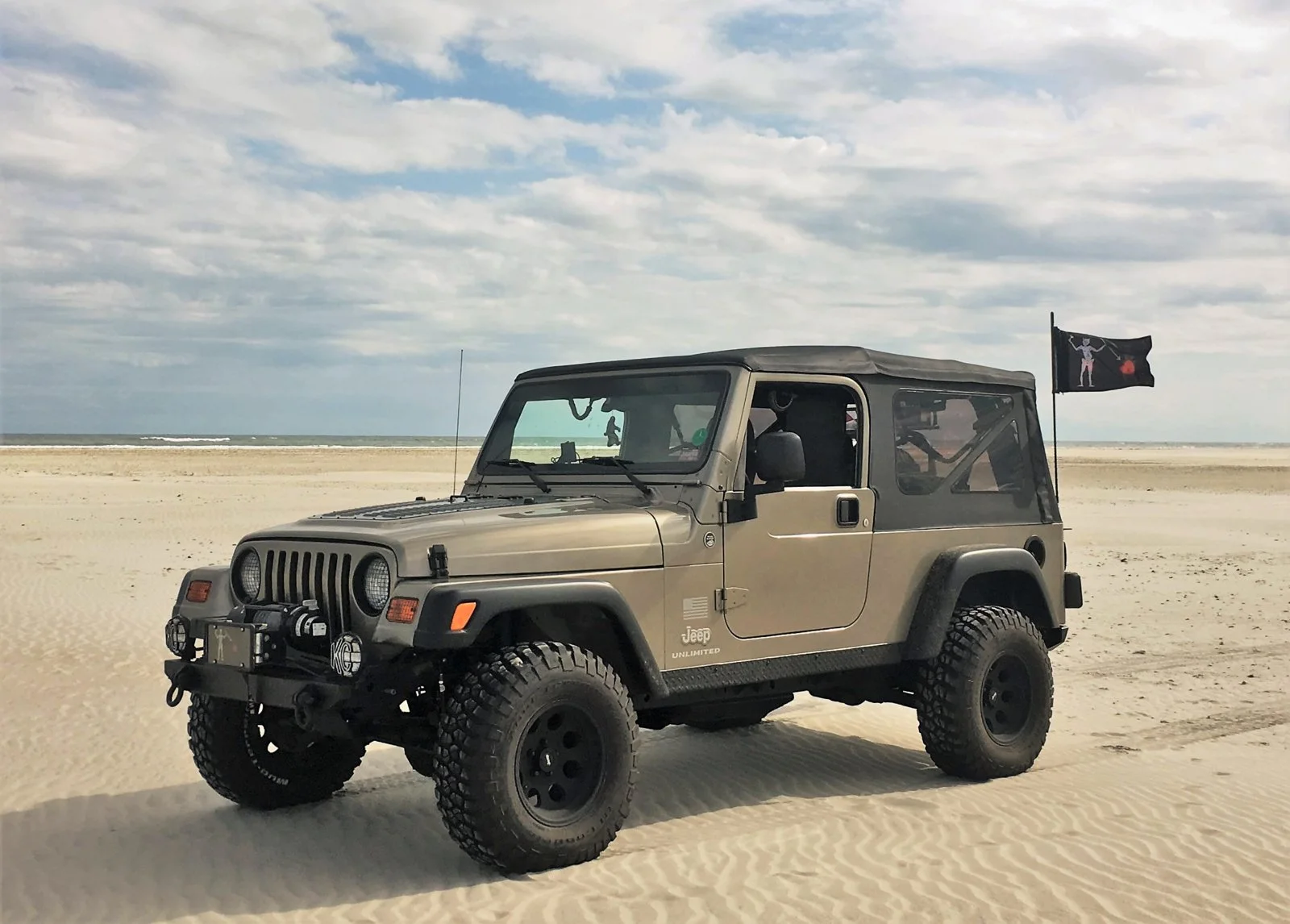

I have the same 2933 and 2942 OME springs as @Hcwlsu101 on my ‘06 LJ. But I have a heavier than stock LOD stubby bumper, winch plate and winch with steel cable up front and an LOD rear bumper/tire carrier with trail rack. Dirk suggested adding another spring isolator on top of the one that was already there, basically as a spacer. It leveled everything out for me. It’s listed as a 2” lift but with my setup and HD springs I got 2.5” out of it.
Their newer sport shocks seem harsh to me at times. My plan is to try some Rancho RS5000x shocks that are highly recommended sometime soon.
