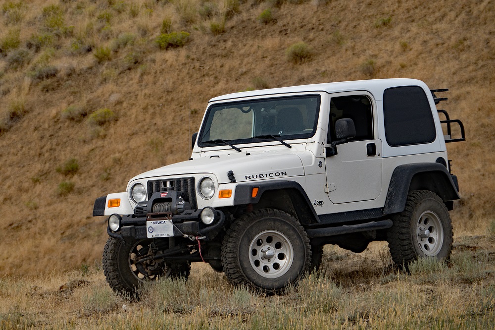

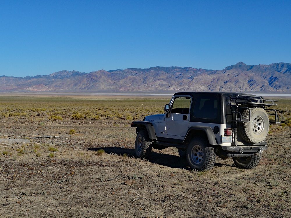

My Jeep came with a black hard top. I hated it. Here in the desert sun it would get so hot it would burn your hand. Since the body of the Jeep was white I opted to just paint the hard top white also. Prepped the roof by thoroughly cleaning it, first with soap and water and then with acetone. If I remember correctly it took about 7 cans of Krylon Fusion white paint to do a good job, The Krylon Fusion is specifically designed to paint plastic - most other paints will not stick to plastic.
That was some 10 years ago. The paint job still looks good.
Before:
After:
WOW - stunning!! And thanks!

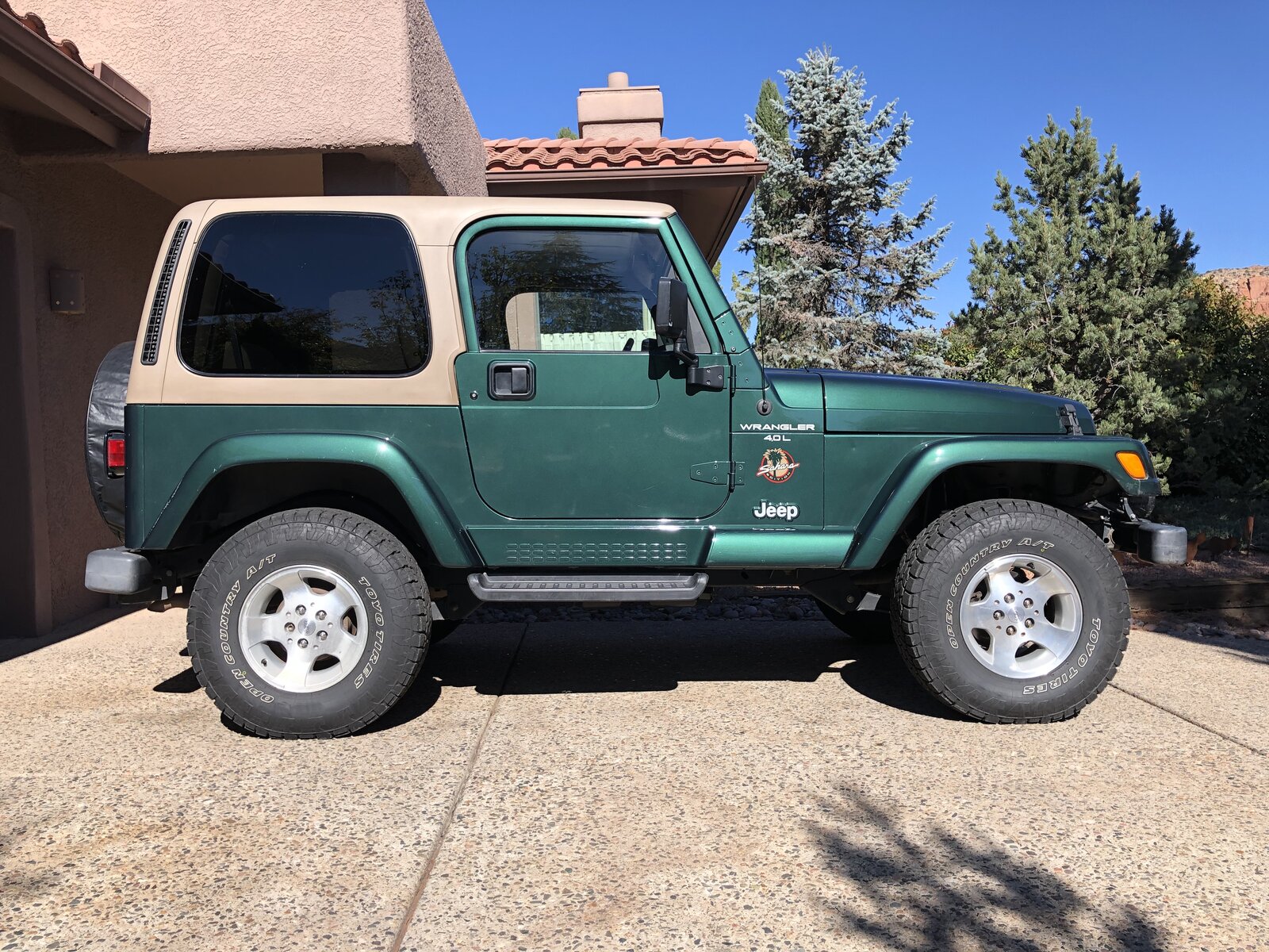

@Jamison C made one look great with penetrol
THANKS so much for finding this for me! Hugely helpful.
Oops, it was by @Jamison C, here.
Awesome, thanks, printed it out for *next* project

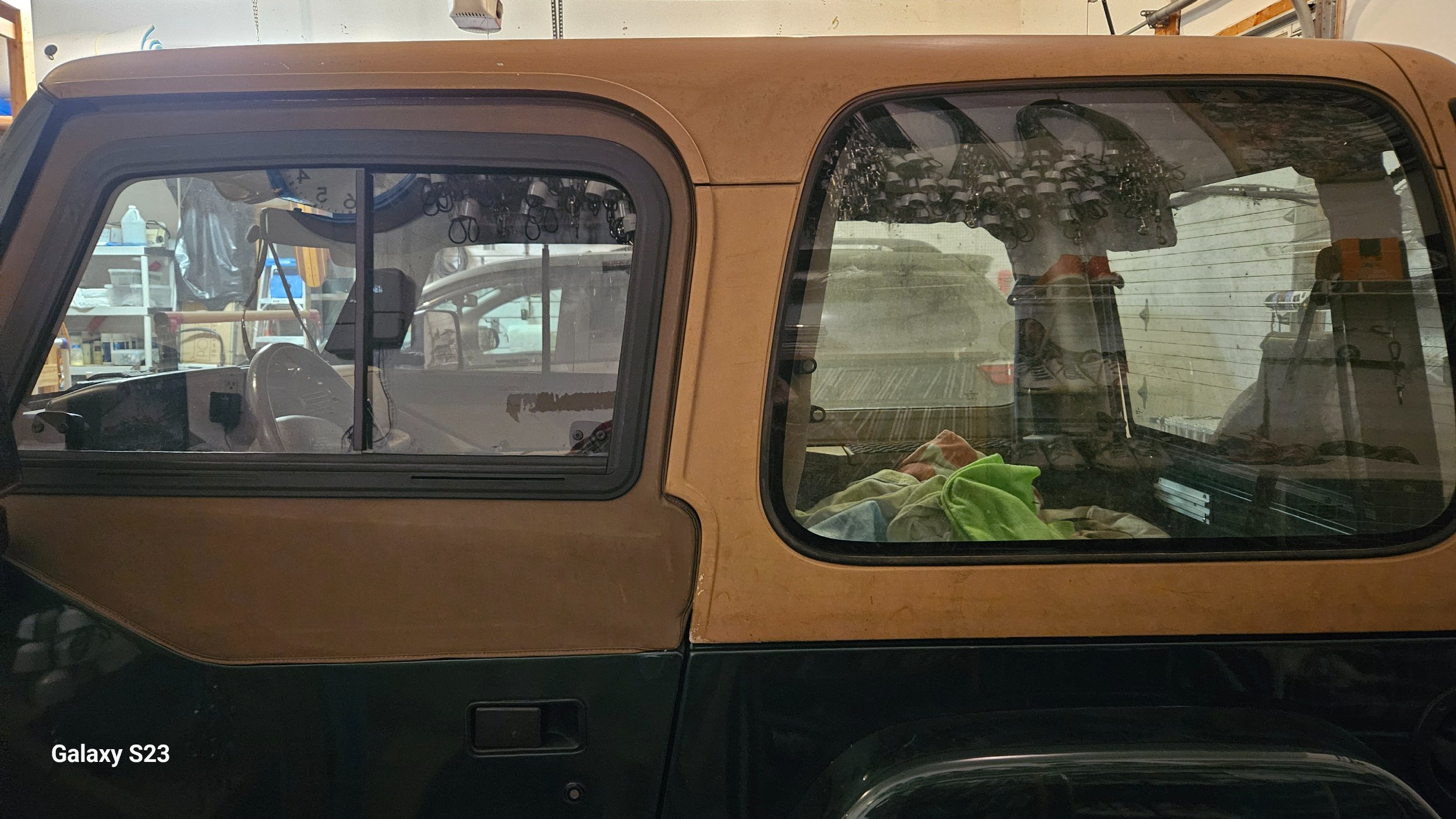

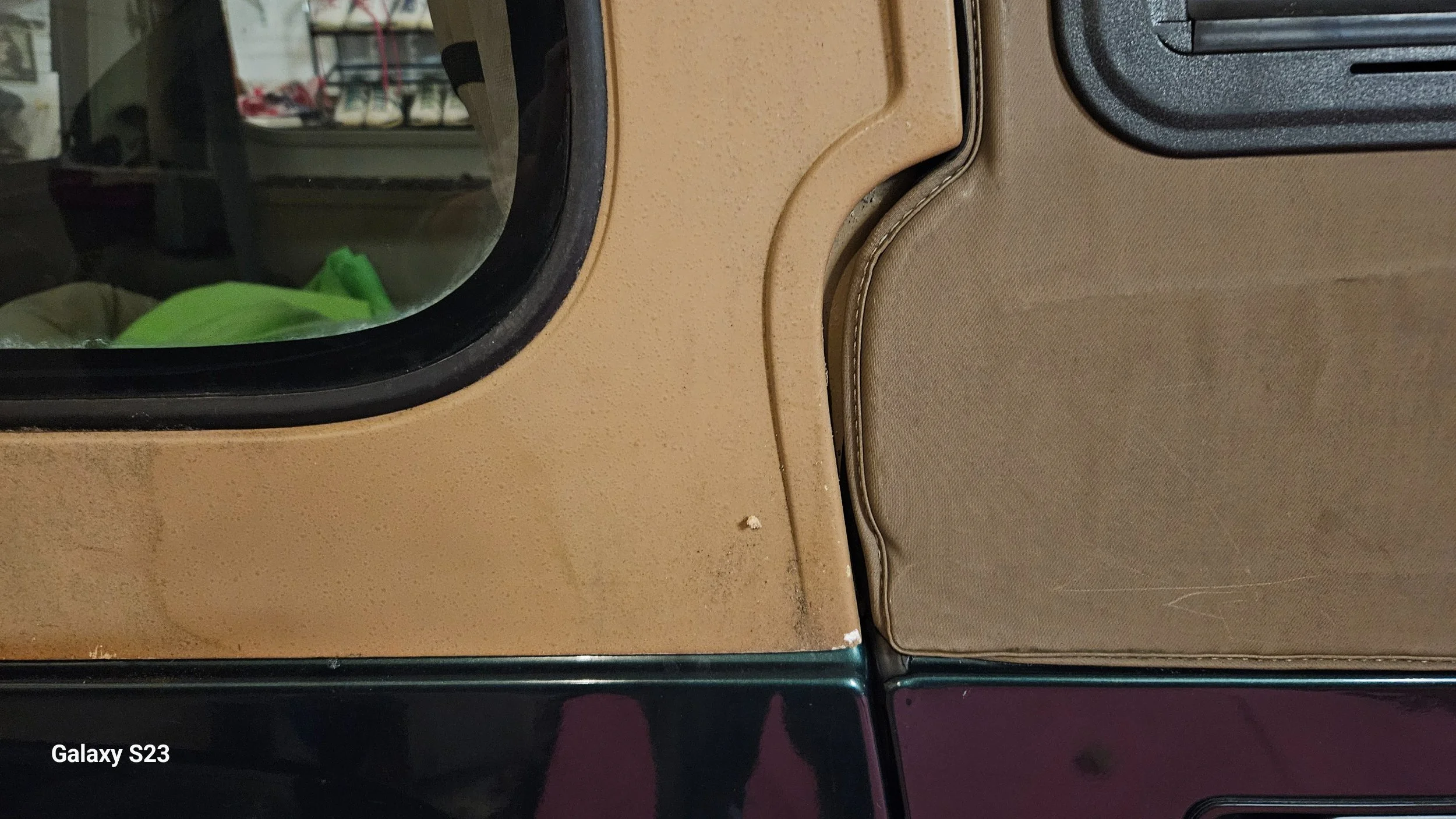

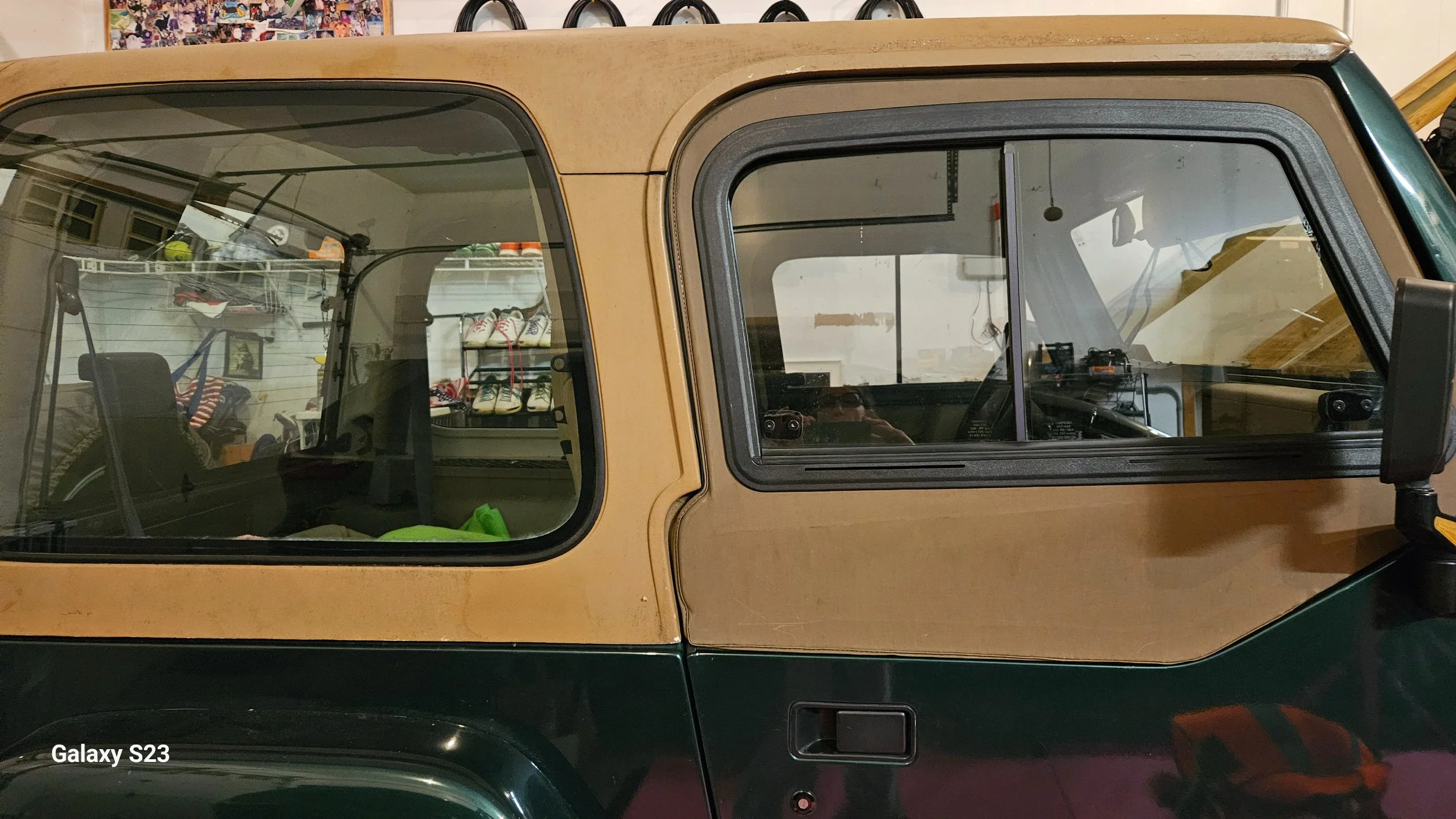

UPDATE: Bought a spice hardtop from a 97 today in very nice shape, except for dirt and a few spider families. Was able to confirm that my soft top and hard uppers are "Dark Tan" (not tan, khaki, or spice). It's going to clean up beautifully, but the spice won't match my hard uppers so I'm going to spray it Dark Tan. This may be a dumb question, but once I give it a thorough cleaning, there's NO reason to use the Penetrol since I'm going to paint it a different color, right? I'm assuming Penetrol would keep new paint from adhering. Just wondering if there was any benefit to fully restoring the original color before changing it.
I think you want to stay away from Penetrol if you're going to paint it a new color.
p.s. That's a lot of work just to match half-uppers. Are you committed to those?
Kind of, because they match the dark tan soft top. So current thought is restore hardtop to spice and get a second set of hard uppers to match that. And so it begins 🙄 $$$$$

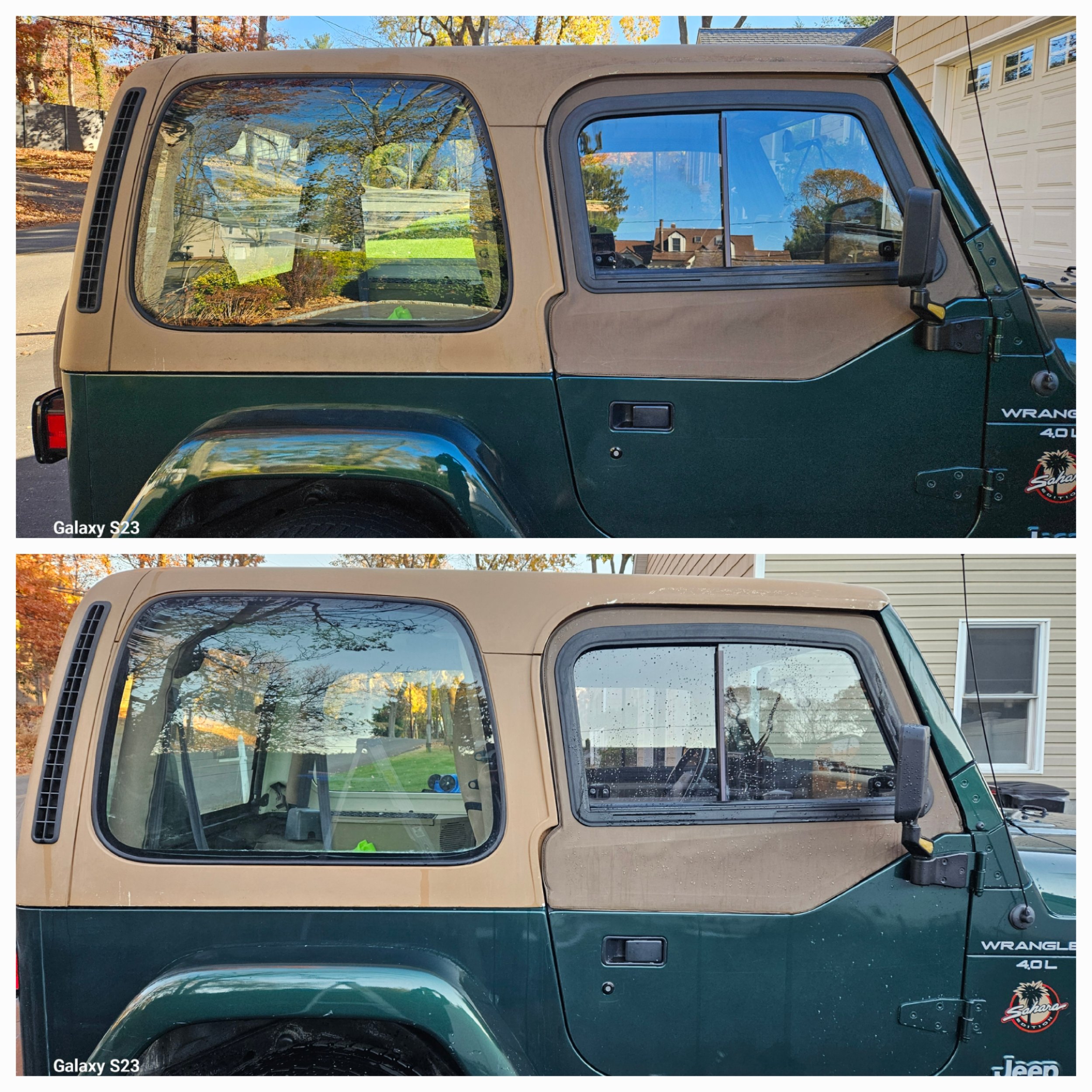

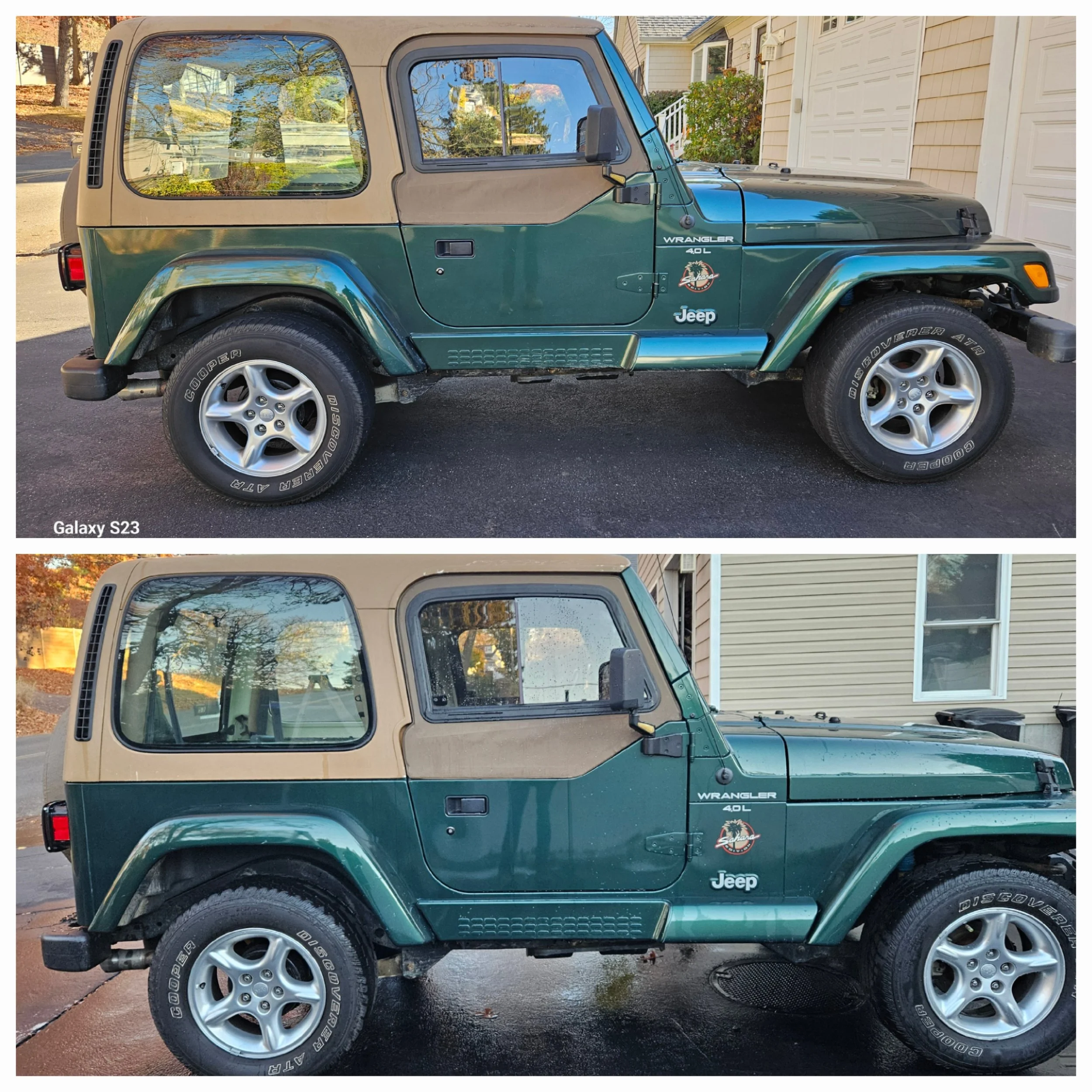

Someone else said it here recently... full doors make me feel claustrophobic 😯 LOVE my half doors. Here's before and after a good exterior cleaning. It uncovered some surface scratches but looks SO much better.
