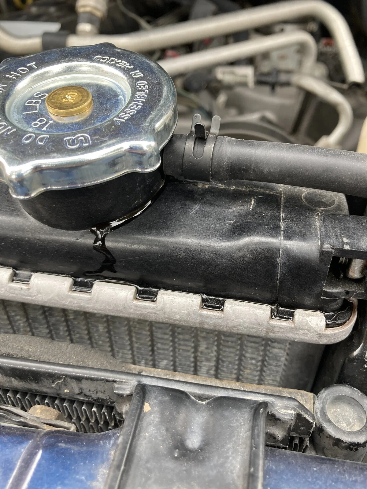

Alright as mentioned earlier a few hours ago I found a leak coming from here where the hose connects. I went to the parts store and bought a new hose and clamps for both sides
As you can see it is still pouring out the picture is after I wiped it.
Cant tell if it’s a hole in the radiator near the hose or if it’s coming from the hose.
@Gollywomper so maybe like you said there’s too much pressure in the system but what would cause that?

No your overflow reservoir is vented. It’s possible that you have just been over filling your reservoir and that is causing some of the issue you are seeing now. You will need to find out and repair the leak near the radiator cap. You may not have any issues other than the leaking radiator. Original post seemed like you were steadily leaking fluid out of your overflow reservoir. Which could be a sign of a head gasket or overheating issue. However if you are topping off the overflow reservoirAnd keeping it over full it surely will overflow when the engine is hot. Get your leak fixed on your radiator then make sure your overflow reservoir level is correct.

Alright guys got some good news, I ran the block tester and the fluid did not change colors. I did let the thermostat open up before running the test.
Maybe radiator is broken in that spot or maybe it's not upto spec since it's an autozone brand? I syphoned some antifreeze so there's less in the overflow might be the easiest thing to try without spending money.

If you think the radiator is leaking from that overflow hose you can try a regular hose clamp instead of the spring loaded clamp. Just be mindful of how tight you tighten it since the barb is plastic.

I'm gonna try that fitting next actually if it's still happening. I'll find out after work.
