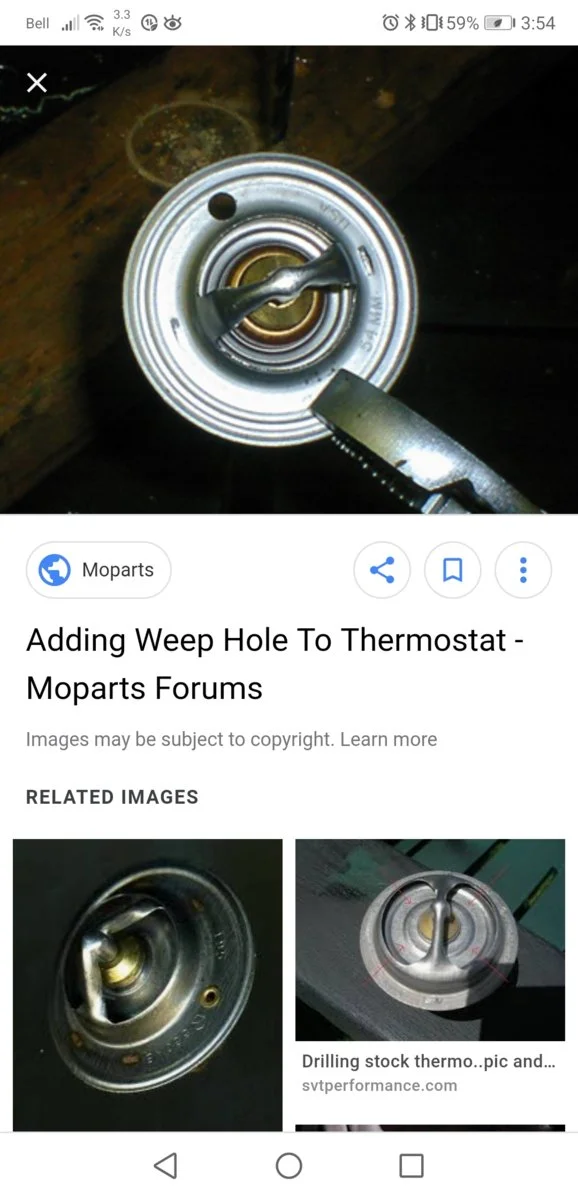

Kinda wishing I would have gone with a Mopar over the Stant now or at least drilled a hole in the Stant before putting it in last week. I hate this feeling.

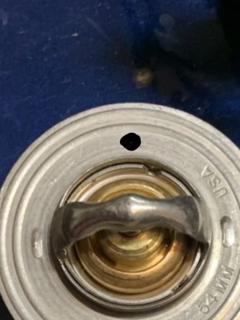

@Blaine So just to make sure I’m doing this correctly before reassembling, I should drill a 1/8 hole in the new thermostat in the same place as the old one?
After we are all done with the flush, engine flushed out, and get it filled, then we run it up to temp with the cap off the radiator to make sure there is no trapped air.
If I try and do this my coolant almost immediately (>30 seconds) starts to spill over the neck and on to everything below. Does this mean there’s still trapped air in there?

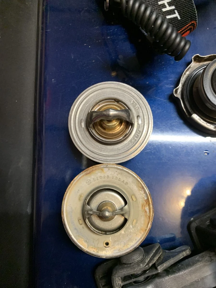

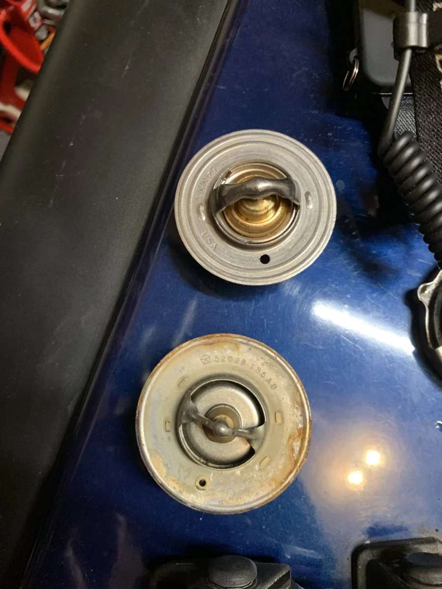

Thank you. And when replacing the thermostat does the weep hole position at 12:00 or 6:00?
I clocked mine a little sideways so the opening would line up with the neck on the housing. Don’t know it that’s right, wrong or doesn’t matter.
It does when I'm doing it. But, it depends on how much coolant is in the radiator. There will be more after it has run with the cap on than filling from empty. If it does it from cold, get one of the overflow funnels and see how much is actually going up into the funnel.
