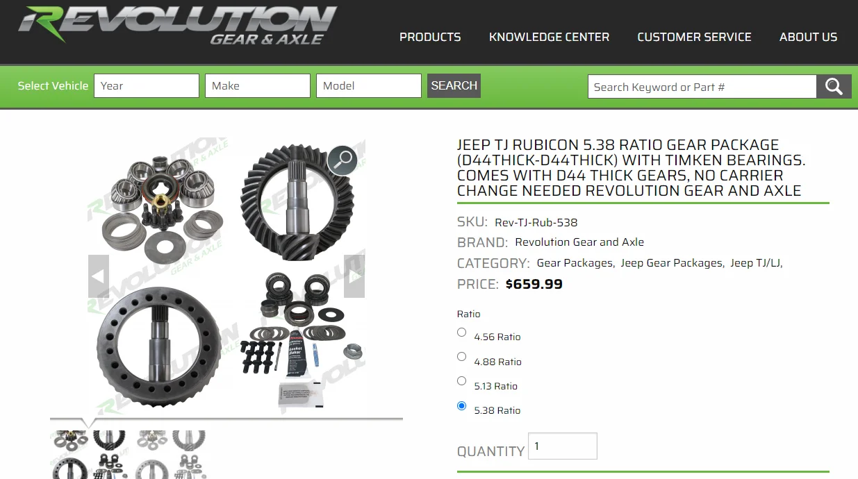

I have a technicall question.. I've been planning on regearing for my 06 rubicon with the auto tranny 42rLe, I'm currently on 285's (33ish) but planning on getting some 315's (35ish) on the next set of tires so, better regear for the 35s, I know that revolution gears would be the route to go and even better since they have the rubicon model gears that fits with the oem lockers.... but there is my doubt... if (more like when) my oem lockers die, since they are known for not being bulletproof, am I going to be able to use any other kind of locker with the revolution gears made for the oem rubicon lockers? or I would be obligated to get a new/used set of OEM rubicon locker if I want to keep the locking function? are the revolution gears for the rubicon models compatible with other not OEM lockers? or if the locker dies I would need to get a new pinion/ring compatible for other kind of locker? would I need to get a new set of gears if my oem lockers goes bad?

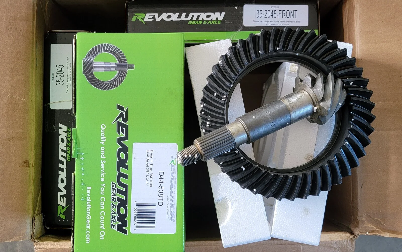

Mine currently has Motive 4.88 thick cut gears that were originally installed on the front and rear Rubicon lockers. When the rear failed, we put in an ARB rd117 and moved the existing ring gear to it.
Sometime soon, I will be putting Revolution thick cut 5.38s for the Rubicon onto that same ARB rd117.
Go with thick cut gears which will work on a future replacement locker if you select the high ratio version.
just to be sure I got it... if I get the thick 5.38s from revolution and my locker dies in a future, I would be able to just buy another locker with the same gears? and the other question.. is there any "cons" for getting the 5.38s with the understanding that I usually cruise at very low speeds (its really rare when I get highway speeds) thanks..!
5.38 is the very best ratio for 35's with the 42RLE no matter what speed you're driving. And for a future locker just make sure it's for higher ratios like 3.07 or 3.73 and the thick gears will work perfectly. All you'd need to do is adjust the backlash for the new locker carrier.

Yes a higher ratio carrier like the Rubicon locker uses has the ring gear mounting surface further away from a high ratio pinion gear which has a larger diameter with higher ratios like 3.73. Lower ratios like 4.88 and 5.13 have smaller diameter pinion gears so the ring gear has to be made thicker for it so its teeth can engage the smaller diameter low ratio (like 5.13 or 5.38) pinion gear adjacent to the Rubicon locker.
In low ratio carriers made specifically for ratios like 4.88, 5.13, etc., which the Rubicon does not come with, the ring gear is positioned closer to the pinion gear so thick ring gears are not required to reach the pinion gear teeth.
