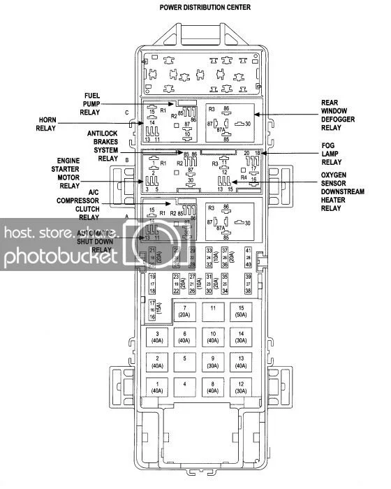

this diagram is from another jeep forum and the poster claims it's for a 2001 PDC:
he also recommended to "pull the horn relay out ( it's exactly the same as the defroster relay ) and plug it into the rear window defogger relay cavity . Then try the button on the dash , it should glow amber if the sytem is operating properly"

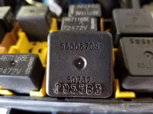

Huh, they definitely aren't the same style of relay on mine. What this picture has labeled as the rear window defogger relay is marked as "HBL" on the inside of the cover and has a totally different size + pin config.
The same as my '06. I believe HBL is short for heated back light or heated back window in American :LOL: . I deleted his horn relay recommendation but the HBL relay looks like a standard 5 pin Bosch type relay.

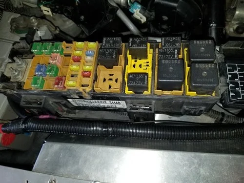

I did see in under hood fuse block something labeled HBL but expected it say rear defrost relay. in the owner's manual the fuse behind the glove-box they label fuse for rear defrost relay. So I expected it to be labeled that as well. I will check that and try swapping the horn relay to test it
I will check that and try swapping the horn relay to test it.

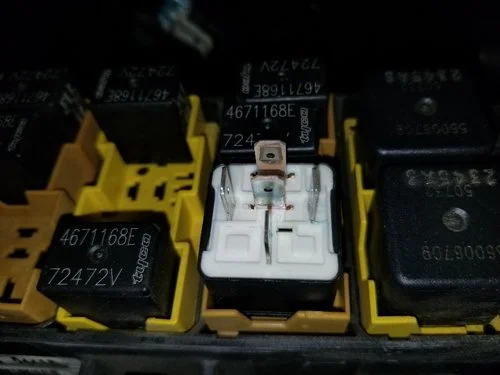

I think that guy had bad info. It looks like the horn relay is a different size. You'd have to use a relay that looks like this:
