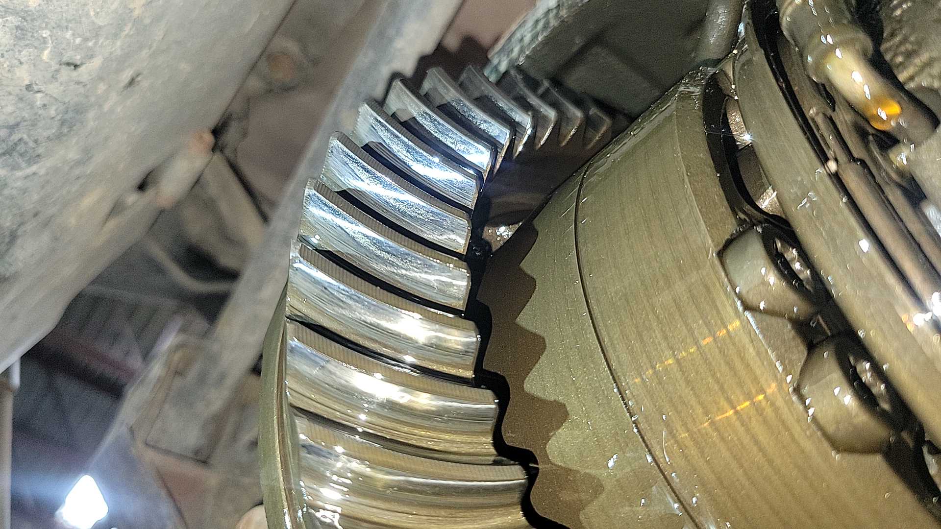

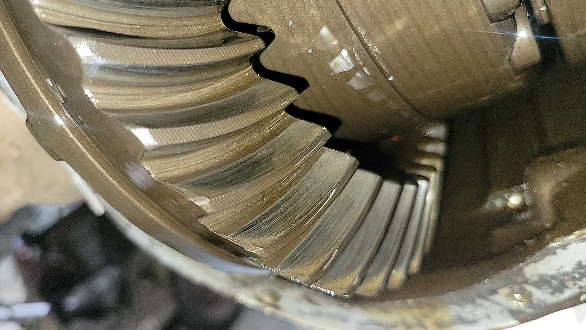

Ended up finding a shop. for labor, master rebuild and a new R&P they quoted about 2k. Not exactly cheap but a good reputable shop from both reviews and some referrals. I had them tear it apart to see if the R&P are toast and they were. both the pinion and the ring gear had spalling on the drive side so I told them to go ahead on the new Yukon 4.10 R&P. Coast side looked acceptable but being as this is going to be my daily and I'll probably replace the transmission, rebuild the engine and transfer case, i figured that a new R&P isn't bad. Checked the prices on parts and its looking like they're basically the same (within 10 bucks) of the price I can order them from Yukon Gear myself.
