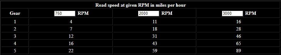

I have a 2002 123k miles Sahara 4.0 NV3550 NP231 Dana 30 / 44 (3.73) 3" coils 33" tires. I do not plan on increasing the tire size unless axle upgrades are made (Swap?)
Currently while driving it seems like the gears are too tall and for my mostly in town driving it just isn't great. I am trying to keep my rpm between 2k and 3k for most driving as to not lug the engine (I cannot which thread I read that in). I end up running 1st gear to 20 mph and 2nd to 35mph. In traffic it is hard to creep in 1st. I can comfortably drive on the highway in 4th gear at 60-65mph. I also do not see a need to do 108mph at 3k rpm in a solid brick.

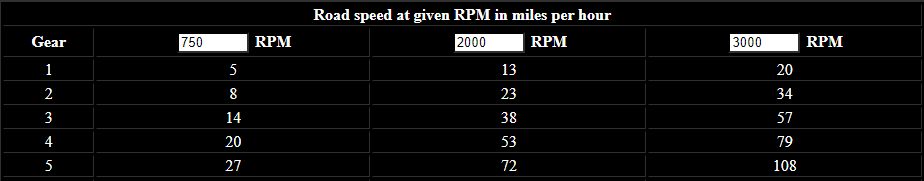

I am considering going 4.56 to get a more comfortable city driving and I am not sure how much dirt this will see (but I don't want it to not be able to go off highway if needed). Or should I just go to 4.88? I like the idea that with 4.56 I get to 65mph in 4th without an upshift. That would match a lot of highway driving that is 55-65 mph.
Charts for reference
3.73 Gear Ratio
4.56 Gear Ratio

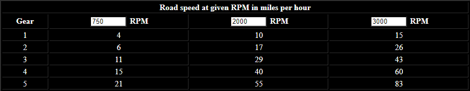

4.88 Gear Ratio

You didn't enter 33" as the actual tire diameter for those calculations
right? Most tires are smaller than advertised.might want to verify that with a gps app on your phone.
4.88/33s would be very peppy with a 6. But probably get old fast on the freeway to me.are you going to trailer it to oregon and tahoe?As far as snow i bet some chains would be better than lockers if money is tight. Then your braking would also improve.
For my money I'd only ever install selectible lockers. Spending money on less is a waste to me.lunchbox lockers were cool as a broke kid. Not so much now.
I live an hr north of you.i know that area well. You'll be happy with 4.56 if you wind up taking trips on 101 or 5
I used 33 since both the current tires measured 32.8 and the Yokohama Geolander or Toyo RT run at almost 33.

4.56 is the right ratio for your 33" tire size and 5-speed. Don't even consider 4.11 for 33's. Your rear Dana 44 and front Dana 30 are both definitely up to 35's, I ran 35's on that combination of axles for years. I'd only upgrade the Dana 30's axle shafts to chromoly for 35's and locker. For 35's I'd go 4.88 though 5.13 would be a great choice if you make drives up into the mountains much. 4.88 worked fine for my mountain needs for my 35's but so many likely 5.13 that it would clearly be a great choice too if you get into mountainous areas much.
