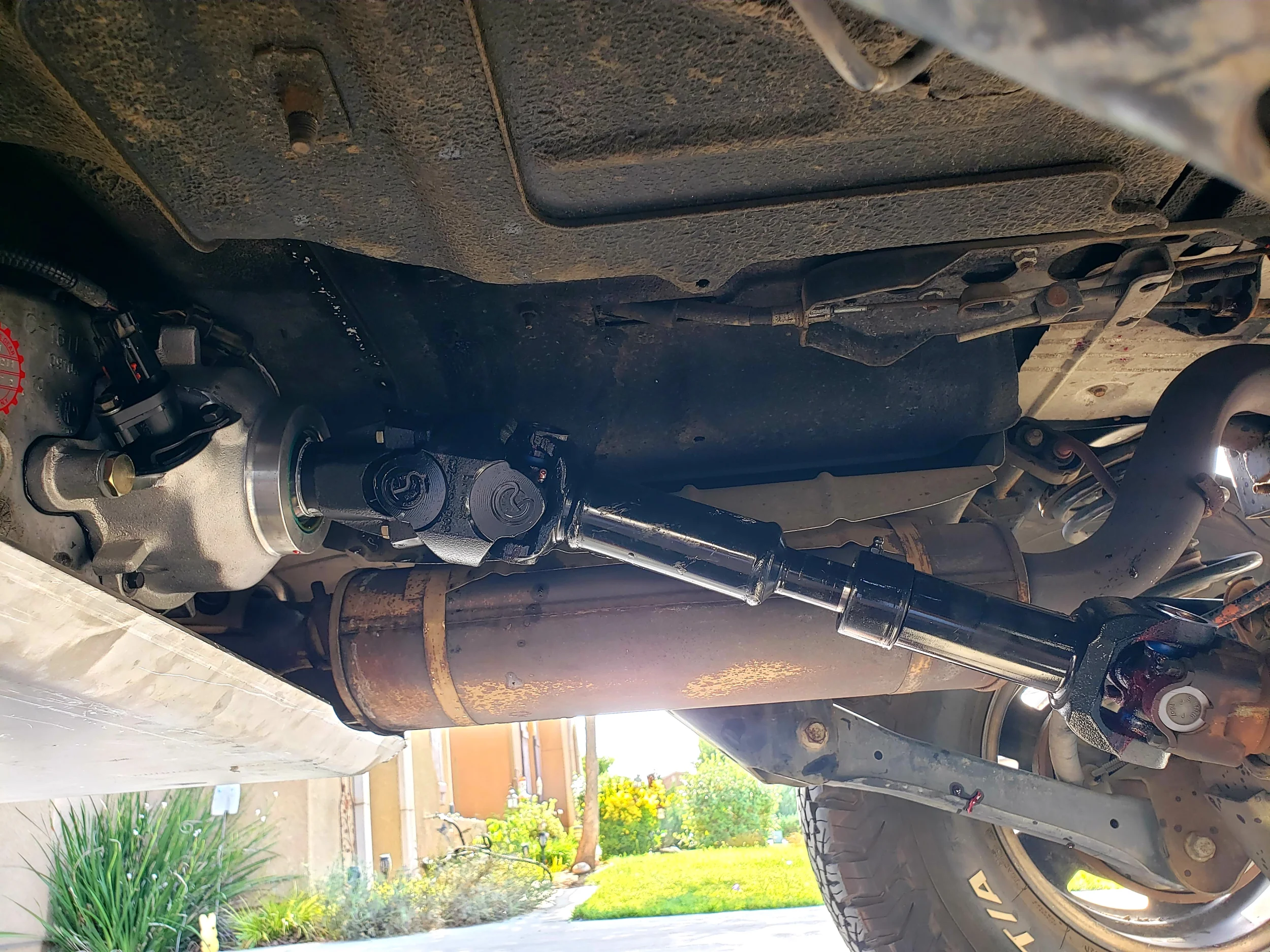

Should the yokes on the shaft be aligned or the yokes on the diff and SYE?
I didn't pay attention when I pulled the drive shaft for an axle swap and it came apart. I have vibration at above 60mph. Not sure if I am 180 out, completely wrong or it is something else. The jeep was bought as a project so I don't know if the vibe was there before.
I think when I put it back together, I was counting the sye as a double cardon and found info to do it this way.

I was planning to just swap the rear yoke 180 because it came apart when I did the axle swap and I had a 50/50 chance of it being wrong, but now that I look at it, I think I need to try a 90 degree change then a 180 if that doesn't work.

A shaft spline stub end can slip out with an X-spline when out of the vehicle. Not a big deal but it's possible to clock it at 90.
Reactions: macleanflood
Turned it 90 degrees and ran it up to 70 mph. Much, much better. Being paranoid, I think I might feel something sometimes but if I wasn't trying to feel a vibe, I would never notice anything. Probably just a lifted jeep and AT tire thing.
I thought about trying it 180 degrees out from where it is to verify, but probably won't bother. If I was 180 out it should be worse than just being 90 out correct?

Driveshafts are spin-balanced at the factory. It's best to get it back to the exact configuration it had when balanced.
Now you have the phase right, that corrected the vibe caused by wobble.
You may or may not have the best alignment for the original configuration. You could switch it 180°. I think I would just run it for a few weeks to see if the "imagined" vibe is real. Mine has "imagined" vibes too, and then when I get to a different section of pavement they go away. Tires and road smoothness.
