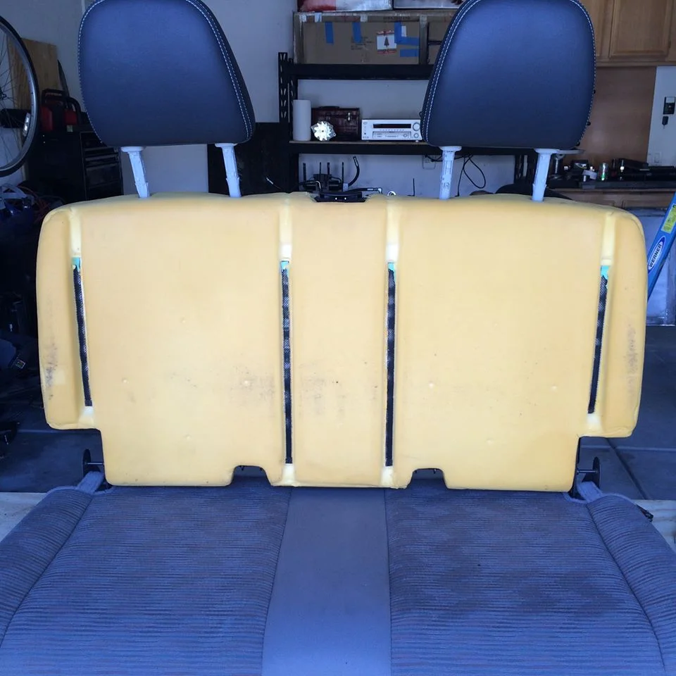

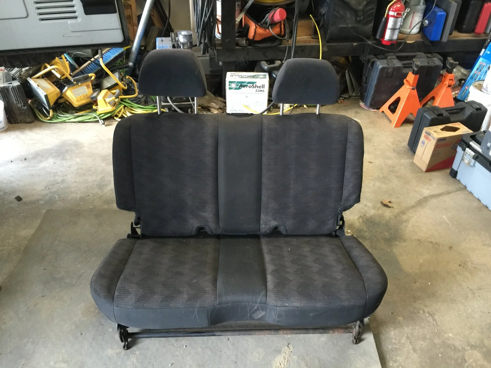

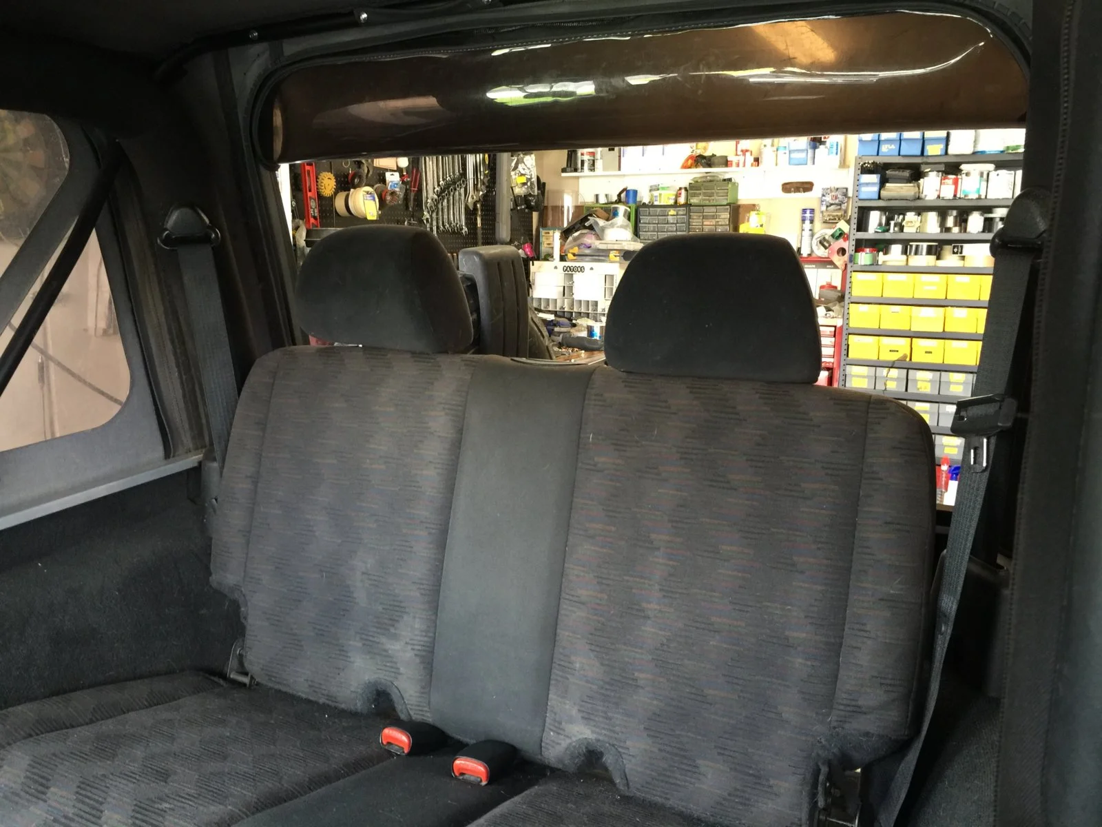

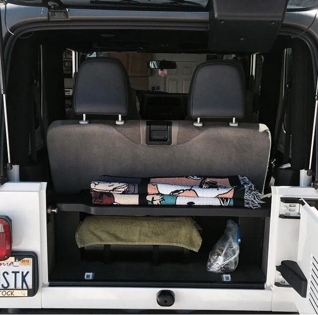

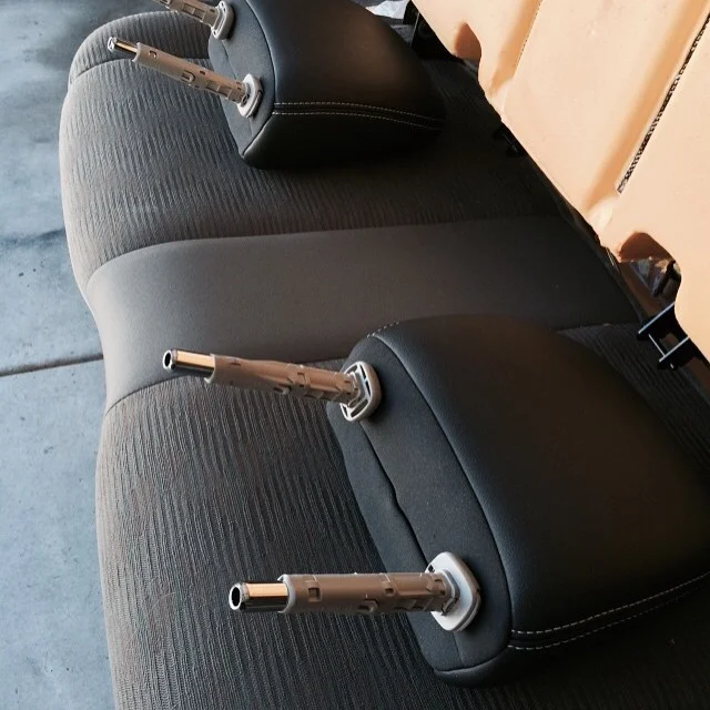

I put head rests in mine, but I can't seem to find any pics and the back is too loaded up with crap to flip the seat up. I used head rests from an 02 Jetta, drilled holes for the metal arms to fit into and slid them down in. They're not perfect, but better then nothing, and the kids are much happier having them there.
Helps if I look in the right album, lol.

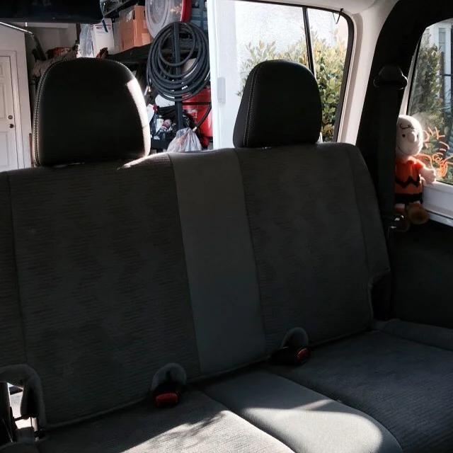

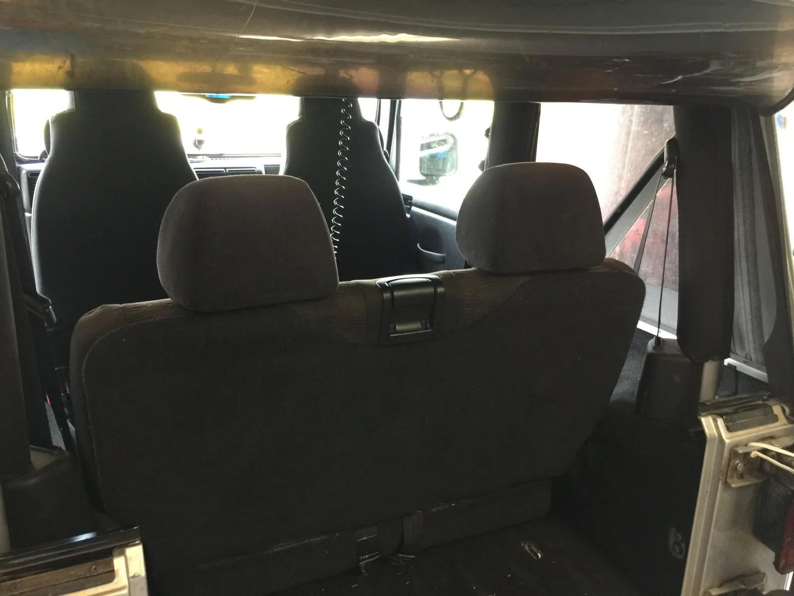

I added some headrests a couple years ago (well I can't lie, my husband did all the welding LOL). The headrests are out of a 2013 Toyota Sienna, I believe. However, I do like the headrests the above person posted better - I may change mine. I can still use the tumble/fold seat but I have the add-a-trunk so I don't use that feature. The headrests can be removed somewhat easily if needed.
Done right. Very impressive

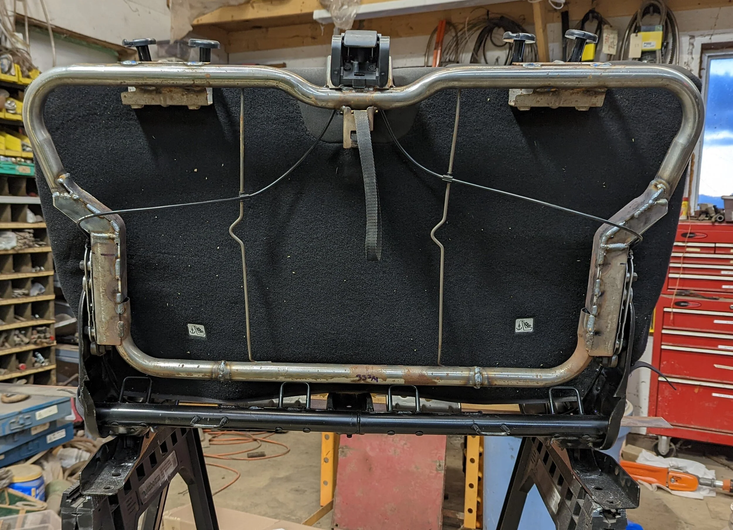

No offense to the other guy but I trust this more than just drilling holes through the tube, if that's even possible for the 2006 since it looks like a formed channel instead of a tube. I will be looking for ways to save weight though, 'cause I do pull the rear seat when I go solo camping and it's heavy enough without what looks like a square tube added along the bottom.
Something like this...and a lot of it could be angle iron since only the "receivers" for the head rest need to be tubes.

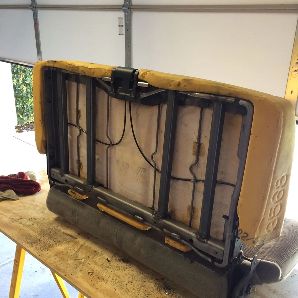

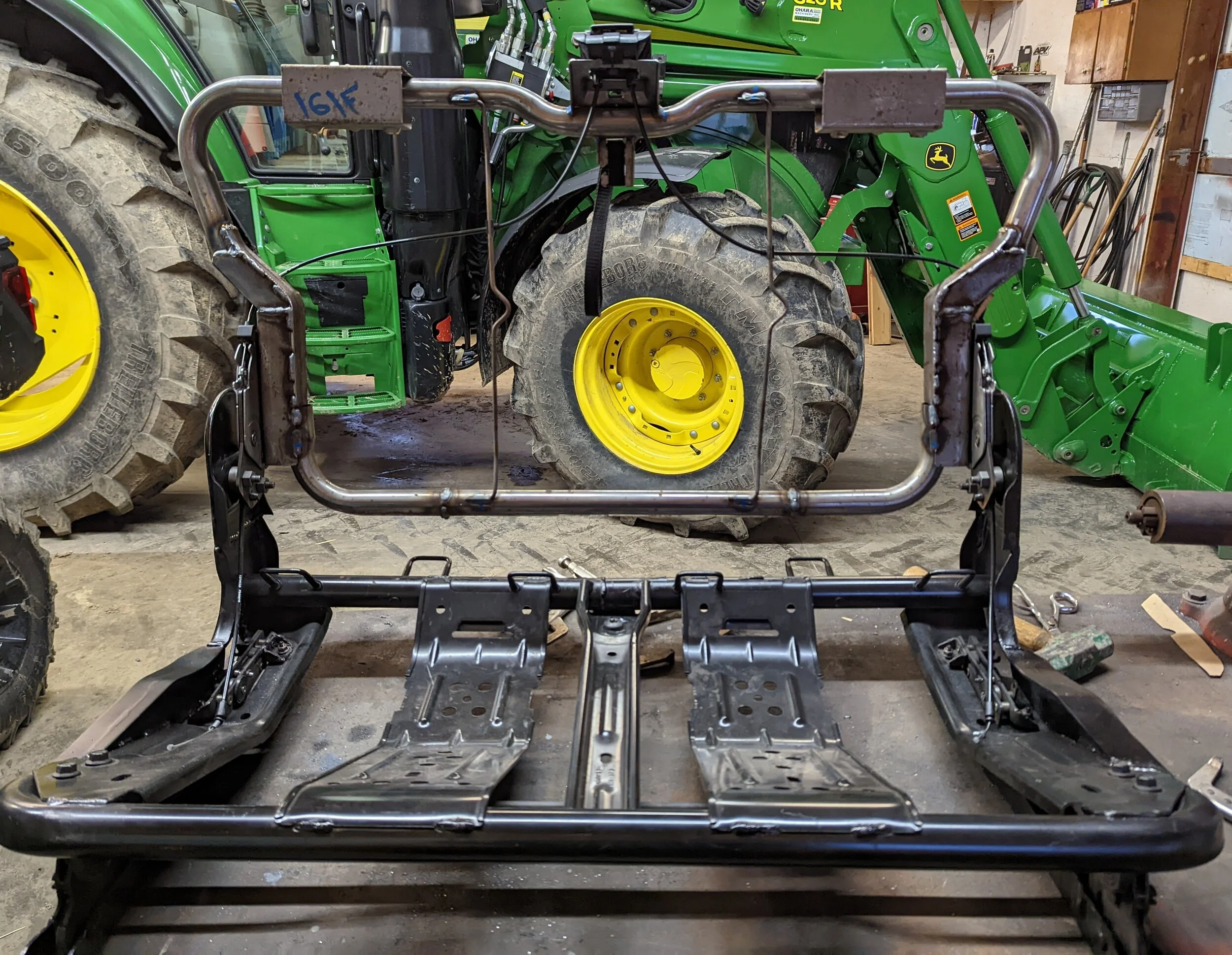

Here's what a 2 door JK seat frame looks like to support the head rests for comparison.
