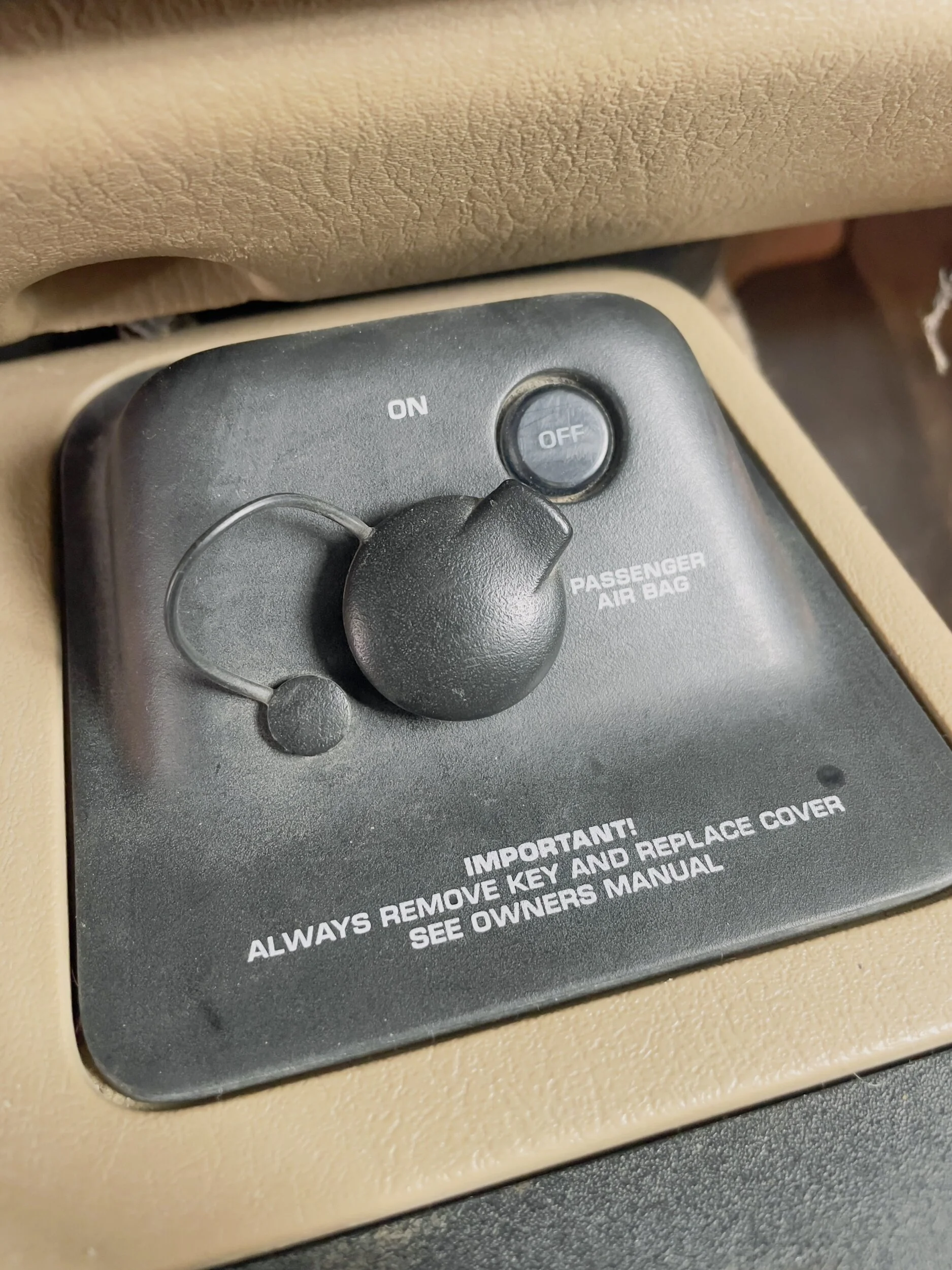

would be nice if you could just turn off the front airbag.

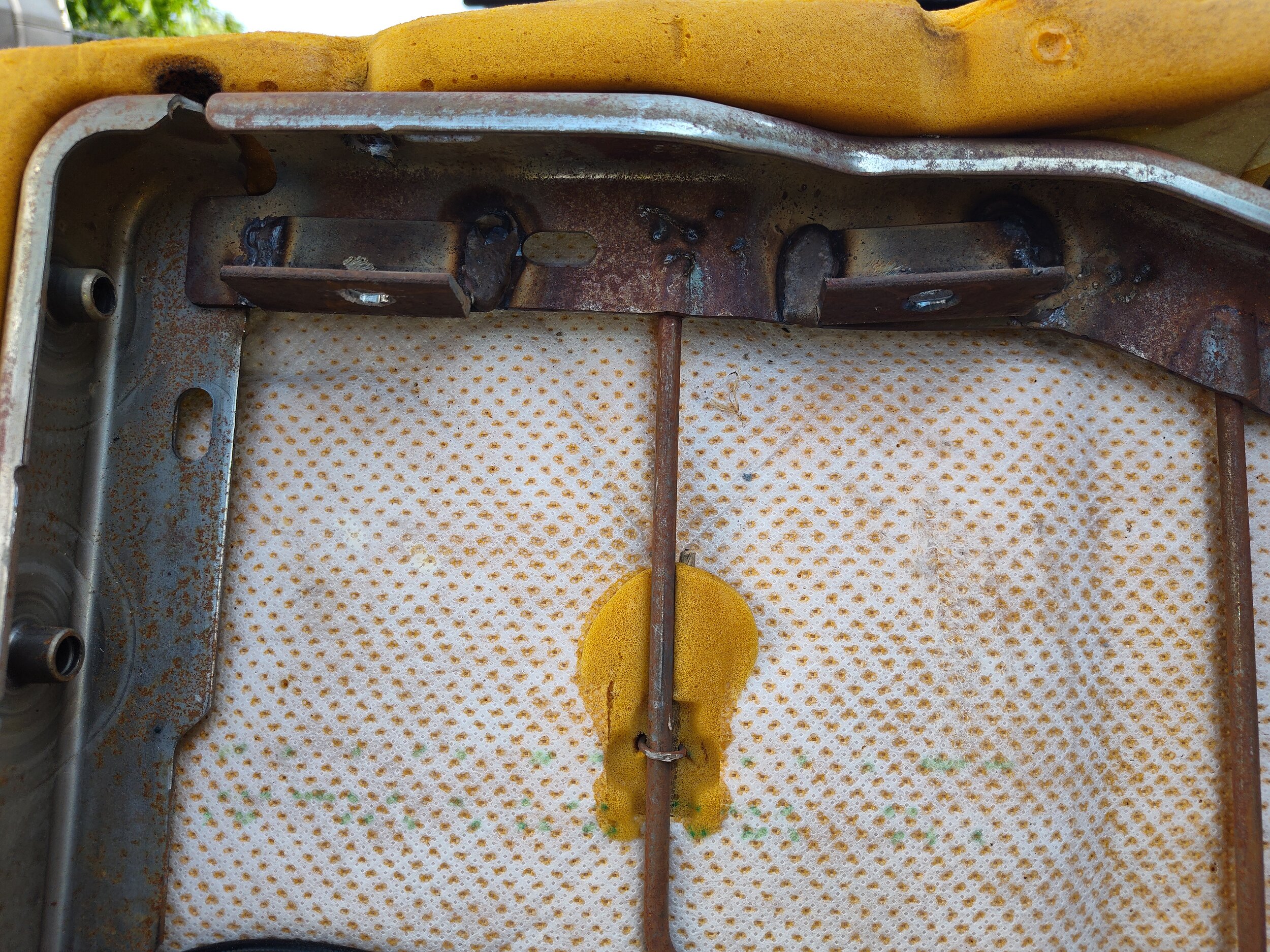

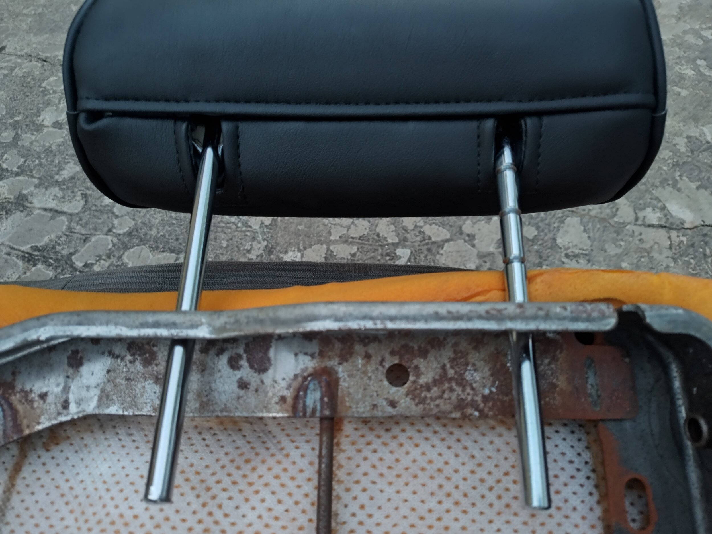

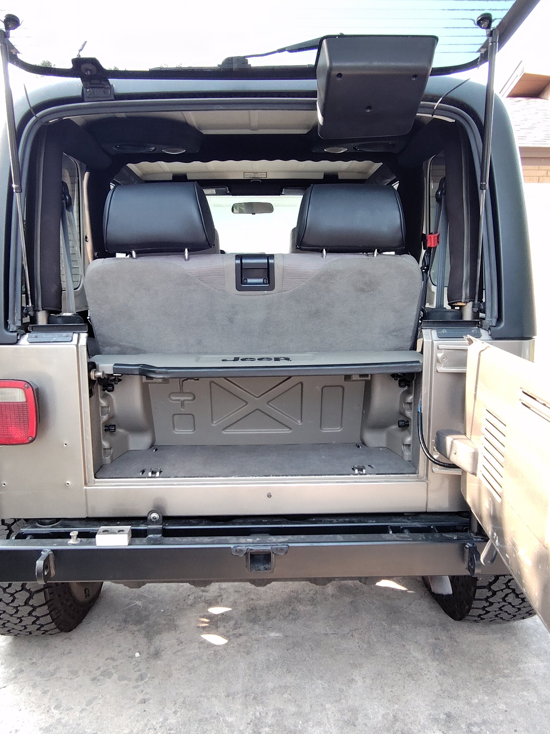

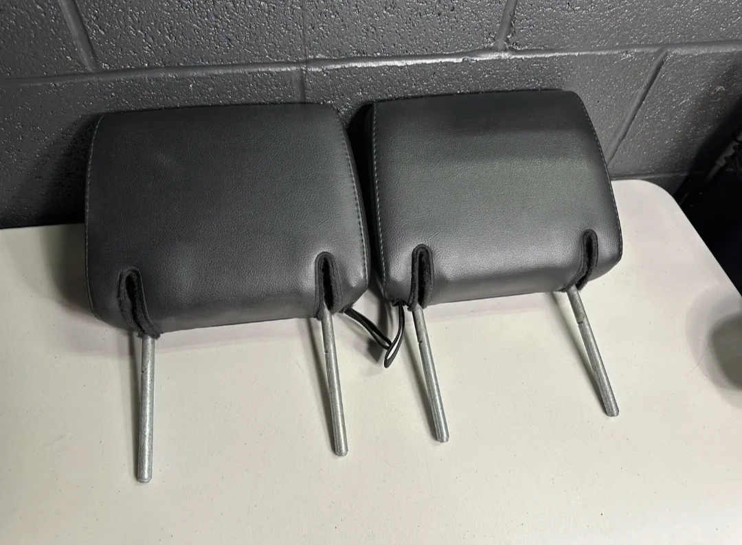

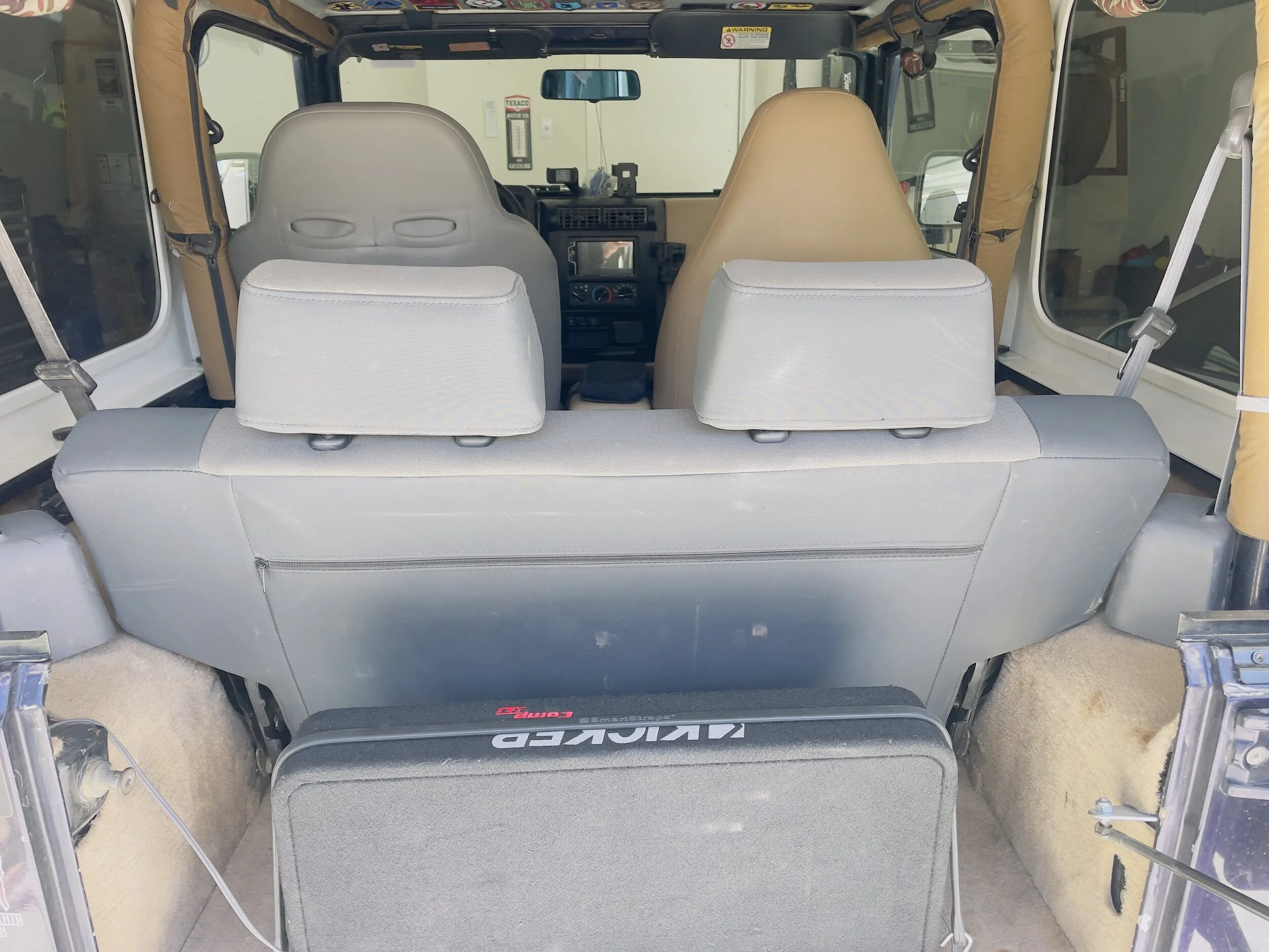

I used headrests from a Ford SUV of some type. Smaller than an explorer. Welded them in and had an upholstery guy make them look OEM. Wanted the tip forward feature so I could still tumble the seat. Didn't forget rear seat heaters while you're in there!
are you putting adults or kids in it and how much space did you loose?
that feature wasn't universal. My 97 Sahara had it, my 05 and 06 Unlimited's did not. Someone told me once that it has to do with whether there's enough room in the back for a car seat, but if that's the case then all short TJ's should have it and I don't know if that's true. My Silverado has the disable which makes sense because I don't think a rear facing infant type seat would go back there.

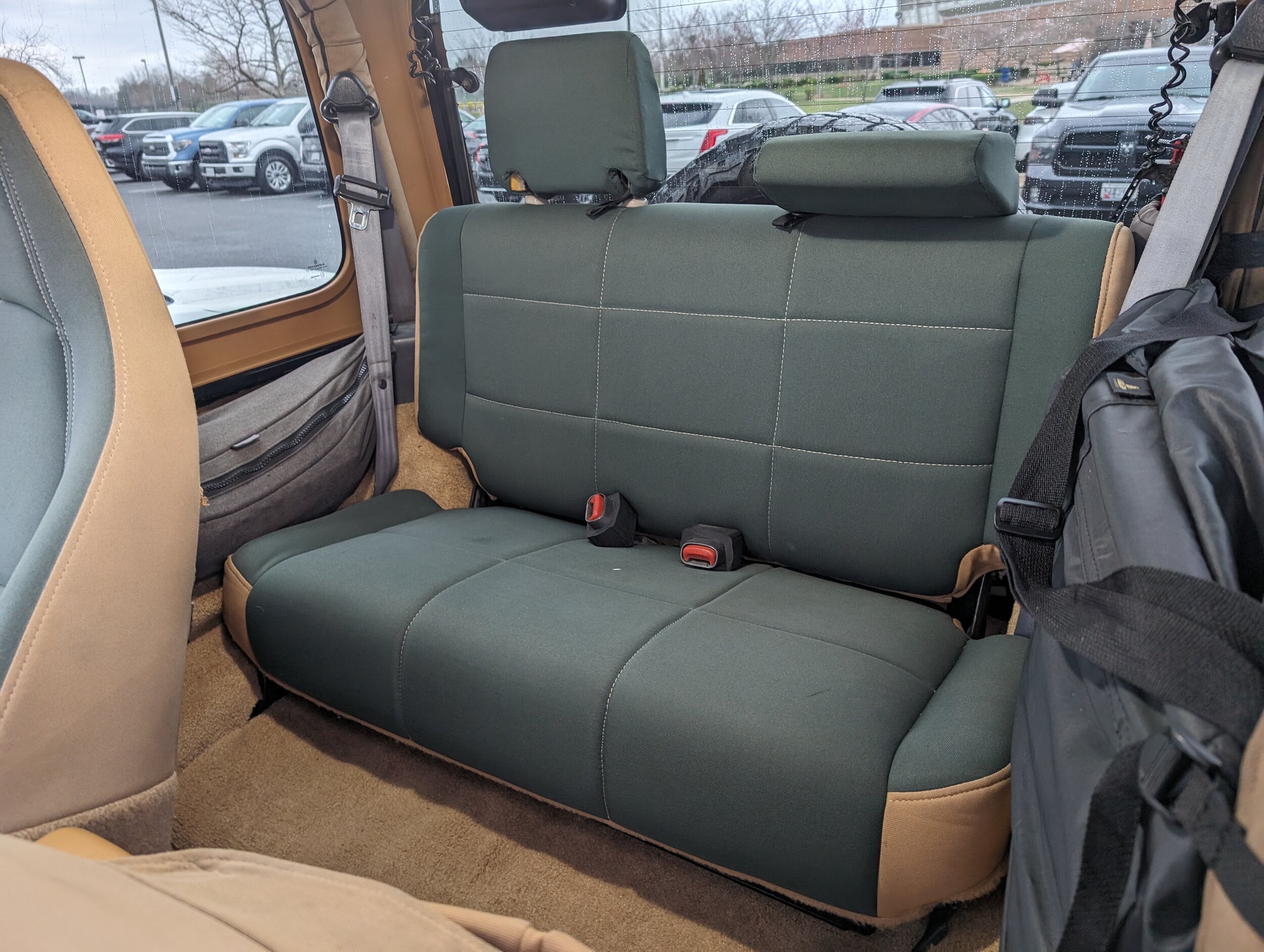

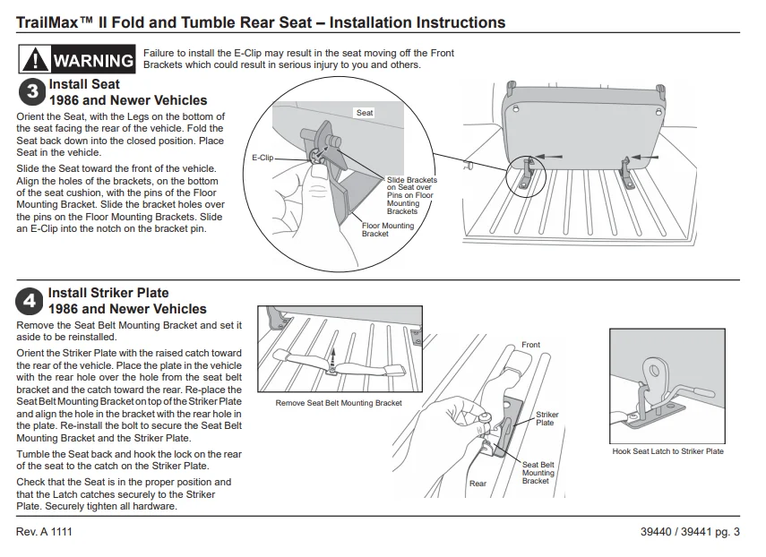

How is the quality of the Bestop seat? I'm debating on one of those or a PRP rear seat w/headrest to match my fronts.
Care to elaborate on the seat mounts? I don't fold my rear seat so the fold/tumble feature doesn't effect me. I know if I go with the PRP seat I'll have to build a custom mount.It is about as good as the OEM seats. But I am not a big fan of the latching system they used or the seat mounts. I prefer the OEM style.
Yes, it was an Escape now that you remind me of it, thanks. And for what it's worth, if you want matching upholstery (which I do) I think just having one of those Bestop seats reupholstered to match is probably the easiest way to go. I had already dropped my gas tank and modified the rear seat mounts (with totally overdone reinforcement) to move it back a couple of inches so the boys have enough room sitting behind 6'2" Daddy with his seat slid all the way back. I was determined to work with what I had. I also plan to do the in seat subwoofer mod some day.
And my '98 didn't come with the airbag switch, but I added it. It wasn't plug and play, but damn close to it.
