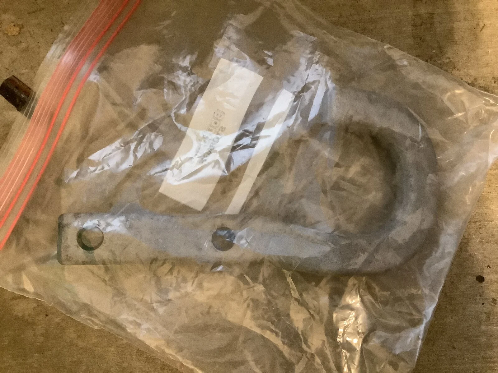

Vtx531 TJ Addict Original poster Joined Nov 17, 2020 Messages 2,034 Location Kalamazoo, MI Jun 11, 2022 #1 I recently bought an OEM rear tow hook and I am looking for someone to tell me how it is supposed to be mounted as it comes from the factory? Looks like 1/2" bolts - same as the front hooks? Thank you

Daryl 2004 Rubicon Supporting Member Joined Apr 29, 2018 Messages 3,268 Location 🌎 Jun 11, 2022 #2 The factory used one flag nut with a bolt and one bumper bolt. The bumper bolt will be longer than one that doesn’t have a hook. https://wranglertjforum.com/threads/factory-rear-tow-hook-20.8998/ Reactions: Vtx531 and JMT
