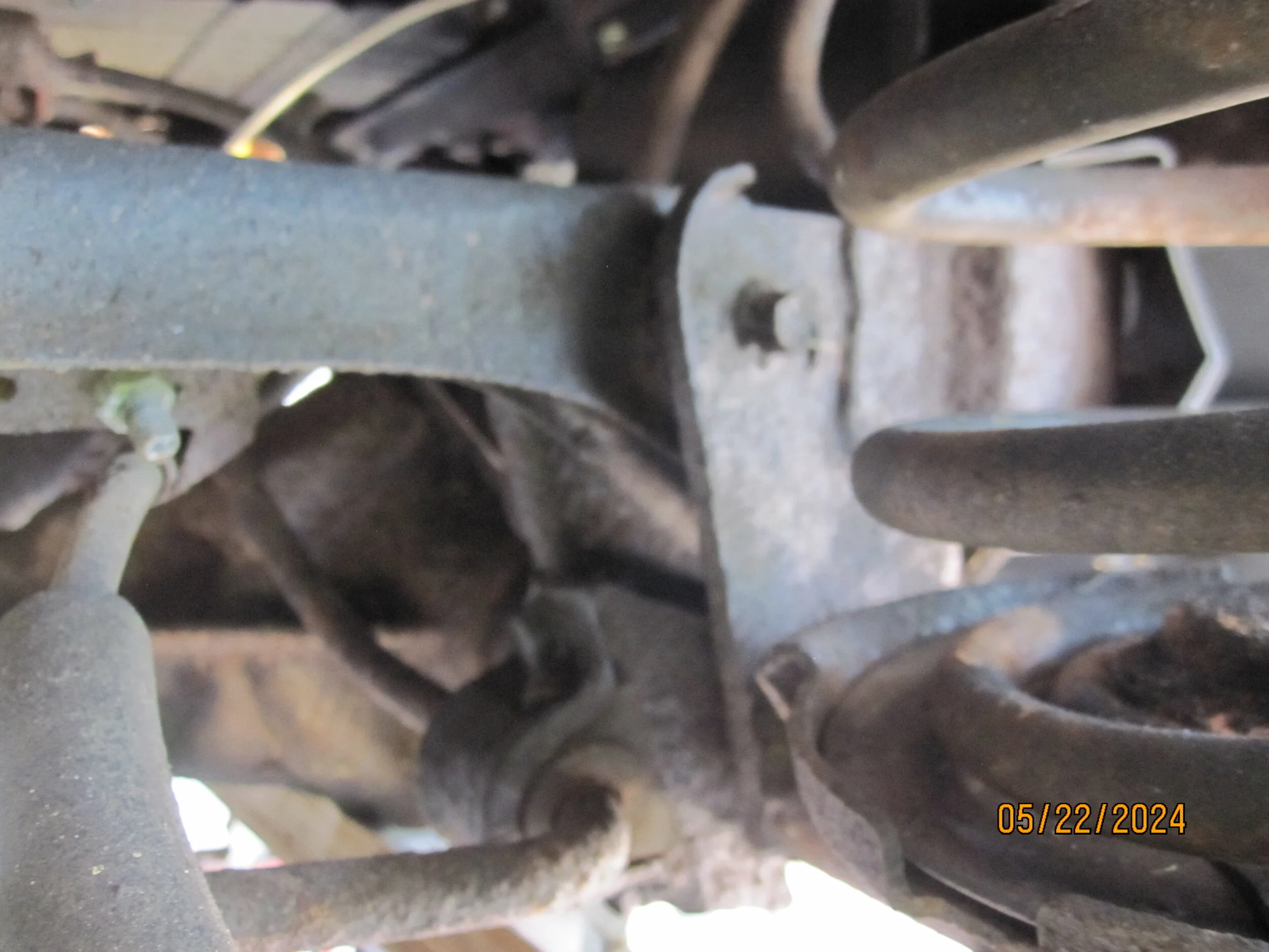

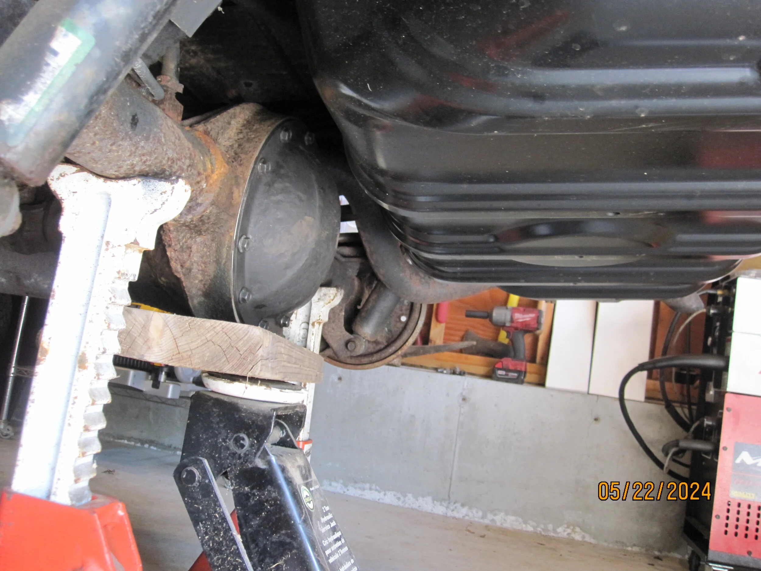

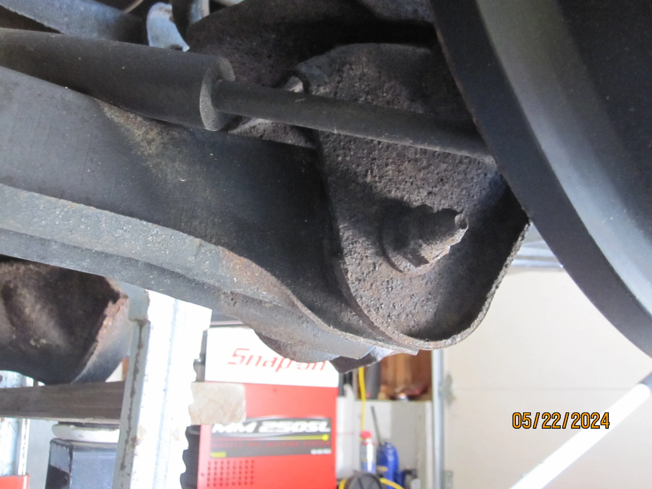

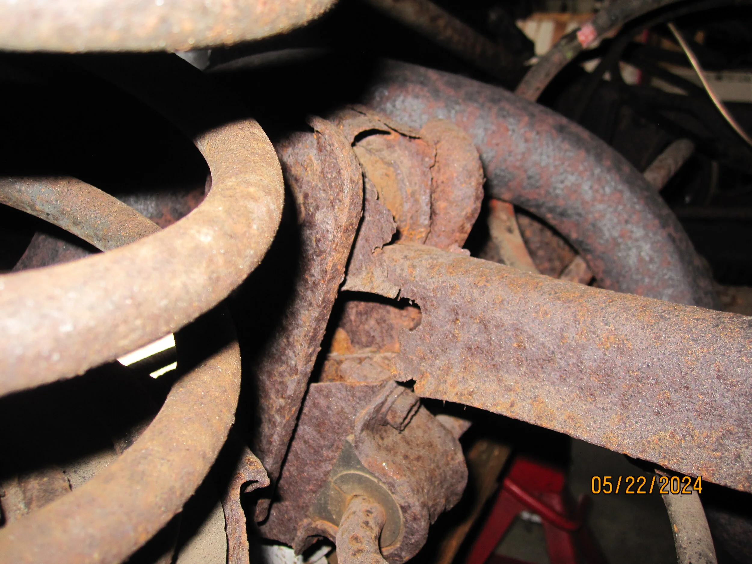

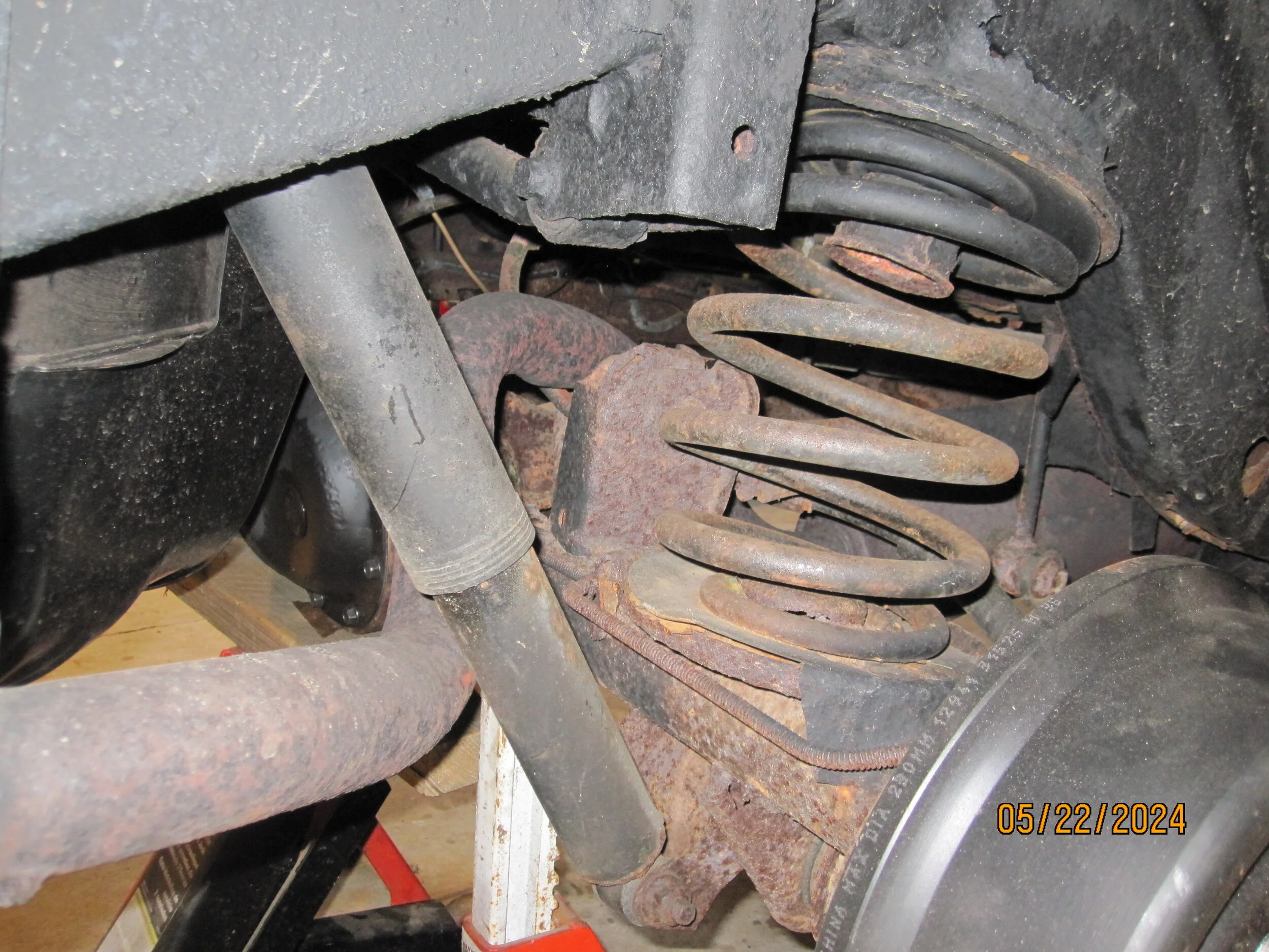

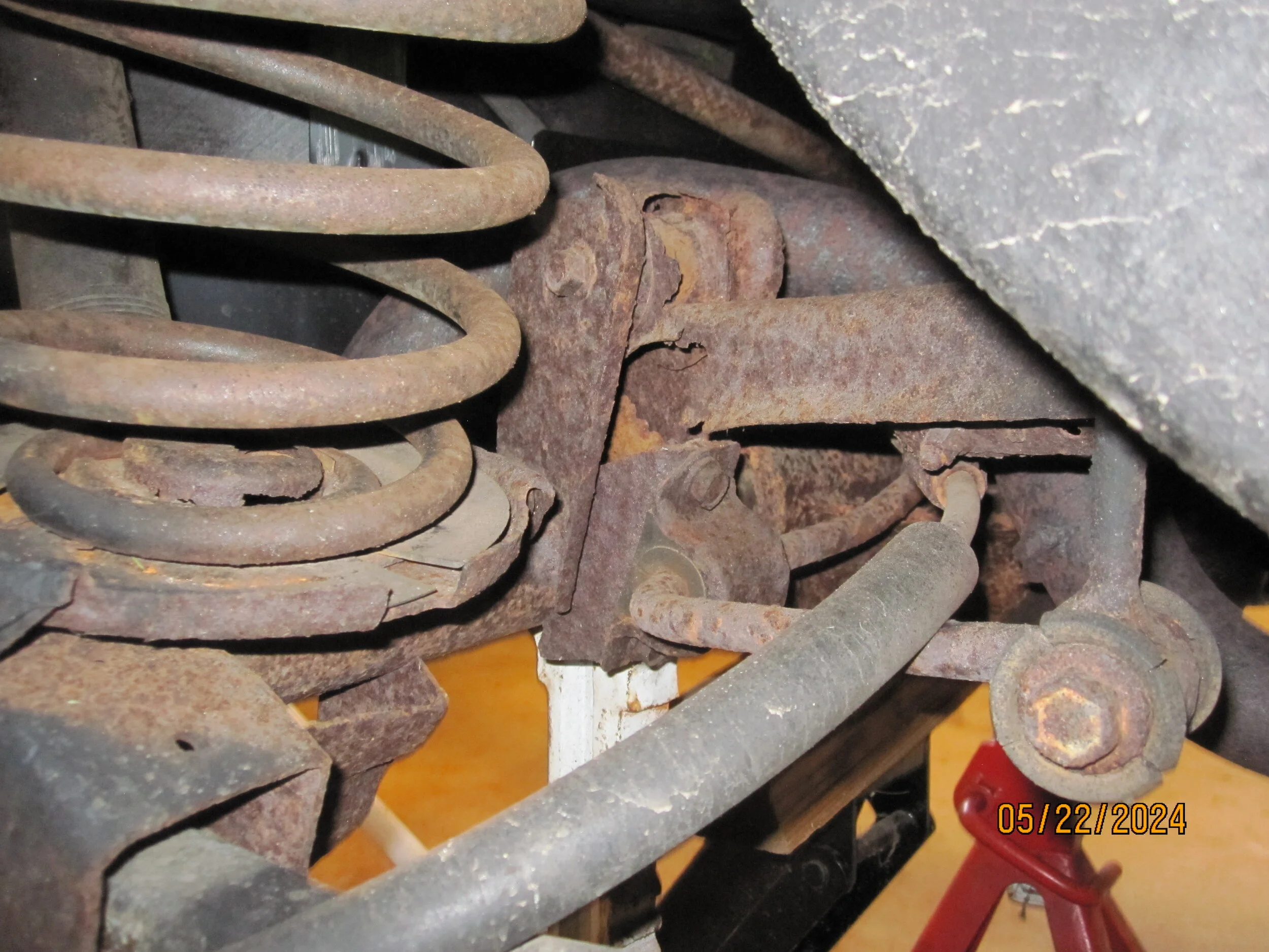

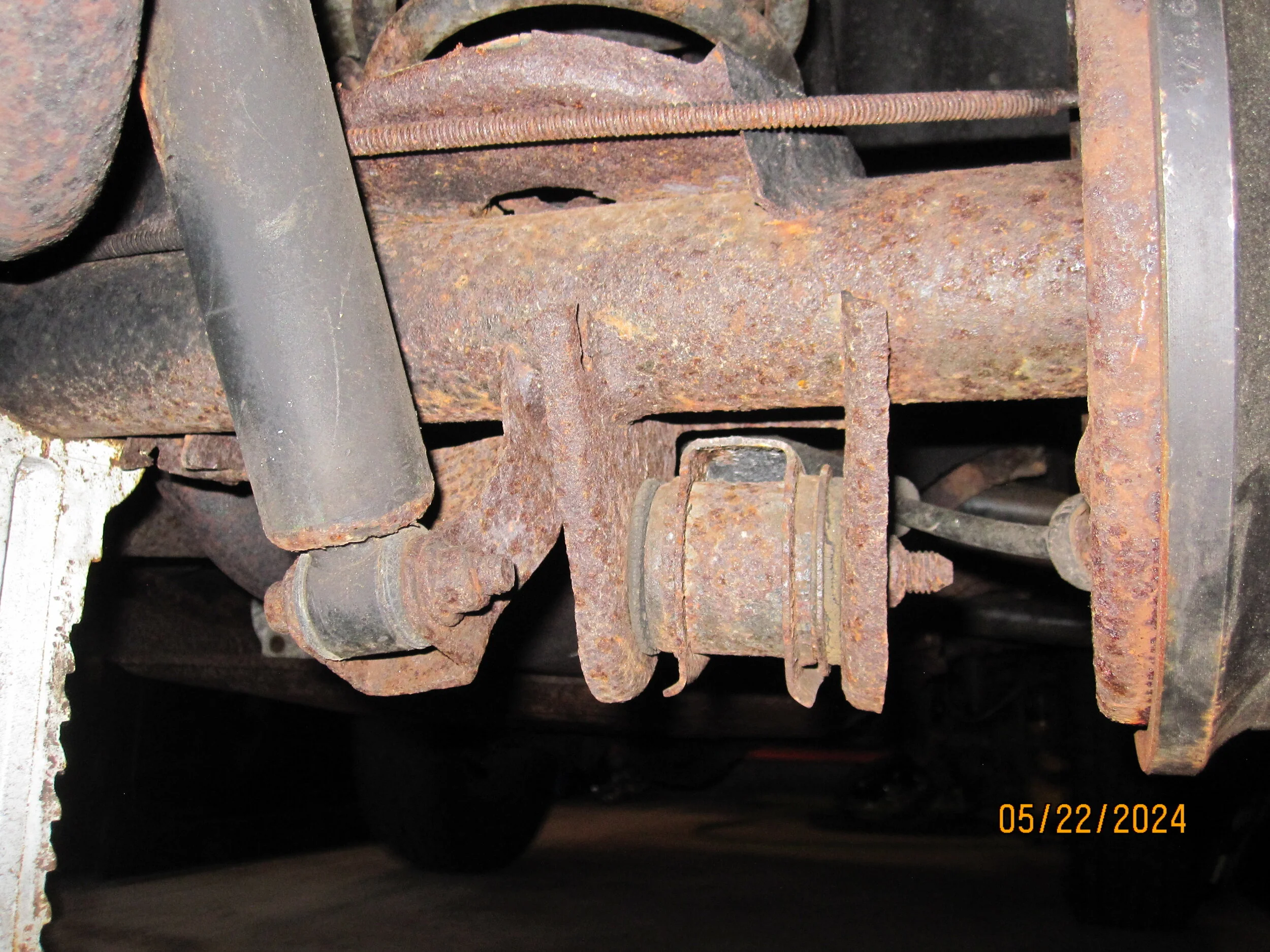

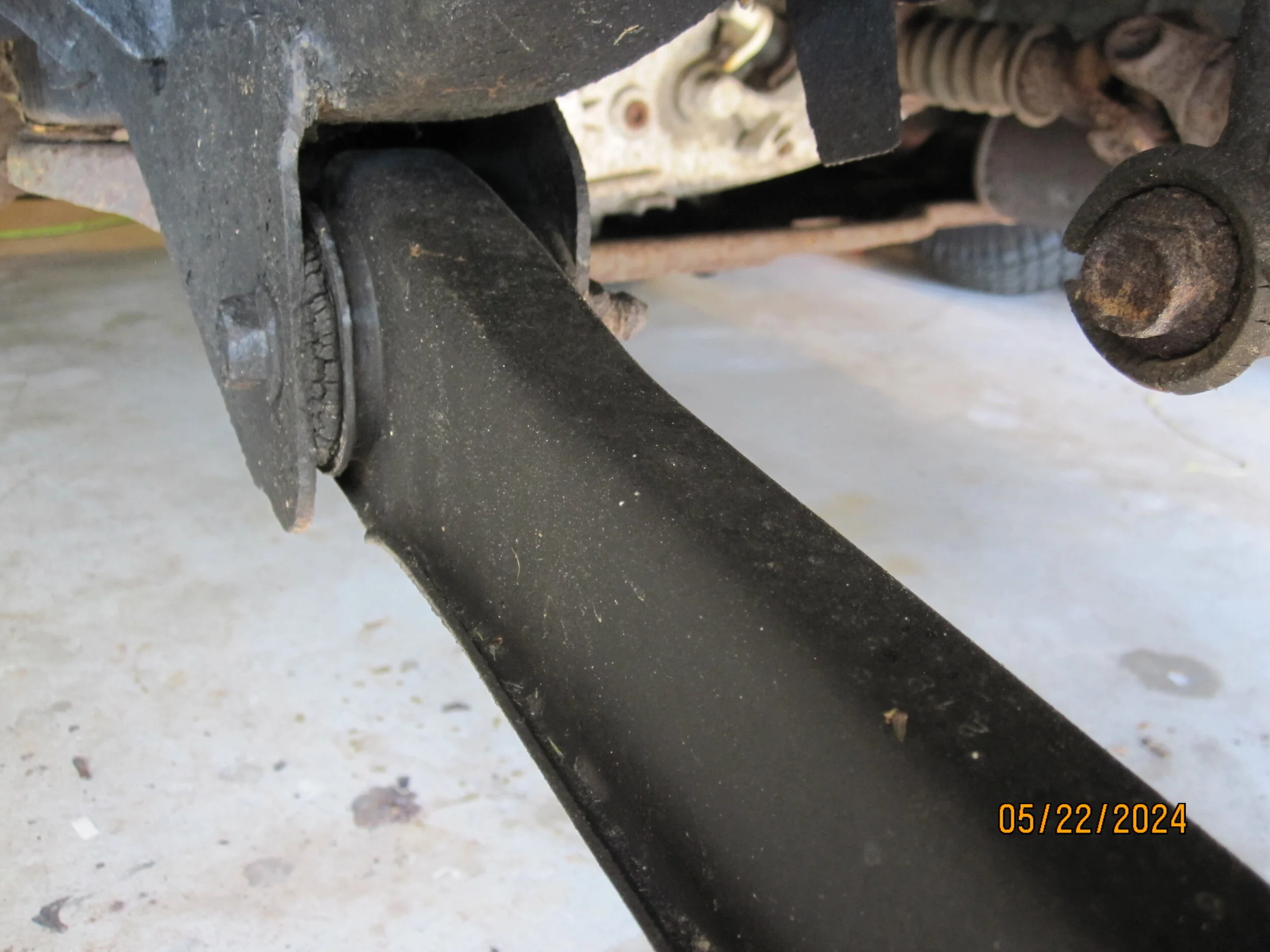

Here are some of the pics. 5th one shows the broken/rusted CA I believe
  • Wow
Reactions: lBasket
Personally I'd be pulling that axle, cleaning up all the rust, painting the living shit out of it with something like POR15.
I'd probably preemptively replace the hard brake line and soft one too.
And replace every nut and bolt I touch.
-Mac
-Mac
When summer is gone the plan is to really clean and paint/replace things. Its stupid hot here today so I didn't do to much, but i started loosening the rear shock hardware and of course the two upper bolts snapped immediately. If it cools down ill drop the tank later to make things easier going forward.
