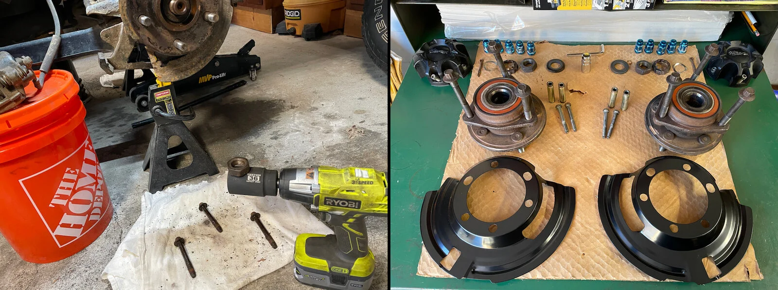

Not that your'e looking for even more parts to replace, but when i did mine i replaced both brake dust shields. The originals were in sad shape.
