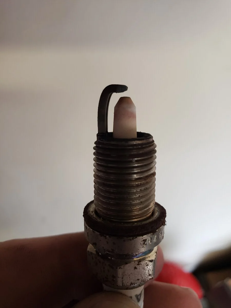

Little update here. So I went with the XP-985 plugs recommended above by Jerry. I also decided to wait on the actual coil rail until after I did the plugs to see what kind of difference just changing plugs would make.
When I started removing the plugs that were in it, they were barely tight! :oops: I almost could have removed them just using the socket and extension like a screwdriver. Pulling the first out, it was a Bosch platinum (shown below).
I am not sure how long they had been in the Jeep and they didn't look overly burnt but I was going to change them regardless. I installed the new plugs, torquing them to the required 26-30 ft.lbs and reinstalled the rail. Upon starting the Jeep, I immediately could tell by the sound that they were an improvement. Driving the jeep, I also felt what was almost like a new engine. It revved butter smooth and was 100% more responsive than before. I'm curious if I would see any additional improvement by changing the rail. With 184K miles, I believe it's more insurance than anything at this point but I could be wrong.
