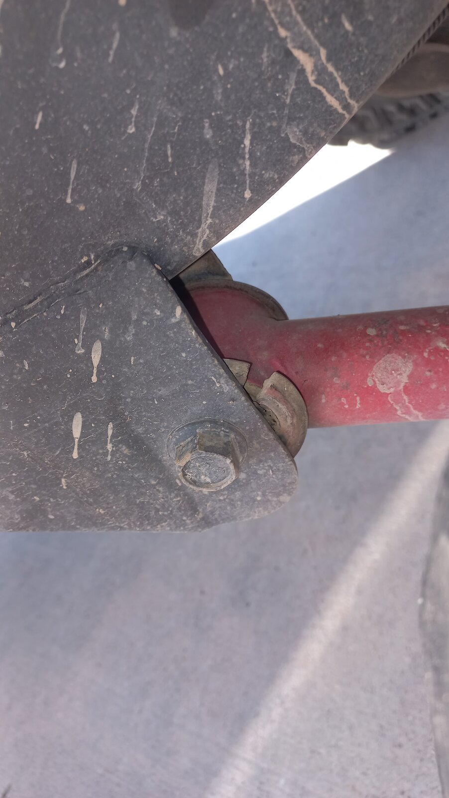

Less than a year that I replaced the bushings in this skyjacker control arms and they are already worn... Im thinking in the Tier 2 of the core 4x4 or the Rubicon Express super flex adjustable control arms.. No more than 300 per pair what would be your recommendation?
