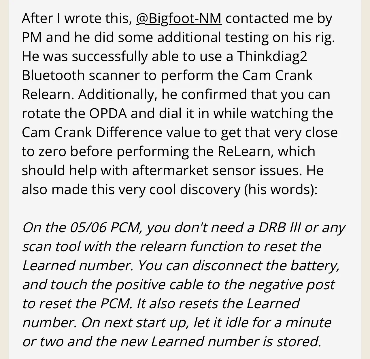

This thread should provide those answers… I used the Thinkdiag 2 device from Amazon for the cam/crank difference.
There is a relearn function as well, but the manual way using the battery ended up working for me (PCM wasn’t responding to the device or the battery method as fast as it did for others).
From page one of that thread:
