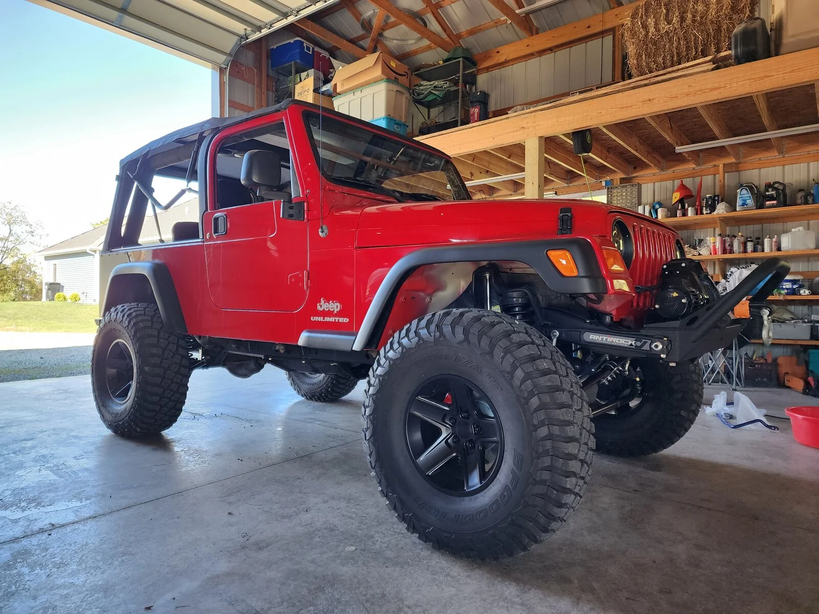

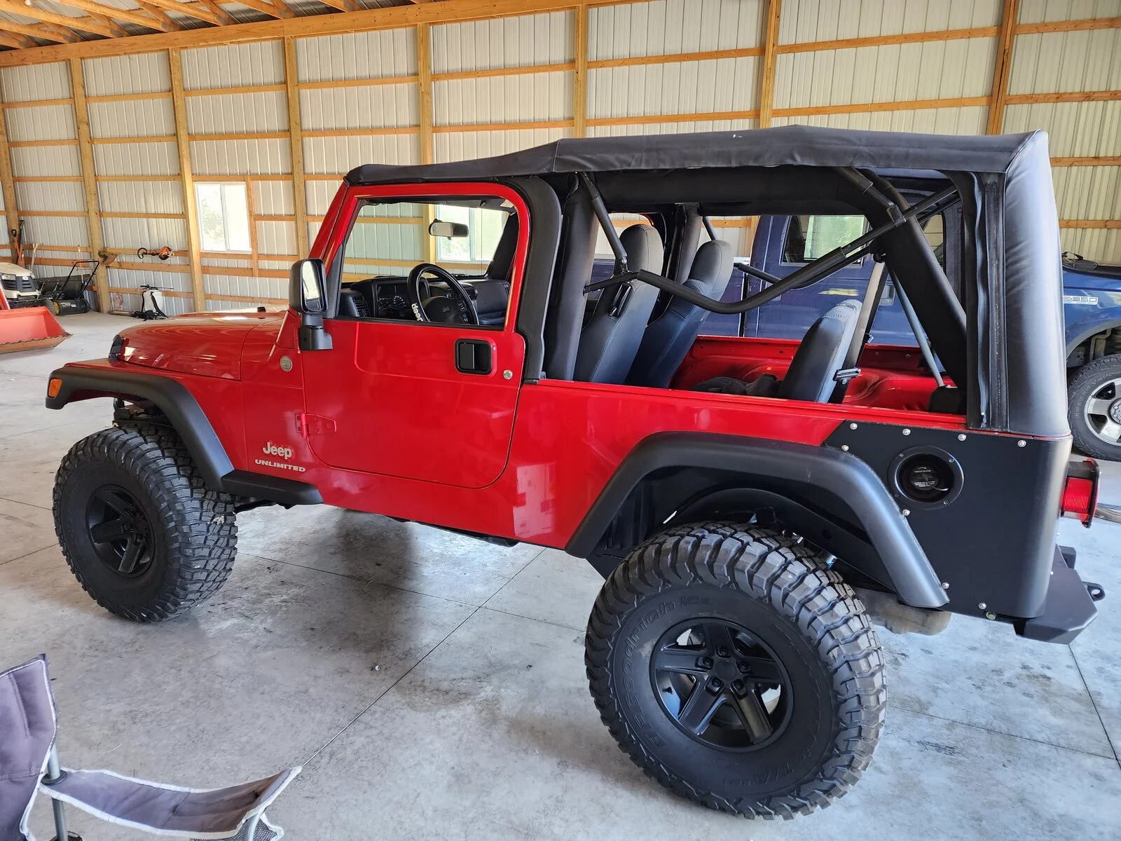

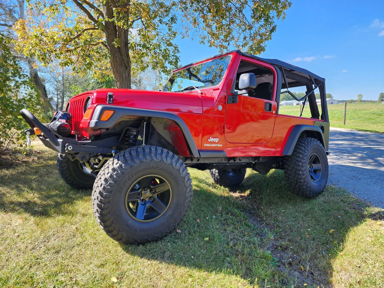

New to the forum, been lurking for a little while, but finally figured it was time to come forward. Had 4 wheelers and SxS for years but the jeep seems to suite me better, and more fun.
Picked up a 2004 LJ automotive with literally zero rust anywhere late fall. Was going to pick one up and build it up but was able to find one with a lot of great components on it. This is what it currently has.....
Currie control arms
Currie springs
Bilstein shocks
Front antirock
Advance SYE
Adams driveshafts
Cable shifter
Warn winch
35" KM3s
ARB compressor
Corner guards and bumpers
Gears and ARB lockers are going in the next couple weeks. After gears and locker I'll be adding rock sliders, hoping that savvy builds a set or two so I can acquire one, and some kind of new pan/tummy tuck.

Be careful adding gears and lockers. Assuming that is a Dana 30 in the front, you will need to upgrade the axle shafts to handle a locker and 35s.

I'm aware that I will need them and am eyeballing a set of revolutions axle shafts.
