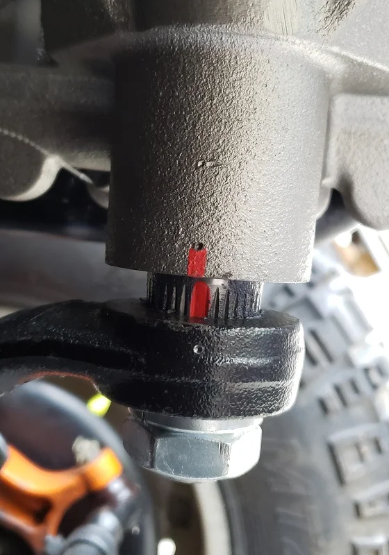

I'm sure Blaine will jump in if needed, but one of the most critical things to do is to ensure the wheels are straight and steering wheel locked in position when you take things apart. This will keep you from damaging the clock spring and set you up for using the reference markings provided by PSC on the steering box. The red marks need to be lined up to ensure the box is in the proper position for installation. I followed this and everything lined up perfectly.
Edit: I noticed Northridge has the SK250 kit 15% off now, at $1544, with free shipping. You do need to order the 16" cooler additionally though. Also, if you don't have one, you'll need a 33MM socket for the Pitman Arm nut.
